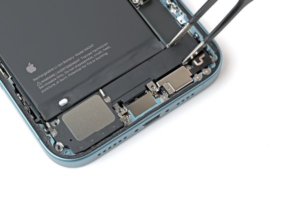

  18. iPhone 16 Plus Loudspeaker Replacement, Disconnect the battery: crwdns2935265:018crwdnd2935265:01crwdnd2935265:03crwdne2935265:0 iPhone 16 Plus Loudspeaker Replacement, Disconnect the battery: crwdns2935265:018crwdnd2935265:02crwdnd2935265:03crwdne2935265:0 iPhone 16 Plus Loudspeaker Replacement, Disconnect the battery: crwdns2935265:018crwdnd2935265:03crwdnd2935265:03crwdne2935265:0
    • Use the point of a spudger to pry up and disconnect the battery press connector.

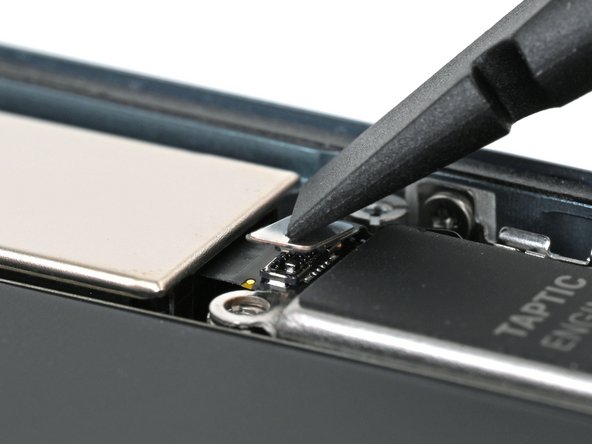

  19. iPhone 16 Plus Loudspeaker Replacement, Disconnect the wireless charger: crwdns2935265:019crwdnd2935265:01crwdnd2935265:02crwdne2935265:0 iPhone 16 Plus Loudspeaker Replacement, Disconnect the wireless charger: crwdns2935265:019crwdnd2935265:02crwdnd2935265:02crwdne2935265:0
    • Use the point of a spudger to pry up and disconnect the wireless charging coil press connector.

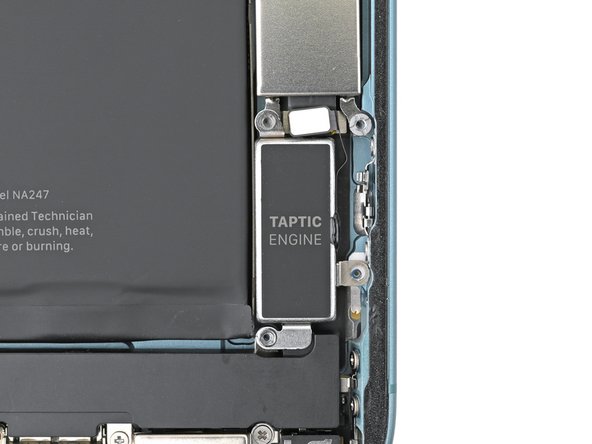

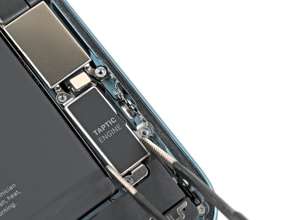

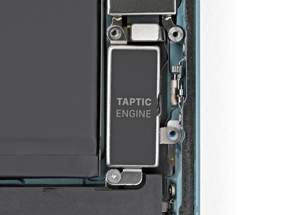

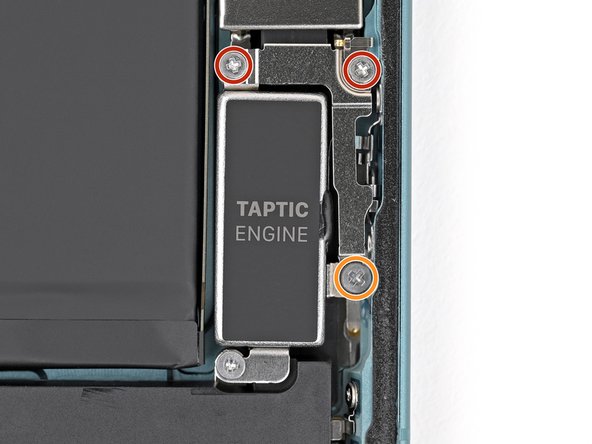

  21. iPhone 16 Plus Loudspeaker Replacement, Remove the Taptic Engine bracket screws: crwdns2935265:021crwdnd2935265:01crwdnd2935265:02crwdne2935265:0 iPhone 16 Plus Loudspeaker Replacement, Remove the Taptic Engine bracket screws: crwdns2935265:021crwdnd2935265:02crwdnd2935265:02crwdne2935265:0
    • Use a Phillips screwdriver to remove the three screws securing the Taptic Engine bracket:
    • Two 1.9 mm‑long screws
    • One 2.1 mm‑long screw

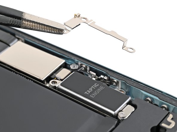

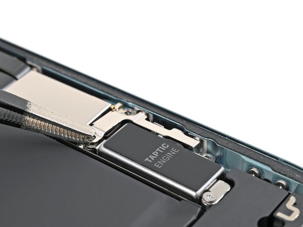

  22. iPhone 16 Plus Loudspeaker Replacement: crwdns2935265:022crwdnd2935265:01crwdnd2935265:02crwdne2935265:0 iPhone 16 Plus Loudspeaker Replacement: crwdns2935265:022crwdnd2935265:02crwdnd2935265:02crwdne2935265:0
    • Use tweezers or your fingers to remove the Taptic Engine bracket.

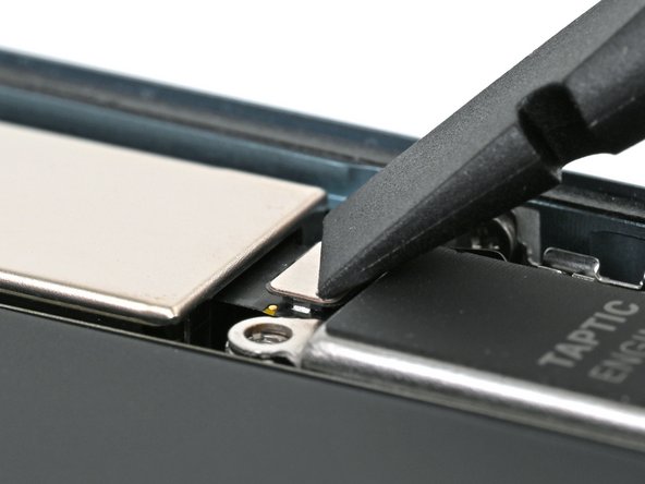

  23. iPhone 16 Plus Loudspeaker Replacement, Disconnect the Taptic Engine: crwdns2935265:023crwdnd2935265:01crwdnd2935265:02crwdne2935265:0 iPhone 16 Plus Loudspeaker Replacement, Disconnect the Taptic Engine: crwdns2935265:023crwdnd2935265:02crwdnd2935265:02crwdne2935265:0
    • Use the flat end of a spudger to pry up and disconnect the Taptic Engine press connector.

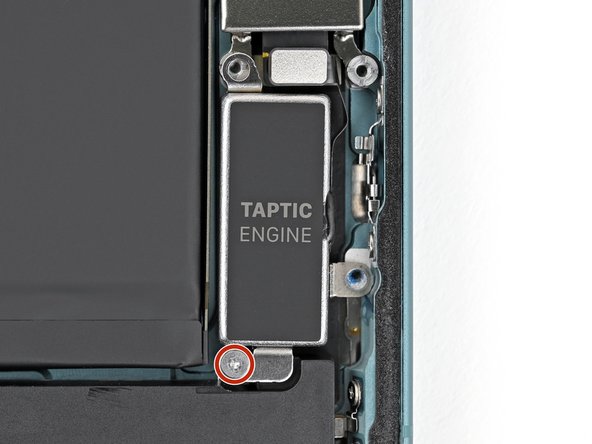

  24. iPhone 16 Plus Loudspeaker Replacement, Remove the Taptic Engine screw: crwdns2935265:024crwdnd2935265:01crwdnd2935265:02crwdne2935265:0 iPhone 16 Plus Loudspeaker Replacement, Remove the Taptic Engine screw: crwdns2935265:024crwdnd2935265:02crwdnd2935265:02crwdne2935265:0
    • Use a Phillips screwdriver to remove the 1.8 mm screw securing the Taptic Engine.

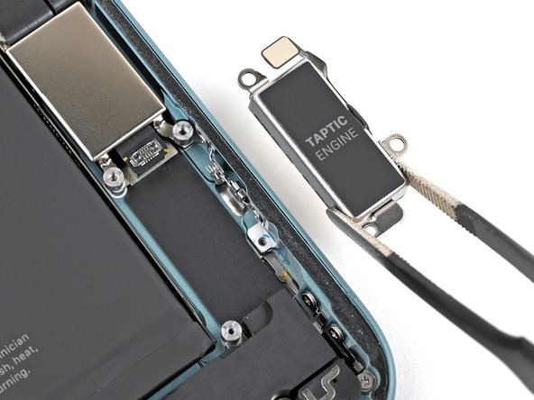

  25. iPhone 16 Plus Loudspeaker Replacement, Remove the Taptic Engine: crwdns2935265:025crwdnd2935265:01crwdnd2935265:02crwdne2935265:0 iPhone 16 Plus Loudspeaker Replacement, Remove the Taptic Engine: crwdns2935265:025crwdnd2935265:02crwdnd2935265:02crwdne2935265:0
    • Use blunt-nose tweezers or your fingers to pick up and remove the Taptic Engine.

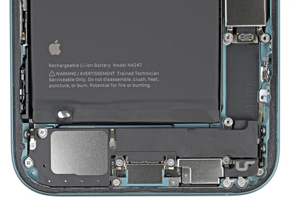

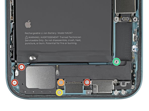

  26. iPhone 16 Plus Loudspeaker Replacement, Remove the loudspeaker screws: crwdns2935265:026crwdnd2935265:01crwdnd2935265:02crwdne2935265:0 iPhone 16 Plus Loudspeaker Replacement, Remove the loudspeaker screws: crwdns2935265:026crwdnd2935265:02crwdnd2935265:02crwdne2935265:0
    Standoff Screwdriver for iPhones
    $5.49
    • Be careful not to puncture or dent the battery with your screwdriver.
    • Use your Phillips screwdriver to remove four of the screws securing the loudspeaker:
    • Three 1.5 mm-long screws
    • One 3.0 mm-long screw
    • Use your tri-point Y000 screwdriver to remove the 1.3 mm-long screw securing a grounding contact and the loudspeaker.
    • Use your standoff screwdriver to remove the 3.4 mm-long screw securing the loudspeaker.
    • If you don't have a standoff driver, you may use a thin flathead driver—but be careful not to strip the shallow notches in the screw heads.

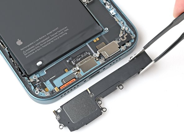

  27. iPhone 16 Plus Loudspeaker Replacement, Remove the loudspeaker: crwdns2935265:027crwdnd2935265:01crwdnd2935265:02crwdne2935265:0 iPhone 16 Plus Loudspeaker Replacement, Remove the loudspeaker: crwdns2935265:027crwdnd2935265:02crwdnd2935265:02crwdne2935265:0
    • Grab the loudspeaker and remove it.

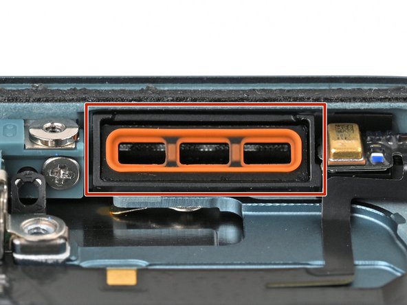

  29. iPhone 16 Plus Loudspeaker Replacement, Install the loudspeaker: crwdns2935265:029crwdnd2935265:01crwdnd2935265:03crwdne2935265:0 iPhone 16 Plus Loudspeaker Replacement, Install the loudspeaker: crwdns2935265:029crwdnd2935265:02crwdnd2935265:03crwdne2935265:0 iPhone 16 Plus Loudspeaker Replacement, Install the loudspeaker: crwdns2935265:029crwdnd2935265:03crwdnd2935265:03crwdne2935265:0
    • Make sure the orange speaker gasket is fully in its slot in the frame.
    • Align the loudspeaker with its screw posts and set it into its recess.
    • Be careful not to move the orange speaker gasket during installation.

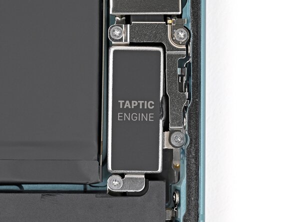

  31. iPhone 16 Plus Loudspeaker Replacement, Install the Taptic Engine: crwdns2935265:031crwdnd2935265:01crwdnd2935265:03crwdne2935265:0 iPhone 16 Plus Loudspeaker Replacement, Install the Taptic Engine: crwdns2935265:031crwdnd2935265:02crwdnd2935265:03crwdne2935265:0 iPhone 16 Plus Loudspeaker Replacement, Install the Taptic Engine: crwdns2935265:031crwdnd2935265:03crwdnd2935265:03crwdne2935265:0
    • Use blunt-nose tweezers or your fingers to align the Taptic Engine with its screw posts and place it in the frame.
  32. iPhone 16 Plus Loudspeaker Replacement, Connect the Taptic Engine: crwdns2935265:032crwdnd2935265:01crwdnd2935265:02crwdne2935265:0 iPhone 16 Plus Loudspeaker Replacement, Connect the Taptic Engine: crwdns2935265:032crwdnd2935265:02crwdnd2935265:02crwdne2935265:0
    • Use your finger or a spudger to connect the Taptic Engine press connector.
    • To re-attach press connectors like this one, carefully align and press down on one side, then the other, until it clicks into place. Don't try to force the connector into place—if you're having trouble, reposition it and try again.
  33. iPhone 16 Plus Loudspeaker Replacement, Secure the Taptic Engine: crwdns2935265:033crwdnd2935265:01crwdnd2935265:02crwdne2935265:0 iPhone 16 Plus Loudspeaker Replacement, Secure the Taptic Engine: crwdns2935265:033crwdnd2935265:02crwdnd2935265:02crwdne2935265:0
    • Use a Phillips screwdriver to install the 1.8 mm screw securing the Taptic Engine.
  34. iPhone 16 Plus Loudspeaker Replacement, Install the bracket: crwdns2935265:034crwdnd2935265:01crwdnd2935265:02crwdne2935265:0 iPhone 16 Plus Loudspeaker Replacement, Install the bracket: crwdns2935265:034crwdnd2935265:02crwdnd2935265:02crwdne2935265:0
    • Align the Taptic Engine bracket with its screw holes and set it into place.
  35. iPhone 16 Plus Loudspeaker Replacement: crwdns2935265:035crwdnd2935265:01crwdnd2935265:02crwdne2935265:0 iPhone 16 Plus Loudspeaker Replacement: crwdns2935265:035crwdnd2935265:02crwdnd2935265:02crwdne2935265:0
    • Use a Phillips screwdriver to install the three screws securing the Taptic Engine bracket:
