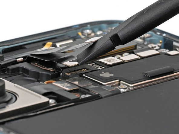

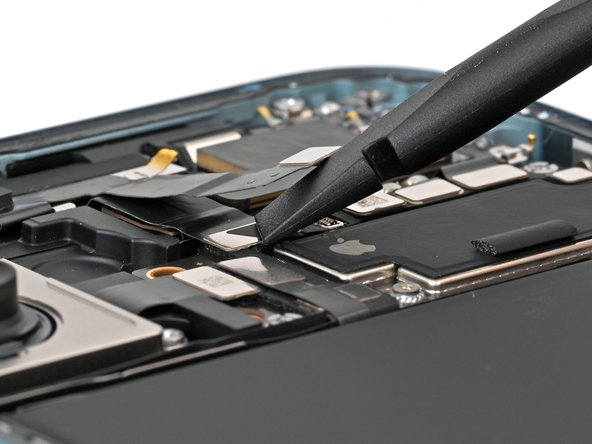

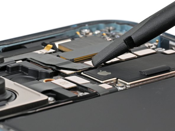

  23. iPhone 16 Plus Front Camera Assembly Replacement, Disconnect the front camera and sensors: crwdns2935265:023crwdnd2935265:01crwdnd2935265:03crwdne2935265:0 iPhone 16 Plus Front Camera Assembly Replacement, Disconnect the front camera and sensors: crwdns2935265:023crwdnd2935265:02crwdnd2935265:03crwdne2935265:0 iPhone 16 Plus Front Camera Assembly Replacement, Disconnect the front camera and sensors: crwdns2935265:023crwdnd2935265:03crwdnd2935265:03crwdne2935265:0
    • Use the point of a spudger to pry up and disconnect the two front camera press connectors, located on the top left corner of the logic board.
    • The second press connector is underneath the first.
  24. iPhone 16 Plus Front Camera Assembly Replacement, Remove the front camera assembly: crwdns2935265:024crwdnd2935265:01crwdnd2935265:02crwdne2935265:0 iPhone 16 Plus Front Camera Assembly Replacement, Remove the front camera assembly: crwdns2935265:024crwdnd2935265:02crwdnd2935265:02crwdne2935265:0
    • Pick up the front camera assembly and remove it from your phone.
