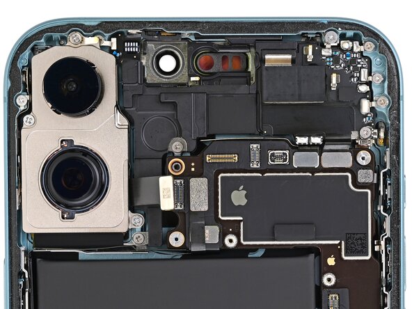

  22. iPhone 16 Plus Earpiece Speaker Replacement: crwdns2935265:022crwdnd2935265:01crwdnd2935265:02crwdne2935265:0 iPhone 16 Plus Earpiece Speaker Replacement: crwdns2935265:022crwdnd2935265:02crwdnd2935265:02crwdne2935265:0
    • Use tweezers or your fingers to remove the upper connector cover.

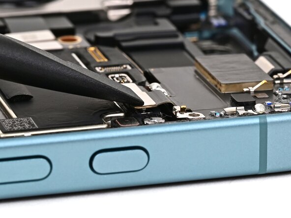

  23. iPhone 16 Plus Earpiece Speaker Replacement, Disconnect the 5G mmWave antenna: crwdns2935265:023crwdnd2935265:01crwdnd2935265:02crwdne2935265:0 iPhone 16 Plus Earpiece Speaker Replacement, Disconnect the 5G mmWave antenna: crwdns2935265:023crwdnd2935265:02crwdnd2935265:02crwdne2935265:0
    • Use the point of a spudger to pry up and disconnect the 5G mmWave antenna press connector.

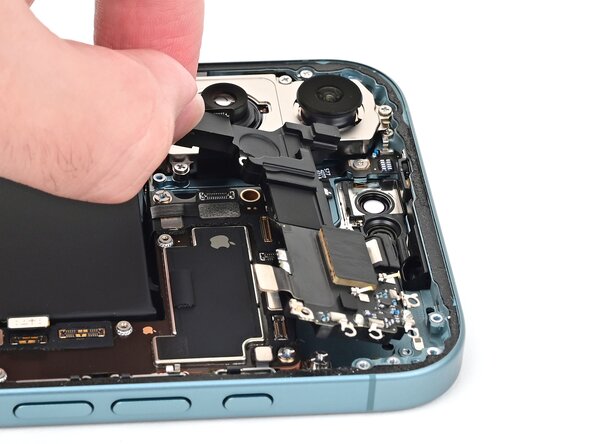

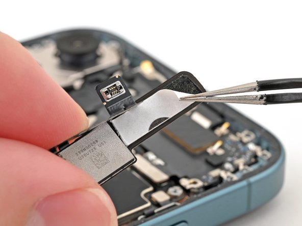

  24. iPhone 16 Plus Earpiece Speaker Replacement, Remove the stretch release adhesive: crwdns2935265:024crwdnd2935265:01crwdnd2935265:03crwdne2935265:0 iPhone 16 Plus Earpiece Speaker Replacement, Remove the stretch release adhesive: crwdns2935265:024crwdnd2935265:02crwdnd2935265:03crwdne2935265:0 iPhone 16 Plus Earpiece Speaker Replacement, Remove the stretch release adhesive: crwdns2935265:024crwdnd2935265:03crwdnd2935265:03crwdne2935265:0

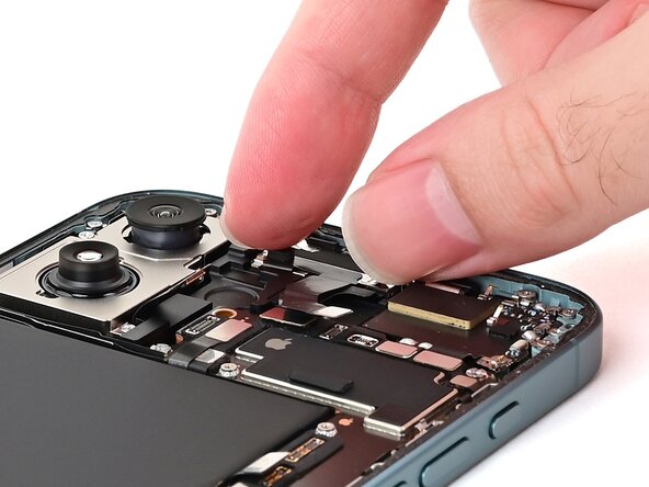

    • Use your tweezers to grab the strech-release adhesive pull-tab, located on the right edge of the 5G mmWave antenna.
    • Use your tweezers to pull the stretch‑release adhesive strip out slowly and steadily at a low angle. Give it plenty of time to stretch and un-stick from under the antenna.
    • For additional grip, you can twist the adhesive around the tip of the tweezers while you pull.
    • If the adhesive strip breaks off, try to retrieve it with your tweezers and continue pulling.

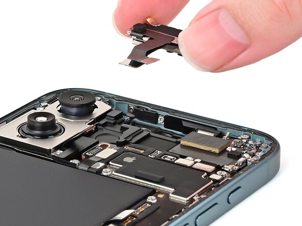

  25. iPhone 16 Plus Earpiece Speaker Replacement, Remove the antenna: crwdns2935265:025crwdnd2935265:01crwdnd2935265:02crwdne2935265:0 iPhone 16 Plus Earpiece Speaker Replacement, Remove the antenna: crwdns2935265:025crwdnd2935265:02crwdnd2935265:02crwdne2935265:0
    • Lift the 5G mmWave antenna off the earpiece speaker and remove it.

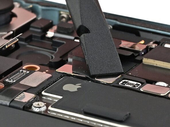

  26. iPhone 16 Plus Earpiece Speaker Replacement, Disconnect the earpiece speaker: crwdns2935265:026crwdnd2935265:01crwdnd2935265:02crwdne2935265:0 iPhone 16 Plus Earpiece Speaker Replacement, Disconnect the earpiece speaker: crwdns2935265:026crwdnd2935265:02crwdnd2935265:02crwdne2935265:0
    • Use the point of a spudger to pry up and disconnect the earpiece speaker press connector.

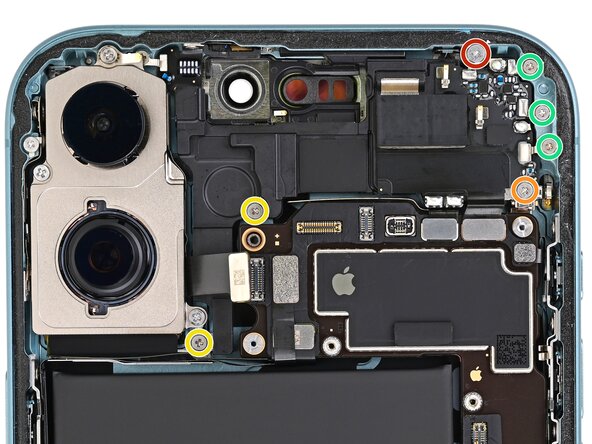

  27. iPhone 16 Plus Earpiece Speaker Replacement, Remove the earpiece speaker screws: crwdns2935265:027crwdnd2935265:01crwdnd2935265:02crwdne2935265:0 iPhone 16 Plus Earpiece Speaker Replacement, Remove the earpiece speaker screws: crwdns2935265:027crwdnd2935265:02crwdnd2935265:02crwdne2935265:0
    • Use a Phillips screwdriver to remove the seven screws securing the earpiece speaker:
    • One 2.1 mm‑long screw
    • One 2.0 mm‑long screw
    • Two 1.7 mm‑long screws
    • Three 1.35 mm‑long screws

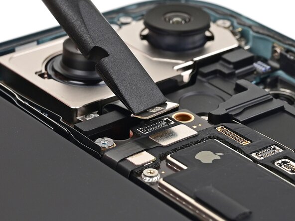

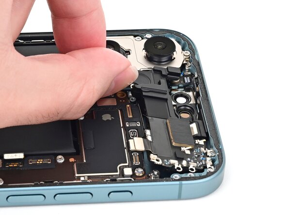

  28. iPhone 16 Plus Earpiece Speaker Replacement, Disconnect the front cameras: crwdns2935265:028crwdnd2935265:01crwdnd2935265:03crwdne2935265:0 iPhone 16 Plus Earpiece Speaker Replacement, Disconnect the front cameras: crwdns2935265:028crwdnd2935265:02crwdnd2935265:03crwdne2935265:0 iPhone 16 Plus Earpiece Speaker Replacement, Disconnect the front cameras: crwdns2935265:028crwdnd2935265:03crwdnd2935265:03crwdne2935265:0
    • Use the point of a spudger to pry up and disconnect the two front camera press connectors.
    • The second press connector is underneath the first.

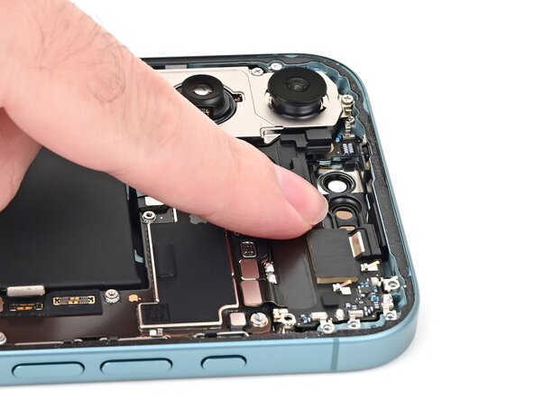

  29. iPhone 16 Plus Earpiece Speaker Replacement, Remove the front cameras: crwdns2935265:029crwdnd2935265:01crwdnd2935265:02crwdne2935265:0 iPhone 16 Plus Earpiece Speaker Replacement, Remove the front cameras: crwdns2935265:029crwdnd2935265:02crwdnd2935265:02crwdne2935265:0
    • Remove the front camera assembly.
    • Be careful not to damage the delicate spring contacts on the back of the camera assembly.

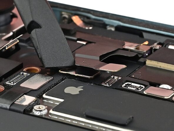

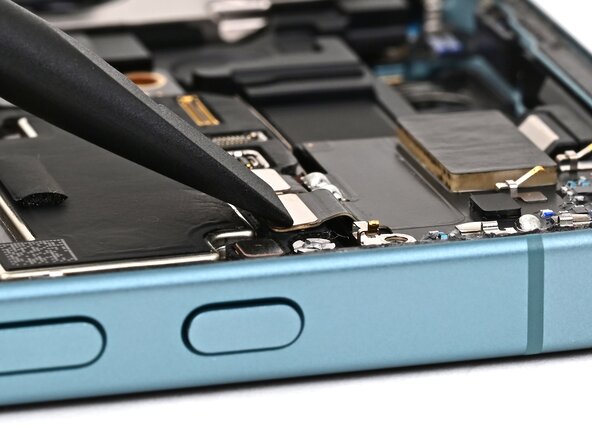

  30. iPhone 16 Plus Earpiece Speaker Replacement, Disconnect the rear camera: crwdns2935265:030crwdnd2935265:01crwdnd2935265:02crwdne2935265:0 iPhone 16 Plus Earpiece Speaker Replacement, Disconnect the rear camera: crwdns2935265:030crwdnd2935265:02crwdnd2935265:02crwdne2935265:0

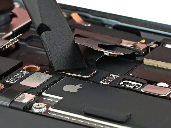

  31. iPhone 16 Plus Earpiece Speaker Replacement, Remove the earpiece speaker: crwdns2935265:031crwdnd2935265:01crwdnd2935265:03crwdne2935265:0 iPhone 16 Plus Earpiece Speaker Replacement, Remove the earpiece speaker: crwdns2935265:031crwdnd2935265:02crwdnd2935265:03crwdne2935265:0 iPhone 16 Plus Earpiece Speaker Replacement, Remove the earpiece speaker: crwdns2935265:031crwdnd2935265:03crwdnd2935265:03crwdne2935265:0
    • Insert the flat end of a spudger under the top edge of the earpiece speaker, near the front camera cutout.
    • Pry up the earpiece speaker to separate it from its square cutout in the top edge of the frame.
    • Remove the earpiece speaker.

    • Connect the antenna press connector, and press the antenna onto the earpiece speaker to adhere it.
  41. iPhone 16 Plus Earpiece Speaker Replacement, Install the upper connector cover: crwdns2935265:041crwdnd2935265:01crwdnd2935265:02crwdne2935265:0 iPhone 16 Plus Earpiece Speaker Replacement, Install the upper connector cover: crwdns2935265:041crwdnd2935265:02crwdnd2935265:02crwdne2935265:0
    • Use tweezers or your fingers to align the upper connector cover with its screw holes and set it in place.
  42. iPhone 16 Plus Earpiece Speaker Replacement: crwdns2935265:042crwdnd2935265:01crwdnd2935265:02crwdne2935265:0 iPhone 16 Plus Earpiece Speaker Replacement: crwdns2935265:042crwdnd2935265:02crwdnd2935265:02crwdne2935265:0
    • Install the four screws securing the upper connector cover:
    • Two 1.4 mm‑long Phillips screws
    • One 3.5 mm‑long Phillips screw
    • One 1.0 mm‑long tri-point Y000 screw
