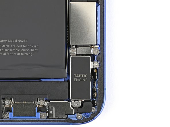

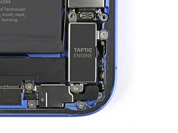

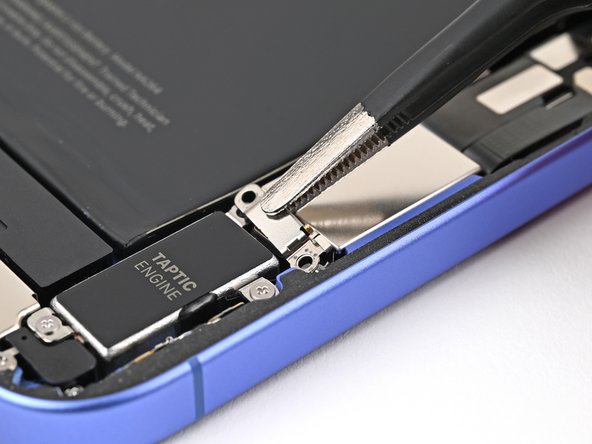

  20. iPhone 16 Microphone Replacement, Remove the Taptic Engine bracket screws: crwdns2935265:020crwdnd2935265:01crwdnd2935265:02crwdne2935265:0 iPhone 16 Microphone Replacement, Remove the Taptic Engine bracket screws: crwdns2935265:020crwdnd2935265:02crwdnd2935265:02crwdne2935265:0
    • Use a Phillips screwdriver to remove the two 1.8 mm‑long screws securing the Taptic Engine bracket.
  21. iPhone 16 Microphone Replacement, Remove the bracket: crwdns2935265:021crwdnd2935265:01crwdnd2935265:02crwdne2935265:0 iPhone 16 Microphone Replacement, Remove the bracket: crwdns2935265:021crwdnd2935265:02crwdnd2935265:02crwdne2935265:0
    • Use tweezers, or your fingers, to remove the Taptic Engine bracket.

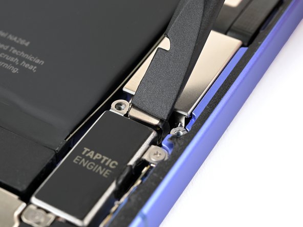

  24. iPhone 16 Microphone Replacement, Remove the Taptic Engine: crwdns2935265:024crwdnd2935265:01crwdnd2935265:03crwdne2935265:0 iPhone 16 Microphone Replacement, Remove the Taptic Engine: crwdns2935265:024crwdnd2935265:02crwdnd2935265:03crwdne2935265:0 iPhone 16 Microphone Replacement, Remove the Taptic Engine: crwdns2935265:024crwdnd2935265:03crwdnd2935265:03crwdne2935265:0
    • Use the point of a spudger to lift the Taptic Engine out of the frame.
    • Remove the Taptic Engine.

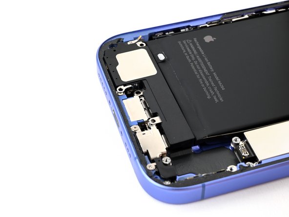

  25. iPhone 16 Microphone Replacement, Remove the loudspeaker screws: crwdns2935265:025crwdnd2935265:01crwdnd2935265:02crwdne2935265:0 iPhone 16 Microphone Replacement, Remove the loudspeaker screws: crwdns2935265:025crwdnd2935265:02crwdnd2935265:02crwdne2935265:0
    • Remove the five screws securing the loudspeaker:
    • Two 1.5 mm‑long Phillips screws
    • One 2.0 mm‑long Phillips screw
    • One 2.9 mm‑long Phillips screw
    • One 1.2 mm‑long tri‑point Y000 screw

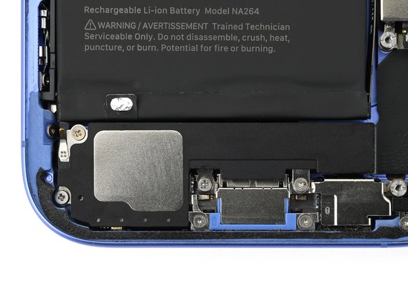

  26. iPhone 16 Microphone Replacement, Remove the loudspeaker: crwdns2935265:026crwdnd2935265:01crwdnd2935265:03crwdne2935265:0 iPhone 16 Microphone Replacement, Remove the loudspeaker: crwdns2935265:026crwdnd2935265:02crwdnd2935265:03crwdne2935265:0 iPhone 16 Microphone Replacement, Remove the loudspeaker: crwdns2935265:026crwdnd2935265:03crwdnd2935265:03crwdne2935265:0
    • Use the point of a spudger to lift the loudspeaker out of the frame.
    • Remove the loudspeaker.

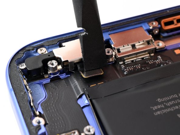

  27. iPhone 16 Microphone Replacement, Disconnect the microphone: crwdns2935265:027crwdnd2935265:01crwdnd2935265:02crwdne2935265:0 iPhone 16 Microphone Replacement, Disconnect the microphone: crwdns2935265:027crwdnd2935265:02crwdnd2935265:02crwdne2935265:0
    • Use the tip of a spudger to disconnect the microphone press connector.

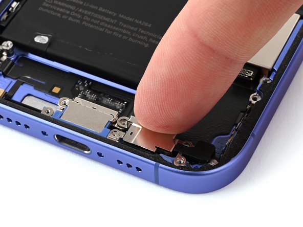

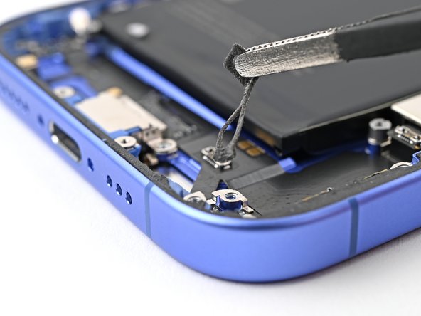

  32. iPhone 16 Microphone Replacement, Remove the old adhesive: crwdns2935265:032crwdnd2935265:01crwdnd2935265:02crwdne2935265:0 iPhone 16 Microphone Replacement, Remove the old adhesive: crwdns2935265:032crwdnd2935265:02crwdnd2935265:02crwdne2935265:0
    • Use tweezers or your fingers to remove the old adhesive from the bottom of the frame.
  33. iPhone 16 Microphone Replacement, Clean the microphone opening: crwdns2935265:033crwdnd2935265:01crwdnd2935265:01crwdne2935265:0
    • Use high concentration isopropyl alcohol (greater than 90%) and a microfiber or lint-free cloth to clean the adhesive residue off the microphone opening in the frame.

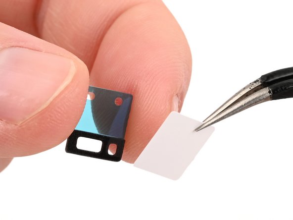

  34. iPhone 16 Microphone Replacement, Remove the white liner: crwdns2935265:034crwdnd2935265:01crwdnd2935265:02crwdne2935265:0 iPhone 16 Microphone Replacement, Remove the white liner: crwdns2935265:034crwdnd2935265:02crwdnd2935265:02crwdne2935265:0
    • If your microphone comes with adhesive installed, skip this step.
    • While holding the microphone adhesive with one hand, use your fingers or a pair of tweezers to remove the white liner from the adhesive.

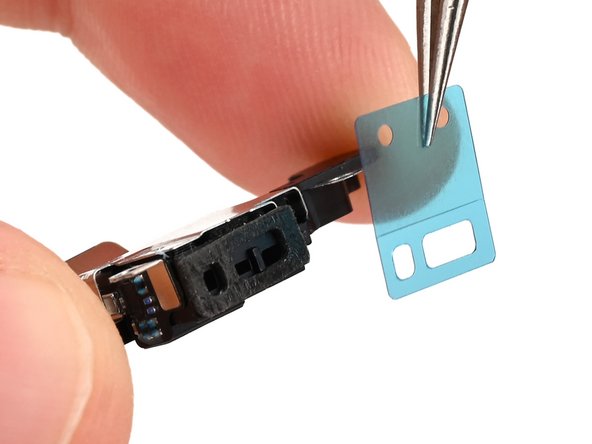

  35. iPhone 16 Microphone Replacement, Apply the adhesive to the microphone: crwdns2935265:035crwdnd2935265:01crwdnd2935265:03crwdne2935265:0 iPhone 16 Microphone Replacement, Apply the adhesive to the microphone: crwdns2935265:035crwdnd2935265:02crwdnd2935265:03crwdne2935265:0 iPhone 16 Microphone Replacement, Apply the adhesive to the microphone: crwdns2935265:035crwdnd2935265:03crwdnd2935265:03crwdne2935265:0
    • Hold the microphone so the metal side is facing up.
    • Apply the adhesive to the microphone with the pull tab pointing up.
  36. iPhone 16 Microphone Replacement: crwdns2935265:036crwdnd2935265:01crwdnd2935265:02crwdne2935265:0 iPhone 16 Microphone Replacement: crwdns2935265:036crwdnd2935265:02crwdnd2935265:02crwdne2935265:0
    • Remove the blue liner from the microphone adhesive.

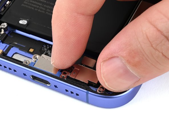

  37. iPhone 16 Microphone Replacement, Install the microphone: crwdns2935265:037crwdnd2935265:01crwdnd2935265:03crwdne2935265:0 iPhone 16 Microphone Replacement, Install the microphone: crwdns2935265:037crwdnd2935265:02crwdnd2935265:03crwdne2935265:0 iPhone 16 Microphone Replacement, Install the microphone: crwdns2935265:037crwdnd2935265:03crwdnd2935265:03crwdne2935265:0
    • Insert the microphone at a downward angle so the adhesive adheres firmly to the frame around the opening.
    • Press the microphone firmly into place.

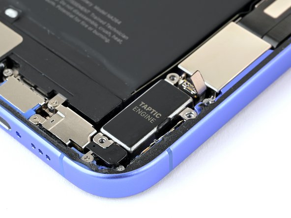

  42. iPhone 16 Microphone Replacement, Place the Taptic Engine: crwdns2935265:042crwdnd2935265:01crwdnd2935265:02crwdne2935265:0 iPhone 16 Microphone Replacement, Place the Taptic Engine: crwdns2935265:042crwdnd2935265:02crwdnd2935265:02crwdne2935265:0
    • Place the Taptic Engine into its recess in the frame.
  43. iPhone 16 Microphone Replacement, Install the Taptic Engine screws: crwdns2935265:043crwdnd2935265:01crwdnd2935265:02crwdne2935265:0 iPhone 16 Microphone Replacement, Install the Taptic Engine screws: crwdns2935265:043crwdnd2935265:02crwdnd2935265:02crwdne2935265:0
    • Use a Phillips screwdriver to install the two screws securing the Taptic Engine:
    • One 2.2 mm‑long screw
    • One 1.7 mm‑long screw

    • Use tweezers or your fingers to place the bracket over the Taptic Engine press connector.
  46. iPhone 16 Microphone Replacement: crwdns2935265:046crwdnd2935265:01crwdnd2935265:02crwdne2935265:0 iPhone 16 Microphone Replacement: crwdns2935265:046crwdnd2935265:02crwdnd2935265:02crwdne2935265:0
    • Use a Phillips screwdriver to install the two 1.8 mm‑long screws securing the Taptic Engine bracket.
  47. iPhone 16 Microphone Replacement, Remove the back glass adhesive: crwdns2935265:047crwdnd2935265:01crwdnd2935265:03crwdne2935265:0 iPhone 16 Microphone Replacement, Remove the back glass adhesive: crwdns2935265:047crwdnd2935265:02crwdnd2935265:03crwdne2935265:0 iPhone 16 Microphone Replacement, Remove the back glass adhesive: crwdns2935265:047crwdnd2935265:03crwdnd2935265:03crwdne2935265:0
    • Be careful not to damage any of the spring contacts as you clean the frame.
    • This is a good point to test your repair before sealing up your phone. Connect the battery and back glass, power on your phone, and make sure it works as expected. Power it back down, disconnect the battery and back glass, and continue reassembly.
    • The adhesive remaining on your phone is difficult to remove and leaves residue. If you have trouble removing the adhesive, apply some heat using a hair dryer or heat gun.
    • Use the pointed end of a spudger to press and roll the adhesive until you can grip it with a pair of tweezers.
  48. iPhone 16 Microphone Replacement: crwdns2935265:048crwdnd2935265:01crwdnd2935265:02crwdne2935265:0 iPhone 16 Microphone Replacement: crwdns2935265:048crwdnd2935265:02crwdnd2935265:02crwdne2935265:0
    • Use the tweezers to pull the adhesive off of the phone.
    • Repeat the previous step and this step until all of the adhesive is removed.
