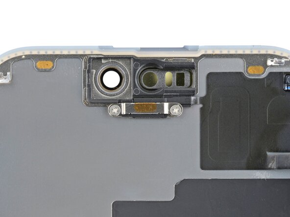

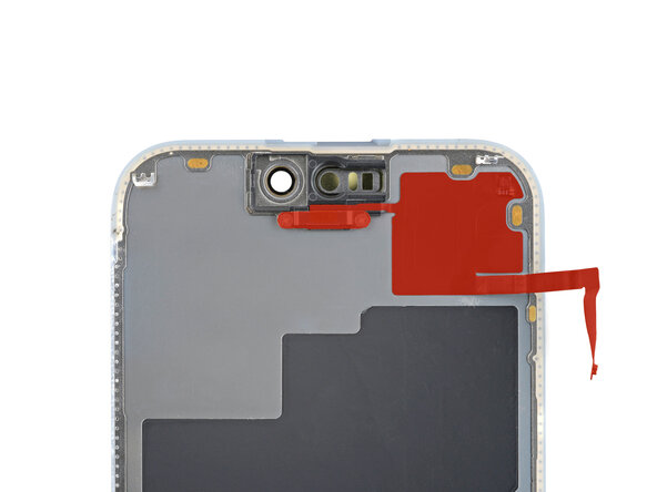

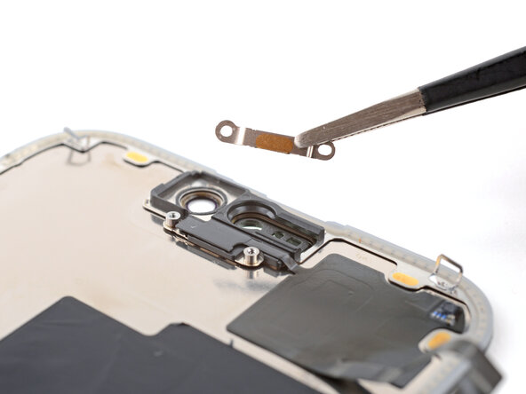

    1. iPhone 15 Pro Screen Replacement, Ambient light sensor information: crwdns2935265:025crwdnd2935265:01crwdnd2935265:02crwdne2935265:0 iPhone 15 Pro Screen Replacement, Ambient light sensor information: crwdns2935265:025crwdnd2935265:02crwdnd2935265:02crwdne2935265:0
      • Check if your new screen comes with an ambient light sensor installed.
      • If it doesn't, follow the remaining steps to remove and transfer the sensor from your original screen to your replacement.

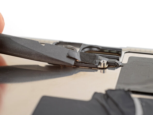

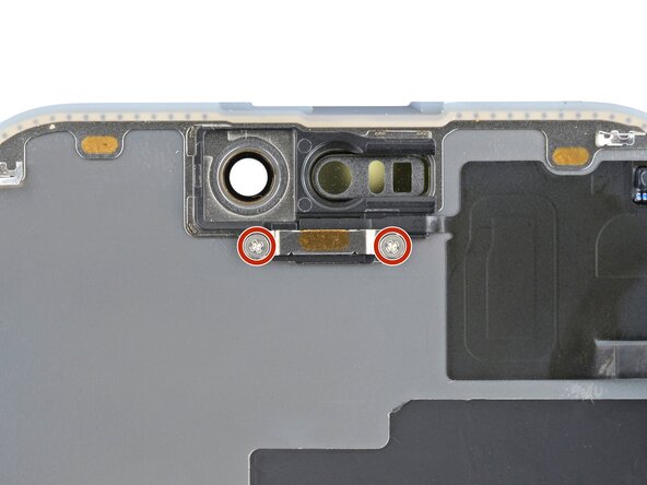

    2. iPhone 15 Pro Screen Replacement, Remove the ambient light sensor cover screws: crwdns2935265:026crwdnd2935265:01crwdnd2935265:02crwdne2935265:0 iPhone 15 Pro Screen Replacement, Remove the ambient light sensor cover screws: crwdns2935265:026crwdnd2935265:02crwdnd2935265:02crwdne2935265:0
      • Use a Phillips #000 driver to remove the two 1.4 mm-long screws securing the ambient light sensor cover.
    3. iPhone 15 Pro Screen Replacement, Remove the ambient light sensor cover: crwdns2935265:027crwdnd2935265:01crwdnd2935265:01crwdne2935265:0
      • Remove the ambient light sensor cover.

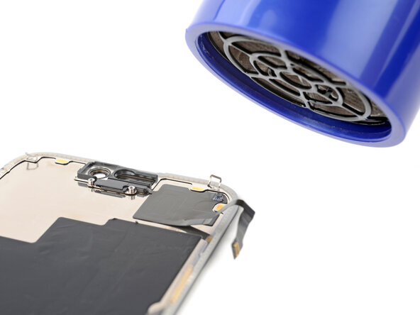

    4. iPhone 15 Pro Screen Replacement, Heat the ambient light sensor adhesive: crwdns2935265:028crwdnd2935265:01crwdnd2935265:01crwdne2935265:0
      • Be careful not to overheat the screen—the plastic components can melt if they get too hot.
      • Use a hair dryer or heat gun to heat the ambient light sensor until it's warm to the touch.

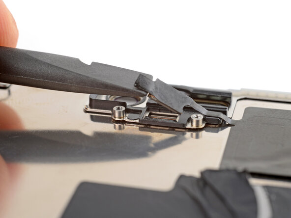

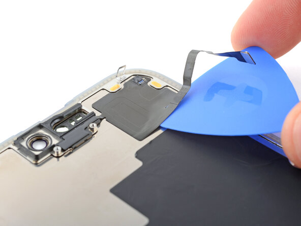

    5. iPhone 15 Pro Screen Replacement, Pry up the sensor: crwdns2935265:029crwdnd2935265:01crwdnd2935265:02crwdne2935265:0 iPhone 15 Pro Screen Replacement, Pry up the sensor: crwdns2935265:029crwdnd2935265:02crwdnd2935265:02crwdne2935265:0
      • Be very gentle handing the ambient light sensor, as its cable is extremely fragile.
      • Use the flat end of a spudger to gently lift the ambient light sensor out of its enclosure.

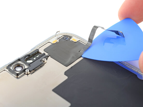

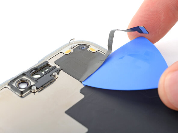

    6. iPhone 15 Pro Screen Replacement, Reheat the ambient light sensor: crwdns2935265:030crwdnd2935265:01crwdnd2935265:01crwdne2935265:0
      • By this point, the sensor has likely cooled down.
      • Apply more heat until the entire glued down part of the sensor is warm to the touch.
    7. iPhone 15 Pro Screen Replacement: crwdns2935265:031crwdnd2935265:01crwdnd2935265:03crwdne2935265:0 iPhone 15 Pro Screen Replacement: crwdns2935265:031crwdnd2935265:02crwdnd2935265:03crwdne2935265:0 iPhone 15 Pro Screen Replacement: crwdns2935265:031crwdnd2935265:03crwdnd2935265:03crwdne2935265:0
      • Insert the tip of an opening pick under the bottom right corner of the sensor.
      • Slide the pick under the sensor and lift until you can grip it with your fingers.

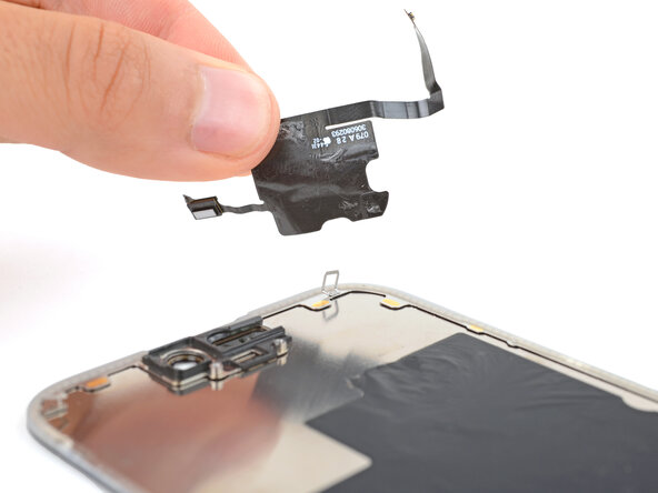

    8. iPhone 15 Pro Screen Replacement, Remove the ambient light sensor: crwdns2935265:032crwdnd2935265:01crwdnd2935265:01crwdne2935265:0
      • Use your fingers to slowly peel up and remove the sensor.

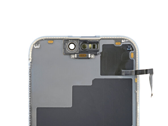

    1. iPhone 15 Pro Screen Replacement, Disassembly complete: crwdns2935265:033crwdnd2935265:01crwdnd2935265:01crwdne2935265:0
      • Congratulations on completing disassembly! The remaining steps show how to reassemble the iPhone.

      • The adhesive remaining on the phone is difficult to remove and leaves residue. If you have trouble removing the adhesive, apply some heat using a hair dryer or heat gun.
      • Use a spudger to push the screen adhesive up until you can grab it with a pair of tweezers.
      • Use a pair of tweezers, or your fingers, to remove the adhesive around the entire perimeter of the iPhone.
    2. iPhone 15 Pro Screen Replacement: crwdns2935265:039crwdnd2935265:01crwdnd2935265:03crwdne2935265:0 iPhone 15 Pro Screen Replacement: crwdns2935265:039crwdnd2935265:02crwdnd2935265:03crwdne2935265:0 iPhone 15 Pro Screen Replacement: crwdns2935265:039crwdnd2935265:03crwdnd2935265:03crwdne2935265:0
      • Any unevenness will compromise the iPhone's seal. Clean the frame thoroughly.
      • Apply a few drops of high-concentration (greater than 90%) isopropyl alcohol to a cotton swab or lint-free cloth.
      • Wipe along the perimeter of the frame to clean the adhesive residue.
      • Wait a few minutes before proceeding to make sure any excess alcohol has evaporated.
