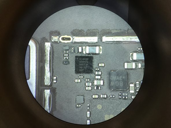

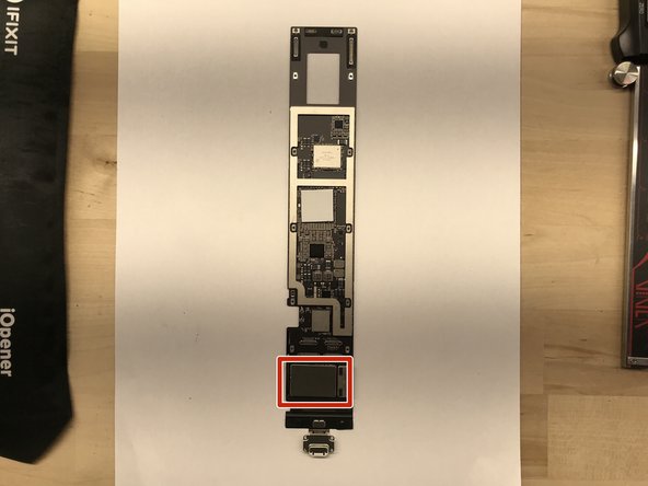

  29. iPad Pro 10.5" Tristar Replacement, Tristar: crwdns2935265:029crwdnd2935265:01crwdnd2935265:03crwdne2935265:0 iPad Pro 10.5" Tristar Replacement, Tristar: crwdns2935265:029crwdnd2935265:02crwdnd2935265:03crwdne2935265:0 iPad Pro 10.5" Tristar Replacement, Tristar: crwdns2935265:029crwdnd2935265:03crwdnd2935265:03crwdne2935265:0
    • Tristar is located near the bottom of the logic board near the lightning connector.
    • The chip is hidden under a metal shield that is soldered to the logic board.
    • The Tristar ID on this iPad is 610A3B. This is the same chip found on the iPhone 7/7+
  30. iPad Pro 10.5" Tristar Replacement: crwdns2935265:030crwdnd2935265:01crwdnd2935265:02crwdne2935265:0 iPad Pro 10.5" Tristar Replacement: crwdns2935265:030crwdnd2935265:02crwdnd2935265:02crwdne2935265:0
    • Remove the metal shield from the iPad.
    • Use max heat and max air on your hot air station for this step ONLY. Move the nozzle around the edge of the cover to flow the solder holding it to the logic board.
    • Lift straight up so that the logic board is slightly hovering from the desktop. The logic board will drop down once the solder flows.
    • Hot air is hot! Most hot air stations can reach 500ºC (900ºF). Wear the appropriate personal protective equipment.
