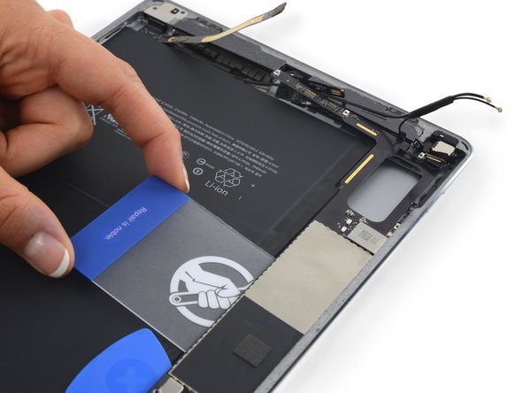

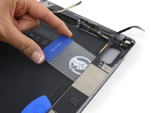

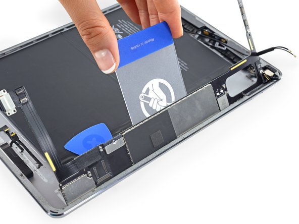

  33. iPad Air 2 Wi-Fi Logic Board Replacement: crwdns2935265:033crwdnd2935265:01crwdnd2935265:02crwdne2935265:0 iPad Air 2 Wi-Fi Logic Board Replacement: crwdns2935265:033crwdnd2935265:02crwdnd2935265:02crwdne2935265:0
    • To reduce the risk of a short, you can use a battery isolation pick to disconnect the battery.
    • Be very careful when you isolate the battery using a battery blocker. The battery contacts are easily damaged, resulting in irreversible damage to the logic board.
    • Slide a battery isolation pick underneath the battery connector area of the logic board, and leave it in place while you work.
    • Alternatively, make a battery blocker using a playing card and slide it underneath the logic board connector to disconnect the battery.

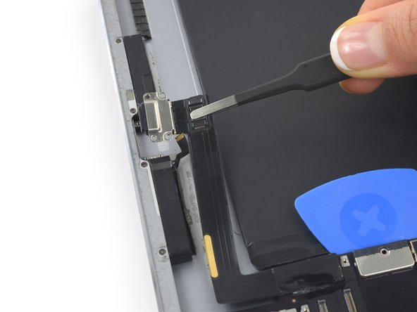

  35. iPad Air 2 Wi-Fi Logic Board Replacement: crwdns2935265:035crwdnd2935265:01crwdnd2935265:02crwdne2935265:0 iPad Air 2 Wi-Fi Logic Board Replacement: crwdns2935265:035crwdnd2935265:02crwdnd2935265:02crwdne2935265:0
    • Disconnect the display data connector from its socket on the logic board.
  36. iPad Air 2 Wi-Fi Logic Board Replacement: crwdns2935265:036crwdnd2935265:01crwdnd2935265:03crwdne2935265:0 iPad Air 2 Wi-Fi Logic Board Replacement: crwdns2935265:036crwdnd2935265:02crwdnd2935265:03crwdne2935265:0 iPad Air 2 Wi-Fi Logic Board Replacement: crwdns2935265:036crwdnd2935265:03crwdnd2935265:03crwdne2935265:0
    • Disconnect the two remaining digitizer cables underneath the display data cable.
  37. iPad Air 2 Wi-Fi Logic Board Replacement: crwdns2935265:037crwdnd2935265:01crwdnd2935265:01crwdne2935265:0

    • The Lightning connector cable is stuck to the case with some adhesive. To detach the adhesive you will be sliding an opening pick between the cable and the case. Be very careful not to cut the Lightning connector cable itself.
    • Insert an opening pick underneath the Lightning cable where it meets the logic board.
    • Slide the opening pick towards the bend in the cable.
  56. iPad Air 2 Wi-Fi Logic Board Replacement: crwdns2935265:056crwdnd2935265:01crwdnd2935265:02crwdne2935265:0 iPad Air 2 Wi-Fi Logic Board Replacement: crwdns2935265:056crwdnd2935265:02crwdnd2935265:02crwdne2935265:0

    • Insert a plastic card underneath the logic board.
    • Slide the card down the length of the logic board to release the adhesive.

    • Slide a plastic card underneath the center of the logic board, pushing it in as far as it will go.
    • Slowly swing the left edge of the logic board up, while making sure it doesn't snag against any of the disconnected cables.
    • If any portion of the logic board requires excessive force to pry up, stop prying, re-apply the iOpener, and re-perform the corresponding guide steps to fully release the adhesive.
  65. iPad Air 2 Wi-Fi Logic Board Replacement: crwdns2935265:065crwdnd2935265:01crwdnd2935265:03crwdne2935265:0 iPad Air 2 Wi-Fi Logic Board Replacement: crwdns2935265:065crwdnd2935265:02crwdnd2935265:03crwdne2935265:0 iPad Air 2 Wi-Fi Logic Board Replacement: crwdns2935265:065crwdnd2935265:03crwdnd2935265:03crwdne2935265:0
    • Remove the logic board.
