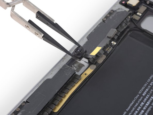

    • Twist the remaining pick by the front-facing camera to separate the top edge of the display assembly from the rear case.
  30. iPad Air 2 Wi-Fi Front-Facing Camera Replacement: crwdns2935265:030crwdnd2935265:01crwdnd2935265:03crwdne2935265:0 iPad Air 2 Wi-Fi Front-Facing Camera Replacement: crwdns2935265:030crwdnd2935265:02crwdnd2935265:03crwdne2935265:0 iPad Air 2 Wi-Fi Front-Facing Camera Replacement: crwdns2935265:030crwdnd2935265:03crwdnd2935265:03crwdne2935265:0
    • Continue lifting the display assembly from the front-facing camera side.
    • Pull the display slightly away from the bottom edge to completely separate it from the rear case.
    • Keep lifting until the display assembly is roughly perpendicular to the body of the iPad.
    • Do not attempt to remove the display yet—it is still attached to the rear case by three delicate ribbon cables.

  39. iPad Air 2 Wi-Fi Front-Facing Camera Replacement, Front-Facing Camera: crwdns2935265:039crwdnd2935265:01crwdnd2935265:02crwdne2935265:0 iPad Air 2 Wi-Fi Front-Facing Camera Replacement, Front-Facing Camera: crwdns2935265:039crwdnd2935265:02crwdnd2935265:02crwdne2935265:0
    • Use the flat end of a spudger to disconnect the FaceTime camera cable from its socket on the logic board.
  40. iPad Air 2 Wi-Fi Front-Facing Camera Replacement: crwdns2935265:040crwdnd2935265:01crwdnd2935265:02crwdne2935265:0 iPad Air 2 Wi-Fi Front-Facing Camera Replacement: crwdns2935265:040crwdnd2935265:02crwdnd2935265:02crwdne2935265:0
    • Use an opening pick to break up the adhesive holding the FaceTime camera ribbon cable to the headphone jack cable underneath.
  41. iPad Air 2 Wi-Fi Front-Facing Camera Replacement: crwdns2935265:041crwdnd2935265:01crwdnd2935265:02crwdne2935265:0 iPad Air 2 Wi-Fi Front-Facing Camera Replacement: crwdns2935265:041crwdnd2935265:02crwdnd2935265:02crwdne2935265:0
    • Firmly grasp the FaceTime camera with your hands or tweezers and pull up to remove it from the rear case.
    • The camera is attached to the rear case with single-use foam adhesive. When replacing the camera, use new adhesive or double-sided tape to install it.
