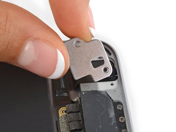

  40. iPad Air 2 Wi-Fi Audio Jack Replacement: crwdns2935265:040crwdnd2935265:01crwdnd2935265:02crwdne2935265:0 iPad Air 2 Wi-Fi Audio Jack Replacement: crwdns2935265:040crwdnd2935265:02crwdnd2935265:02crwdne2935265:0
    • Use an opening pick to lift the bracket up from the headphone jack.
    • Remove the bracket.

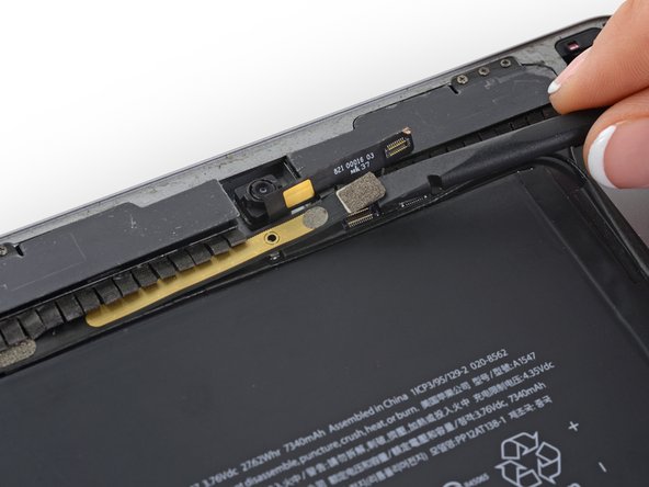

  41. iPad Air 2 Wi-Fi Audio Jack Replacement: crwdns2935265:041crwdnd2935265:01crwdnd2935265:02crwdne2935265:0 iPad Air 2 Wi-Fi Audio Jack Replacement: crwdns2935265:041crwdnd2935265:02crwdnd2935265:02crwdne2935265:0
    • Use the flat end of a spudger to disconnect the Facetime camera connector from its socket on the logic board.

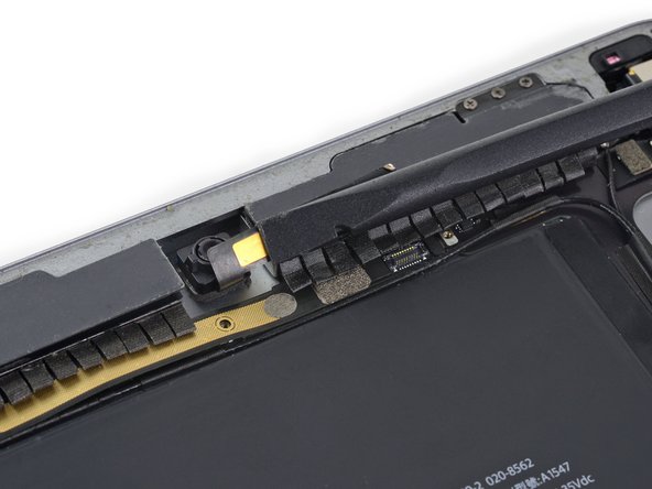

  42. iPad Air 2 Wi-Fi Audio Jack Replacement: crwdns2935265:042crwdnd2935265:01crwdnd2935265:02crwdne2935265:0 iPad Air 2 Wi-Fi Audio Jack Replacement: crwdns2935265:042crwdnd2935265:02crwdnd2935265:02crwdne2935265:0
    • Use the flat end of a spudger to pry up the adhesive securing the Facetime camera ribbon cable to the headphone jack ribbon cable underneath.
    • Fold up the FaceTime camera ribbon cable so that it is out of the way.

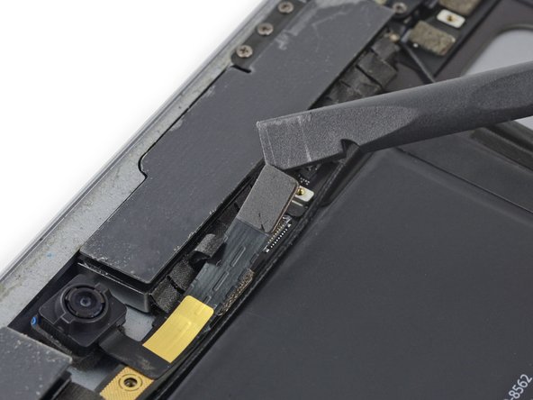

  43. iPad Air 2 Wi-Fi Audio Jack Replacement: crwdns2935265:043crwdnd2935265:01crwdnd2935265:02crwdne2935265:0 iPad Air 2 Wi-Fi Audio Jack Replacement: crwdns2935265:043crwdnd2935265:02crwdnd2935265:02crwdne2935265:0
    • Disconnect the headphone jack cable connector from its socket on the logic board.
