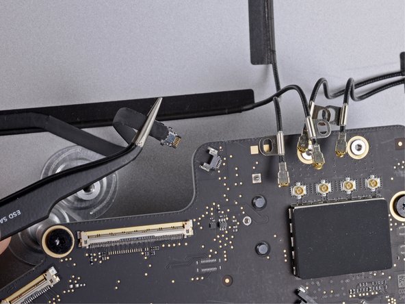

  20. iMac Intel 27" Retina 5K Display 2020 Logic Board Replacement: crwdns2935265:020crwdnd2935265:01crwdnd2935265:03crwdne2935265:0 iMac Intel 27" Retina 5K Display 2020 Logic Board Replacement: crwdns2935265:020crwdnd2935265:02crwdnd2935265:03crwdne2935265:0 iMac Intel 27" Retina 5K Display 2020 Logic Board Replacement: crwdns2935265:020crwdnd2935265:03crwdnd2935265:03crwdne2935265:0
    • Flip up the metal retaining bracket on the display data cable.
    • Disconnect the display data cable.
    • This is a delicate connection that can easily be broken. Be sure to pull the display data cable connector straight out of its socket, toward the top of the iMac.

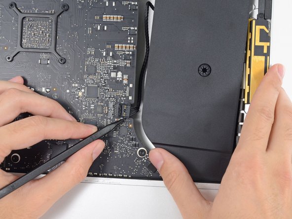

    • Be careful not to touch any solder joints on the back of the power supply. Capacitors may be charged enough to give you a dangerous shock.
    • Use a spudger to disconnect the power button connector from its socket on the logic board.

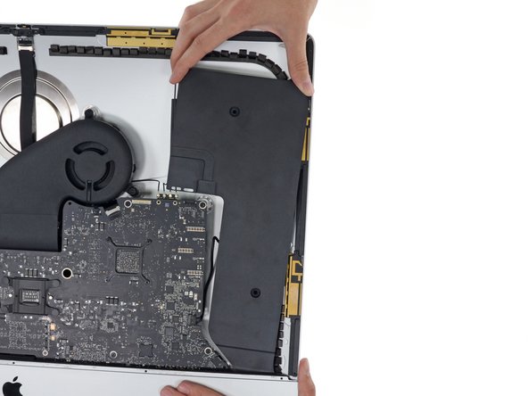

  32. iMac Intel 27" Retina 5K Display 2020 Logic Board Replacement, Remove the power supply: crwdns2935265:032crwdnd2935265:01crwdnd2935265:02crwdne2935265:0 iMac Intel 27" Retina 5K Display 2020 Logic Board Replacement, Remove the power supply: crwdns2935265:032crwdnd2935265:02crwdnd2935265:02crwdne2935265:0
    • When working on the power supply, be very careful not to touch the capacitor leads or any exposed solder joints on the back of the power supply. Only handle the board by the edges.
    • Disconnect the power supply control cable from the power supply.
  33. iMac Intel 27" Retina 5K Display 2020 Logic Board Replacement: crwdns2935265:033crwdnd2935265:01crwdnd2935265:01crwdne2935265:0
    • Remove the following four screws securing the power supply to the rear case (size T8 or T10 depending on the exact model):
    • Two 23.7 mm Torx screws
    • Two 7.3 mm Torx screws
  34. iMac Intel 27" Retina 5K Display 2020 Logic Board Replacement: crwdns2935265:034crwdnd2935265:01crwdnd2935265:03crwdne2935265:0 iMac Intel 27" Retina 5K Display 2020 Logic Board Replacement: crwdns2935265:034crwdnd2935265:02crwdnd2935265:03crwdne2935265:0 iMac Intel 27" Retina 5K Display 2020 Logic Board Replacement: crwdns2935265:034crwdnd2935265:03crwdnd2935265:03crwdne2935265:0
    • Do not attempt to remove the power supply from the case; it is still attached to the logic board by two cables.
    • Move the power supply board towards the left edge of the case and up to free it from the notch in the logic board.

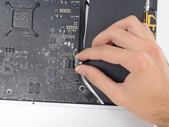

    • Depress the tab on the DC power cable connector, then pull it straight out of its socket on the back of the logic board.
    • If the cable is too difficult to disconnect, you can remove the power supply board and motherboard together.

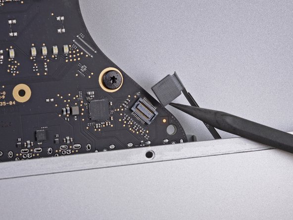

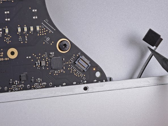

  39. iMac Intel 27" Retina 5K Display 2020 Logic Board Replacement: crwdns2935265:039crwdnd2935265:01crwdnd2935265:03crwdne2935265:0 iMac Intel 27" Retina 5K Display 2020 Logic Board Replacement: crwdns2935265:039crwdnd2935265:02crwdnd2935265:03crwdne2935265:0 iMac Intel 27" Retina 5K Display 2020 Logic Board Replacement: crwdns2935265:039crwdnd2935265:03crwdnd2935265:03crwdne2935265:0
    • Use a spudger to loosen the right speaker cable's connector from its socket on the logic board.
    • Pull the connector to the right to remove it from its socket.

    • Remove the metal bracket securing the antenna cables to the logic board.
  47. iMac Intel 27" Retina 5K Display 2020 Logic Board Replacement: crwdns2935265:047crwdnd2935265:01crwdnd2935265:03crwdne2935265:0 iMac Intel 27" Retina 5K Display 2020 Logic Board Replacement: crwdns2935265:047crwdnd2935265:02crwdnd2935265:03crwdne2935265:0 iMac Intel 27" Retina 5K Display 2020 Logic Board Replacement: crwdns2935265:047crwdnd2935265:03crwdnd2935265:03crwdne2935265:0

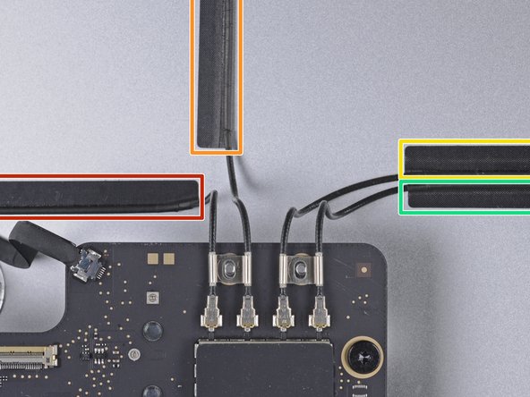

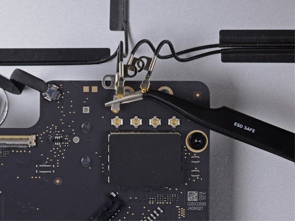

    • Use a pair of tweezers to disconnect the four antenna cables from the motherboard.
    • Note the original positions for each connector when reconnecting the cables. From left to right on the card, the antennas are connected in the following order:
    • Left
    • Top
    • Upper right
    • Lower right
  48. iMac Intel 27" Retina 5K Display 2020 Logic Board Replacement: crwdns2935265:048crwdnd2935265:01crwdnd2935265:02crwdne2935265:0 iMac Intel 27" Retina 5K Display 2020 Logic Board Replacement: crwdns2935265:048crwdnd2935265:02crwdnd2935265:02crwdne2935265:0
    • Use a pair of tweezers or your fingers to disconnect the ribbon cable left of the antenna cables from the logic board.
  49. iMac Intel 27" Retina 5K Display 2020 Logic Board Replacement: crwdns2935265:049crwdnd2935265:01crwdnd2935265:03crwdne2935265:0 iMac Intel 27" Retina 5K Display 2020 Logic Board Replacement: crwdns2935265:049crwdnd2935265:02crwdnd2935265:03crwdne2935265:0 iMac Intel 27" Retina 5K Display 2020 Logic Board Replacement: crwdns2935265:049crwdnd2935265:03crwdnd2935265:03crwdne2935265:0

  50. iMac Intel 27" Retina 5K Display 2020 Logic Board Replacement: crwdns2935265:050crwdnd2935265:01crwdnd2935265:03crwdne2935265:0 iMac Intel 27" Retina 5K Display 2020 Logic Board Replacement: crwdns2935265:050crwdnd2935265:02crwdnd2935265:03crwdne2935265:0 iMac Intel 27" Retina 5K Display 2020 Logic Board Replacement: crwdns2935265:050crwdnd2935265:03crwdnd2935265:03crwdne2935265:0

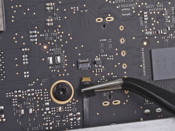

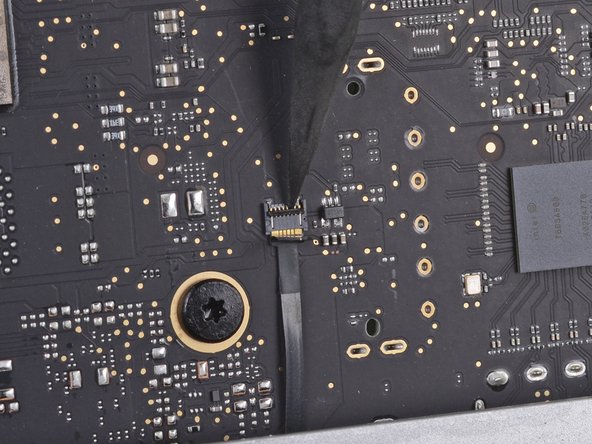

    • Use the tip of a spudger to flip open the retaining flap on the microphone ribbon cable ZIF socket.
    • Use a pair of tweezers to gently pull the microphone ribbon cable straight out of its socket.

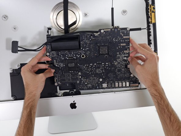

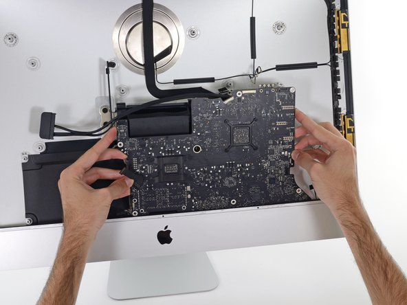

  53. iMac Intel 27" Retina 5K Display 2020 Logic Board Replacement: crwdns2935265:053crwdnd2935265:01crwdnd2935265:03crwdne2935265:0 iMac Intel 27" Retina 5K Display 2020 Logic Board Replacement: crwdns2935265:053crwdnd2935265:02crwdnd2935265:03crwdne2935265:0 iMac Intel 27" Retina 5K Display 2020 Logic Board Replacement: crwdns2935265:053crwdnd2935265:03crwdnd2935265:03crwdne2935265:0
    • When removing and installing the logic board, take care not to damage the delicate microphone ribbon cable at the bottom left of the board.
    • Tilt the logic board slightly forward.
    • Lift the logic board straight up and out of the iMac. Be careful not to snag it on any of the screw posts attached to the inside of the rear case.
