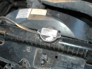

At this time replace the radiator cap. Take the car out for a test drive. When you return, check for leaks from the two drain plugs and the radiator cap.
Over the next few days, the morning after you've driven the car and it's had time to cool off fully, open the cap and check the level. It will continue to work out a bit of air and the level may drop. Keep it topped off until it is finished fully bleeding.
