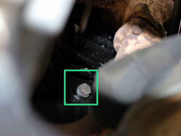

  5. How to change Mercedes W123 coolant: crwdns2935265:05crwdnd2935265:01crwdnd2935265:02crwdne2935265:0 How to change Mercedes W123 coolant: crwdns2935265:05crwdnd2935265:02crwdnd2935265:02crwdne2935265:0
    • The coolant drain plug on the side of the engine block cannot be seen from above the car. Even on this non-turbo the exhaust pipe is in the way, and it's beneath the throttle linkages that go to the transmission. It is located in the approximate location noted, behind the exhaust pipe.
    • It can be seen, with some effort, from below the car up through the tie-rods and other components.
    • If possible, as it is on the non-turbo cars, remove this bolt from above so as to not be in the way of the coolant as it drains. It can be done by feel once you've oriented yourself to the location of the bolt. It is removed using a 19mm socket, an extension, and a ratchet wrench.
    • It may be necessary to remove the bolt from below the car on turbo engine cars. If this is the case be prepared to quickly move out of the way and place the drain pan underneath. Coolant drains from this very rapidly.
  6. How to change Mercedes W123 coolant: crwdns2935265:06crwdnd2935265:01crwdnd2935265:01crwdne2935265:0
    • Shown here is the coolant drain bolt from the block. Plan to replace the washer after removal.
    • Note how short this bolt is. This means it will come out of the block sooner than you may expect it to. For this reason, as soon as it begins to feel loose enough when using the wrench to switch to turning it out by hand, this should be done. Otherwise your wrench, extension, socket, etc. may be in the way and will get covered in coolant.
    • When this drains the spray from the hole will hit the exhaust pipe, splash off of the engine cross-member, etc. It's definitely the messiest fluid change on these cars. Catch as much as you can in the catch pan and use kitty litter to soak up any that lands on your driveway.

What size is the coolant drain plug washer? ID and OD? What is it made of? Where can it be purchased? Multiple internet searches have yielded only oil drain plugs, and absolutely nothing about the coolant drain plugs.
Bill - crwdns2934203:0crwdne2934203:0
The engine block plug is a fastidious little POS... But with an almost stupid sense of determination it does come out, even if you are a novice. Thank you for the guide!
