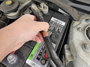

Rub the terminals of the new battery with sandpaper to remove any oxidation and ensure better electrical contact.
Sanding the terminals improves contact and prevents corrosion.
Slide the negative (black) cable onto the negative terminal and tighten the nut.
Slide the positive (red) cable onto the positive terminal and tighten the nut.
