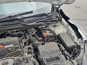

With the socket wrench, loosen the nut on the negative (black) terminal of the battery.
It is important to remove the negative (black) contact first to minimize the risk of short-circuiting the battery.
Pull straight up on the cable connector after loosening it.
