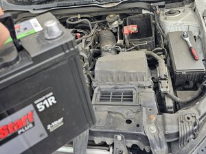

Lift the battery out of the engine bay using the handle on top.
Place the new battery into the compartment with the negative terminal at the top (farthest from you) and the positive terminal at the bottom (closest to you) as you stand in front of the hood.
Make sure the new battery is orientated like the old one to ensure correct terminal connections.
