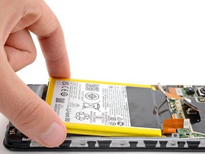

Remove the battery from the frame.
Don't reinstall a damaged or deformed battery, as doing so is a potential safety hazard.
Follow this guide to install new battery adhesive.
