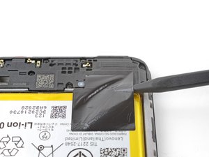

Adhesive lightly adheres graphite film to the battery.
Don't puncture the battery—it can leak dangerous chemicals and/or catch fire.
Insert the pointed end of a spudger under the graphite film on the left side of the daughterboard cover.
Lift up to peel the graphite film off of the battery.
