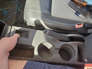

Pull up on your emergency brake as high as you can get it.
Remove the middle and rear section of the console to remove the front section.
Grab the sides of the console and start to wiggle it until you hear the sections unsnap from each other.
