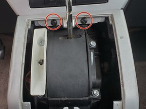

Remove the 19mm screws underneath the bezel using the Phillips #1 screwdriver.
Remove the bezel assembly.
