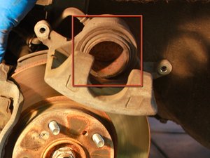

The new brake pads are thicker than the old pads. Because of this, the caliper piston protrudes too far out to allow enough clearance for the caliper to be placed over the new pads. You will need to manually retract the caliper piston.
To do this, place an old brake pad over the caliper piston.
