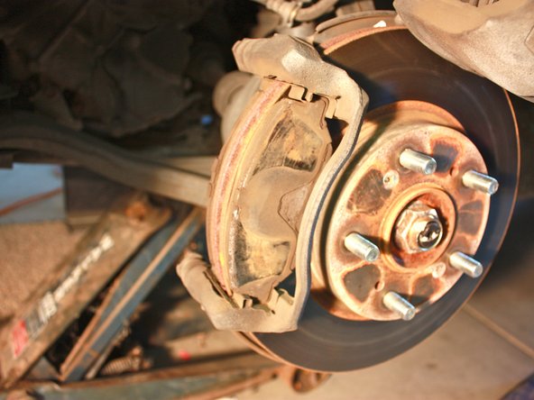

  5. 2003-2007 Honda Accord Front Brake Pads Replacement, Front Brake Pads: crwdns2935265:05crwdnd2935265:01crwdnd2935265:01crwdne2935265:0
    • Once car is raised, remove the lug nuts on one of the front tires with the 3/4'' socket.
  6. 2003-2007 Honda Accord Front Brake Pads Replacement: crwdns2935265:06crwdnd2935265:01crwdnd2935265:03crwdne2935265:0 2003-2007 Honda Accord Front Brake Pads Replacement: crwdns2935265:06crwdnd2935265:02crwdnd2935265:03crwdne2935265:0 2003-2007 Honda Accord Front Brake Pads Replacement: crwdns2935265:06crwdnd2935265:03crwdnd2935265:03crwdne2935265:0
    • Remove the wheel and tire off the wheel studs, and place it aside.
    • This exposes the caliper (shown in rectangle) and rotor (shown in circle).

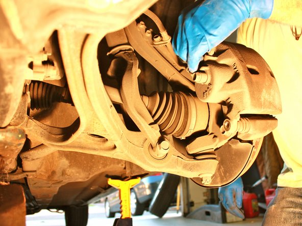

  7. 2003-2007 Honda Accord Front Brake Pads Replacement: crwdns2935265:07crwdnd2935265:01crwdnd2935265:03crwdne2935265:0 2003-2007 Honda Accord Front Brake Pads Replacement: crwdns2935265:07crwdnd2935265:02crwdnd2935265:03crwdne2935265:0 2003-2007 Honda Accord Front Brake Pads Replacement: crwdns2935265:07crwdnd2935265:03crwdnd2935265:03crwdne2935265:0
    • Identify the two mounting bolts on the rear of the caliper.
    • Using a 12 mm wrench or socket, remove the two caliper mounting bolts.
    • Alternatively, you may remove only the bottom mounting bolt and, using the top bolt as a hinge, rotate the caliper up and away from the rotor to access the brake pads. If you do this, skip the next step.

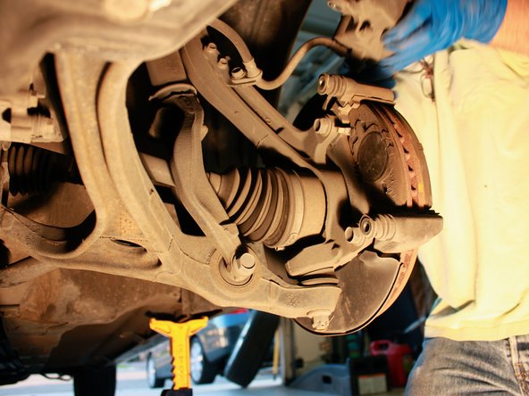

  8. 2003-2007 Honda Accord Front Brake Pads Replacement: crwdns2935265:08crwdnd2935265:01crwdnd2935265:03crwdne2935265:0 2003-2007 Honda Accord Front Brake Pads Replacement: crwdns2935265:08crwdnd2935265:02crwdnd2935265:03crwdne2935265:0 2003-2007 Honda Accord Front Brake Pads Replacement: crwdns2935265:08crwdnd2935265:03crwdnd2935265:03crwdne2935265:0
    • Slide the caliper off and rest it on the top of the rotor.
    • Do not let the caliper hang freely because the brake lines may stretch and weaken.

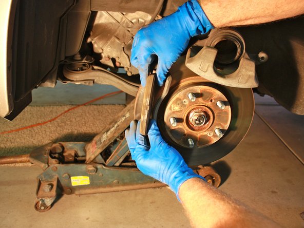

  9. 2003-2007 Honda Accord Front Brake Pads Replacement: crwdns2935265:09crwdnd2935265:01crwdnd2935265:02crwdne2935265:0 2003-2007 Honda Accord Front Brake Pads Replacement: crwdns2935265:09crwdnd2935265:02crwdnd2935265:02crwdne2935265:0
    • Pull the two old brake pads out of both the front and rear of the pad bracket.

  11. 2003-2007 Honda Accord Front Brake Pads Replacement: crwdns2935265:011crwdnd2935265:01crwdnd2935265:01crwdne2935265:0
    • Place the new brake pads into the bracket. Make sure that the new pads are secure.

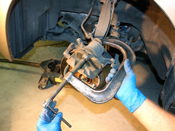

  12. 2003-2007 Honda Accord Front Brake Pads Replacement: crwdns2935265:012crwdnd2935265:01crwdnd2935265:01crwdne2935265:0
    • The new brake pads are thicker than the old pads. Because of this, the caliper piston protrudes too far out to allow enough clearance for the caliper to be placed over the new pads. You will need to manually retract the caliper piston.
    • To do this, place an old brake pad over the caliper piston.
  13. 2003-2007 Honda Accord Front Brake Pads Replacement: crwdns2935265:013crwdnd2935265:01crwdnd2935265:02crwdne2935265:0 2003-2007 Honda Accord Front Brake Pads Replacement: crwdns2935265:013crwdnd2935265:02crwdnd2935265:02crwdne2935265:0
    • Place one end of the c-clamp jaw over the old pad. Place the other end of the jaw on the rear of the caliper. Tighten the c-clamp to push the piston back into the caliper.
    • This will push oil back into the brake reservoir, which could overflow. This can be wasteful, messy, and damage your car's paint job. Make sure the reservoir isn't topped off. It is also a good idea to remove the cap from the reservoir before retracting the piston. The reservoir is located under the hood and should be clearly labeled.

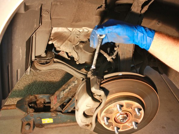

  14. 2003-2007 Honda Accord Front Brake Pads Replacement: crwdns2935265:014crwdnd2935265:01crwdnd2935265:02crwdne2935265:0 2003-2007 Honda Accord Front Brake Pads Replacement: crwdns2935265:014crwdnd2935265:02crwdnd2935265:02crwdne2935265:0
    • Slide the caliper over the brake pad bracket with the new brake pads.
    • If you removed the cap from the brake fluid reservoir replace it as soon as the brake caliper piston has been retracted. Do not leave the cap off any longer than absolutely necessary.
