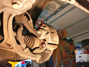

Identify the two mounting bolts on the rear of the caliper.
Using a 12 mm wrench or socket, remove the two caliper mounting bolts.
Alternatively, you may remove only the bottom mounting bolt and, using the top bolt as a hinge, rotate the caliper up and away from the rotor to access the brake pads. If you do this, skip the next step.
