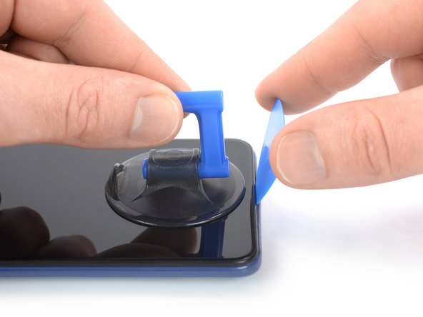

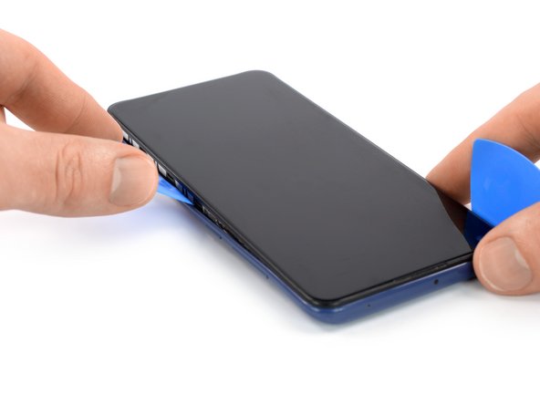

  3. Xiaomi Redmi Note 9 Battery Replacement, Insert an opening pick: crwdns2935265:03crwdnd2935265:01crwdnd2935265:03crwdne2935265:0 Xiaomi Redmi Note 9 Battery Replacement, Insert an opening pick: crwdns2935265:03crwdnd2935265:02crwdnd2935265:03crwdne2935265:0 Xiaomi Redmi Note 9 Battery Replacement, Insert an opening pick: crwdns2935265:03crwdnd2935265:03crwdnd2935265:03crwdne2935265:0
    • Secure a suction handle to the bottom edge of the screen, as close to the edge as possible.
    • If the screen is cracked, the suction handle may not stick. Try lifting it with strong tape, or superglue the suction handle in place and allow it to cure so you can proceed.
    • Lift the phone assembly with the suction handle to create a small gap between the assembly and the back cover.
    • In case you have trouble creating a gap, apply more heat to further soften the adhesive. Follow the iOpener instructions to avoid overheating.
    • Insert an opening pick in a steep angle into the gap you created. This might require some force.
    • Slide the opening pick to the bottom right corner to slice the adhesive and release the plastic clips holding the back cover in place.
  4. Xiaomi Redmi Note 9 Battery Replacement, Release the plastic clips and slice the adhesive: crwdns2935265:04crwdnd2935265:01crwdnd2935265:02crwdne2935265:0 Xiaomi Redmi Note 9 Battery Replacement, Release the plastic clips and slice the adhesive: crwdns2935265:04crwdnd2935265:02crwdnd2935265:02crwdne2935265:0
    • Insert a second opening pick in a steep angle at the bottom edge of your phone.
    • Slide the opening pick to the bottom left corner to release the plastic clips and to slice the adhesive.
    • Leave the opening picks in place to prevent the adhesive from resealing.

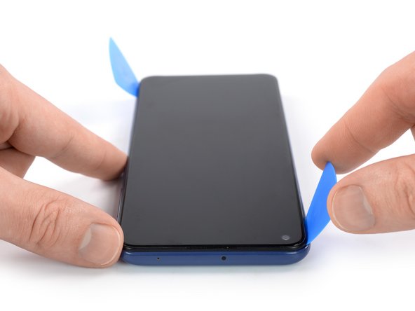

  6. Xiaomi Redmi Note 9 Battery Replacement: crwdns2935265:06crwdnd2935265:01crwdnd2935265:03crwdne2935265:0 Xiaomi Redmi Note 9 Battery Replacement: crwdns2935265:06crwdnd2935265:02crwdnd2935265:03crwdne2935265:0 Xiaomi Redmi Note 9 Battery Replacement: crwdns2935265:06crwdnd2935265:03crwdnd2935265:03crwdne2935265:0
    • Insert a fourth opening pick in a steep angle at the bottom right corner of your phone.
    • Slide the opening pick along the right edge of your phone to release the plastic clips and slice the adhesive.
    • Leave the opening pick in the top right corner to prevent the adhesive from resealing.

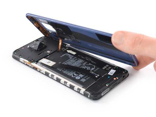

  7. Xiaomi Redmi Note 9 Battery Replacement, Open the phone assembly: crwdns2935265:07crwdnd2935265:01crwdnd2935265:03crwdne2935265:0 Xiaomi Redmi Note 9 Battery Replacement, Open the phone assembly: crwdns2935265:07crwdnd2935265:02crwdnd2935265:03crwdne2935265:0 Xiaomi Redmi Note 9 Battery Replacement, Open the phone assembly: crwdns2935265:07crwdnd2935265:03crwdnd2935265:03crwdne2935265:0
    • Flip your Redmi Note 9 over.
    • Avoid straining the fingerprint flex cable during the following procedure.
    • Carefully fold the back cover to the right side of the phone assembly like you would open a book from the back.
    • Slide the back cover underneath the phone assembly so that the phone assembly overlaps about one third of the back cover and the fingerprint cable is not strained.

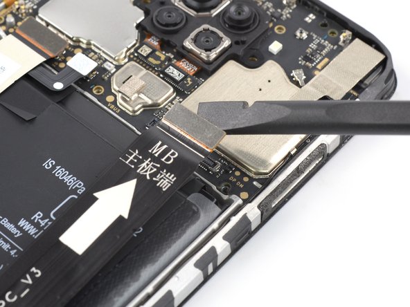

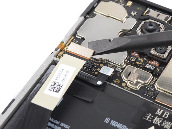

  12. Xiaomi Redmi Note 9 Battery Replacement, Disconnect the battery cable: crwdns2935265:012crwdnd2935265:01crwdnd2935265:02crwdne2935265:0 Xiaomi Redmi Note 9 Battery Replacement, Disconnect the battery cable: crwdns2935265:012crwdnd2935265:02crwdnd2935265:02crwdne2935265:0
    • Use a spudger to disconnect the battery cable by prying the connector straight up from its socket.

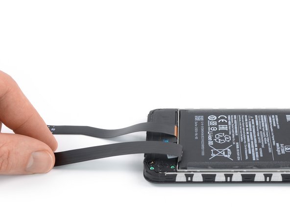

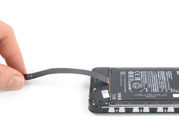

  16. Xiaomi Redmi Note 9 Battery Replacement, Free the left battery pull-tab: crwdns2935265:016crwdnd2935265:01crwdnd2935265:02crwdne2935265:0 Xiaomi Redmi Note 9 Battery Replacement, Free the left battery pull-tab: crwdns2935265:016crwdnd2935265:02crwdnd2935265:02crwdne2935265:0
    • Use a pair of blunt nose tweezers or your finger to carefully bend the battery cable to the left to get free access to the left battery pull-tab.

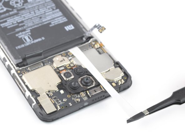

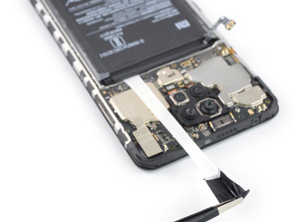

  17. Xiaomi Redmi Note 9 Battery Replacement, Remove the stretch-release adhesive: crwdns2935265:017crwdnd2935265:01crwdnd2935265:03crwdne2935265:0 Xiaomi Redmi Note 9 Battery Replacement, Remove the stretch-release adhesive: crwdns2935265:017crwdnd2935265:02crwdnd2935265:03crwdne2935265:0 Xiaomi Redmi Note 9 Battery Replacement, Remove the stretch-release adhesive: crwdns2935265:017crwdnd2935265:03crwdnd2935265:03crwdne2935265:0
    • The battery is secured to the rear case with two pieces of stretch-release adhesive.
    • Don't jab the battery with any sharp tools. A punctured battery may leak dangerous chemicals or catch fire.
    • Use a pair of blunt nose tweezers or a clean fingernail to peel down both battery adhesive pull-tabs to un-stick them from the top edge of the battery.
  18. Xiaomi Redmi Note 9 Battery Replacement, Remove the pull-tabs: crwdns2935265:018crwdnd2935265:01crwdnd2935265:03crwdne2935265:0 Xiaomi Redmi Note 9 Battery Replacement, Remove the pull-tabs: crwdns2935265:018crwdnd2935265:02crwdnd2935265:03crwdne2935265:0 Xiaomi Redmi Note 9 Battery Replacement, Remove the pull-tabs: crwdns2935265:018crwdnd2935265:03crwdnd2935265:03crwdne2935265:0
    • Grab the first pull-tab with a pair of blunt nose tweezers or your fingers and slowly pull it away from the battery and towards the bottom edge of your phone.
    • Pull hard enough to maintain tension on the strip, but don't force it. Give it plenty of time to stretch and un-stick from under the battery.
    • Don't press down on the battery. Hold the phone firmly by its sides.
    • Keep the strip flat and unwrinkled. Try to pull evenly on the whole strip, rather than pulling mainly in the middle or on one side.
    • Pull at a low angle so the strip doesn't snag on the edge of the battery.
    • If the adhesive strip breaks off, try to retrieve it using your fingers or blunt tweezers, and continue pulling—but do not pry under the battery.
    • If the adhesive breaks off underneath the battery and can't be retrieved, continue with the next step.
