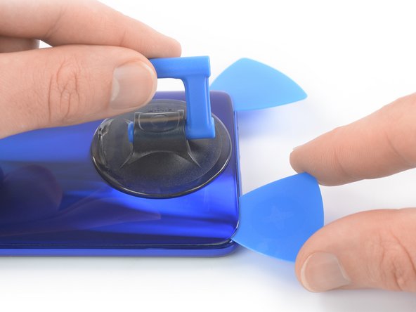

  2. Xiaomi Redmi Note 8 Pro Battery Replacement, Insert an opening pick: crwdns2935265:02crwdnd2935265:01crwdnd2935265:03crwdne2935265:0 Xiaomi Redmi Note 8 Pro Battery Replacement, Insert an opening pick: crwdns2935265:02crwdnd2935265:02crwdnd2935265:03crwdne2935265:0 Xiaomi Redmi Note 8 Pro Battery Replacement, Insert an opening pick: crwdns2935265:02crwdnd2935265:03crwdnd2935265:03crwdne2935265:0
    • Secure a suction handle to the bottom edge of the rear glass, as close to the edge as possible.
    • If the rear glass is cracked, the suction handle may not stick. Try lifting it with strong tape, or superglue the suction handle in place and allow it to cure so you can proceed.
    • Lift the rear glass with the suction handle to create a small gap between the rear glass and the frame.
    • In case you have trouble creating a gap, apply more heat to further soften the adhesive. Follow the iOpener instructions to avoid overheating.
    • Insert an opening pick into the gap you created.
    • Slide the opening pick to the bottom right corner to slice the adhesive.
    • Leave the opening pick in place to prevent the adhesive from resealing.

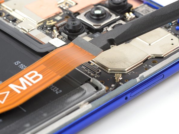

  16. Xiaomi Redmi Note 8 Pro Battery Replacement, Disconnect the interconnect cable: crwdns2935265:016crwdnd2935265:01crwdnd2935265:02crwdne2935265:0 Xiaomi Redmi Note 8 Pro Battery Replacement, Disconnect the interconnect cable: crwdns2935265:016crwdnd2935265:02crwdnd2935265:02crwdne2935265:0
    • Use a spudger to disconnect the interconnect cable by prying the connector straight up from its socket.

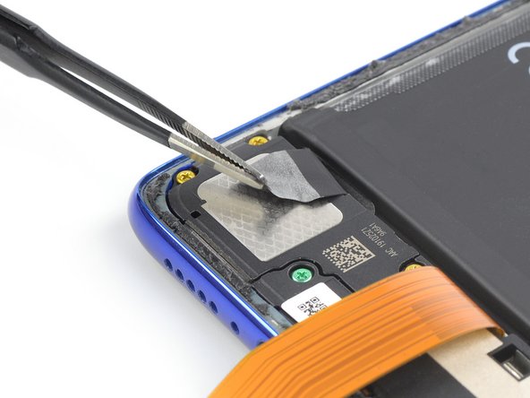

  17. Xiaomi Redmi Note 8 Pro Battery Replacement, Remove the black protective foil: crwdns2935265:017crwdnd2935265:01crwdnd2935265:03crwdne2935265:0 Xiaomi Redmi Note 8 Pro Battery Replacement, Remove the black protective foil: crwdns2935265:017crwdnd2935265:02crwdnd2935265:03crwdne2935265:0 Xiaomi Redmi Note 8 Pro Battery Replacement, Remove the black protective foil: crwdns2935265:017crwdnd2935265:03crwdnd2935265:03crwdne2935265:0
    • Carefully slide an opening pick underneath the black foil covering the battery and the loudspeaker assembly to loosen its adhesive.
    • Remove the black protective foil.

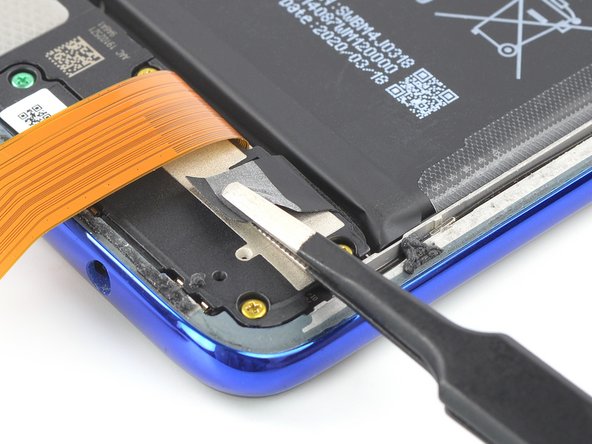

  19. Xiaomi Redmi Note 8 Pro Battery Replacement, Remove the stretch-release adhesive: crwdns2935265:019crwdnd2935265:01crwdnd2935265:03crwdne2935265:0 Xiaomi Redmi Note 8 Pro Battery Replacement, Remove the stretch-release adhesive: crwdns2935265:019crwdnd2935265:02crwdnd2935265:03crwdne2935265:0 Xiaomi Redmi Note 8 Pro Battery Replacement, Remove the stretch-release adhesive: crwdns2935265:019crwdnd2935265:03crwdnd2935265:03crwdne2935265:0
    • The battery is secured to the rear case with two pieces of stretch-release adhesive.
    • Use a pair of tweezers or a clean fingernail to peel down both battery adhesive pull-tabs to un-stick them from the bottom edge of the battery.
    • Don't jab the battery with any sharp tools. A punctured battery may leak dangerous chemicals or catch fire.

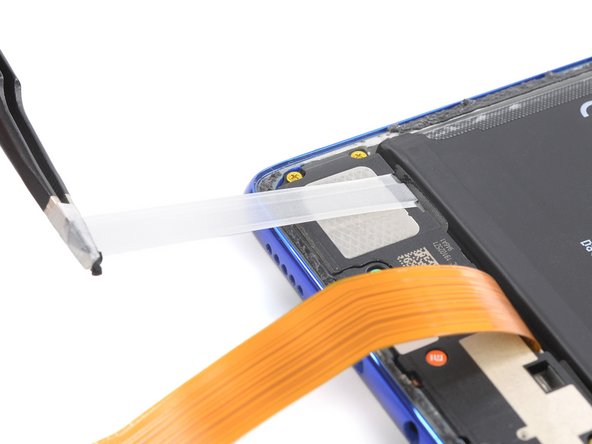

  20. Xiaomi Redmi Note 8 Pro Battery Replacement, Remove the pull-tabs: crwdns2935265:020crwdnd2935265:01crwdnd2935265:02crwdne2935265:0 Xiaomi Redmi Note 8 Pro Battery Replacement, Remove the pull-tabs: crwdns2935265:020crwdnd2935265:02crwdnd2935265:02crwdne2935265:0
    • Grab the first pull-tab with a pair of tweezers or your fingers and slowly pull it away from the battery and towards the bottom edge of your phone.
    • Pull hard enough to maintain tension on the strip, but don't force it. Give it plenty of time to stretch and un-stick from under the battery.
    • Don't press down on the battery. Hold the phone firmly by its sides.
    • Keep the strip flat and unwrinkled. Try to pull evenly on the whole strip, rather than pulling mainly in the middle or on one side.
    • Pull at a low angle so the strip doesn't snag on the edge of the battery.
    • If the adhesive strip breaks off, try to retrieve it using your fingers or blunt tweezers, and continue pulling—but do not pry under the battery.
    • If the adhesive breaks off underneath the battery and can't be retrieved, continue with the next step.
