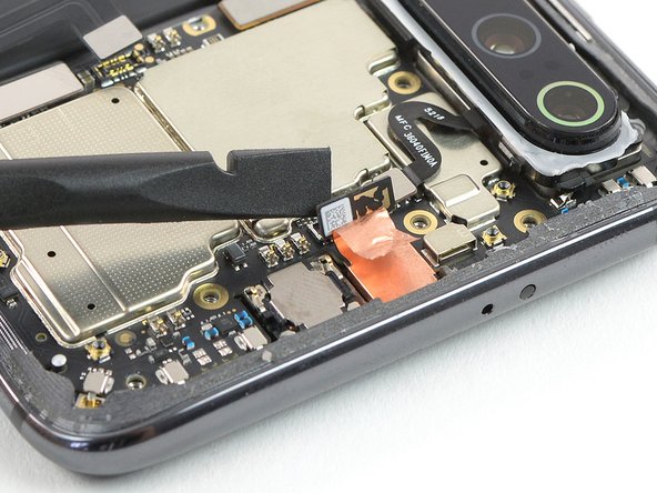

  12. Xiaomi Mi 9 Front Camera Replacement, Front Facing Camera: crwdns2935265:012crwdnd2935265:01crwdnd2935265:02crwdne2935265:0 Xiaomi Mi 9 Front Camera Replacement, Front Facing Camera: crwdns2935265:012crwdnd2935265:02crwdnd2935265:02crwdne2935265:0
    • Use a pair of tweezers to pell the copper tape off the motherboard and fold it out of the way.
  13. Xiaomi Mi 9 Front Camera Replacement: crwdns2935265:013crwdnd2935265:01crwdnd2935265:02crwdne2935265:0 Xiaomi Mi 9 Front Camera Replacement: crwdns2935265:013crwdnd2935265:02crwdnd2935265:02crwdne2935265:0
    • Use the flat end of a spudger to pry up and disconnect the flex cable of the front camera.
  14. Xiaomi Mi 9 Front Camera Replacement: crwdns2935265:014crwdnd2935265:01crwdnd2935265:02crwdne2935265:0 Xiaomi Mi 9 Front Camera Replacement: crwdns2935265:014crwdnd2935265:02crwdnd2935265:02crwdne2935265:0
    • Use a pair of tweezers to lift the front camera out of its recess and remove it.
