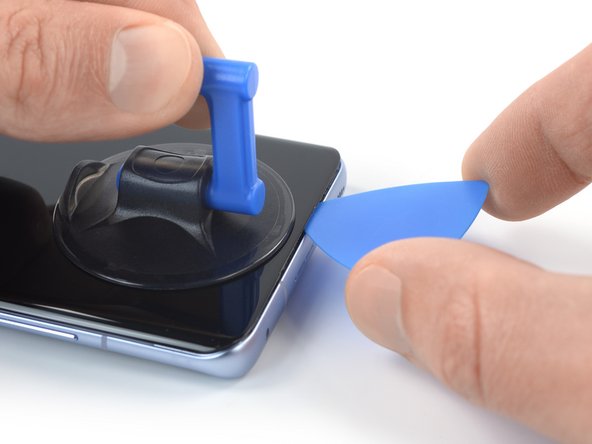

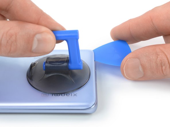

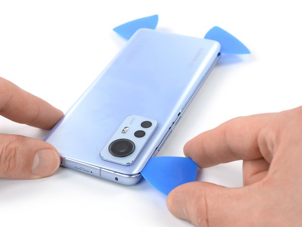

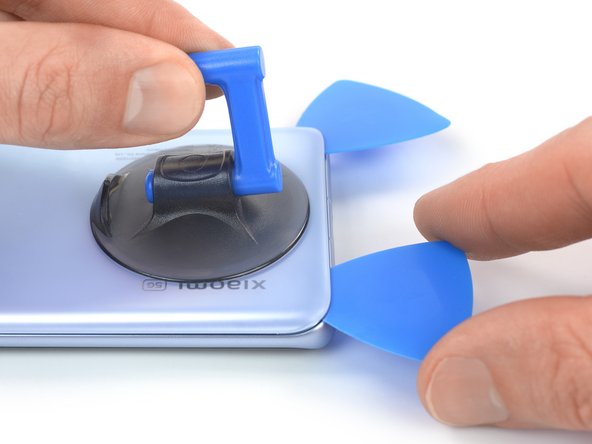

    2. Xiaomi 12 Screen Replacement, Insert an opening pick: crwdns2935265:02crwdnd2935265:01crwdnd2935265:03crwdne2935265:0 Xiaomi 12 Screen Replacement, Insert an opening pick: crwdns2935265:02crwdnd2935265:02crwdnd2935265:03crwdne2935265:0 Xiaomi 12 Screen Replacement, Insert an opening pick: crwdns2935265:02crwdnd2935265:03crwdnd2935265:03crwdne2935265:0
      • The adhesive securing the rear glass is strong, and creating a gap requires significant force. If you're having trouble, apply more heat and try again.
      • If your rear glass is badly cracked, covering it with a layer of clear packing tape may allow the suction handle to adhere. Alternatively, very strong tape may be used instead of the suction handle. If all else fails, you can superglue the suction handle to the broken rear glass.
      • Apply a suction handle to the center of the rear glass's bottom edge, as close to the edge as possible.
      • Pull up on the suction handle with strong, steady force to create a gap between the rear glass and frame.
      • Insert an opening pick where the charging port is located.

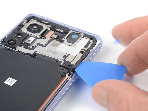

    3. Xiaomi 12 Screen Replacement, Slice the bottom edge adhesive: crwdns2935265:03crwdnd2935265:01crwdnd2935265:02crwdne2935265:0 Xiaomi 12 Screen Replacement, Slice the bottom edge adhesive: crwdns2935265:03crwdnd2935265:02crwdnd2935265:02crwdne2935265:0
      • During the following steps, don't insert your pick more than 4 mm to avoid damaging internal components.

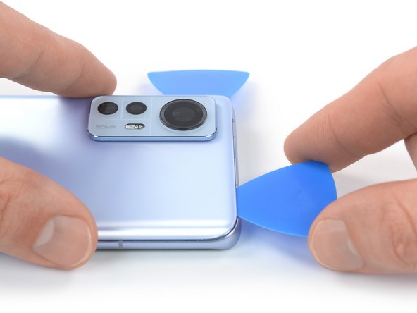

      • Slide the opening pick to the bottom right corner of the rear glass to slice its adhesive.
      • Leave the opening pick in place to prevent the adhesive from resealing.
    4. Xiaomi 12 Screen Replacement, Insert a second opening pick: crwdns2935265:04crwdnd2935265:01crwdnd2935265:02crwdne2935265:0 Xiaomi 12 Screen Replacement, Insert a second opening pick: crwdns2935265:04crwdnd2935265:02crwdnd2935265:02crwdne2935265:0
      • Insert a second opening pick at the bottom right corner and slide it to the bottom left corner of the rear glass to slice the adhesive.

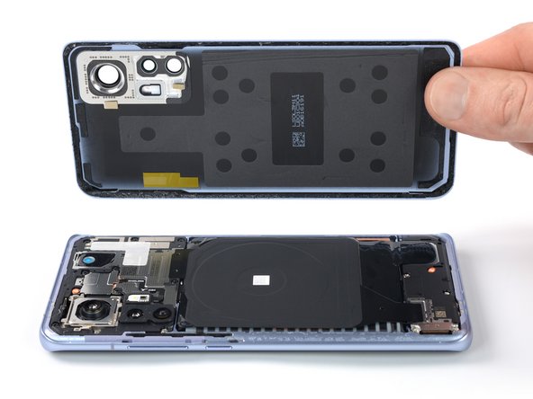

    8. Xiaomi 12 Screen Replacement, Remove the rear glass: crwdns2935265:08crwdnd2935265:01crwdnd2935265:02crwdne2935265:0 Xiaomi 12 Screen Replacement, Remove the rear glass: crwdns2935265:08crwdnd2935265:02crwdnd2935265:02crwdne2935265:0
      • Remove the rear glass.
      • If the rear glass is still stuck to the frame, slide an opening pick around the entire perimeter until the rear glass separates completely.
      • During reassembly:
      • This is a good point to power on your phone and test all functions before sealing it up. Be sure to power your phone back down completely before you continue working.
      • During reassembly, secure the rear glass with pre-cut adhesive or double-sided tape after cleaning the relevant areas with high-concentration isopropyl alcohol (>90%) and a lint-free cloth.
      • After installing the rear glass, apply strong, steady pressure to your phone for several minutes to help the adhesive form a good bond—a stack of heavy books works well.

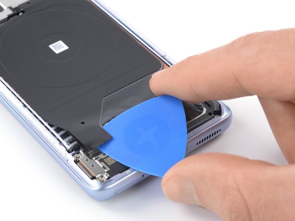

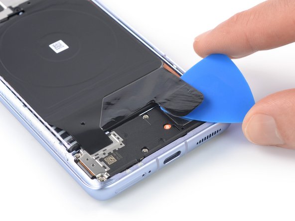

    1. Xiaomi 12 Screen Replacement, Loosen the charging coil assembly: crwdns2935265:09crwdnd2935265:01crwdnd2935265:03crwdne2935265:0 Xiaomi 12 Screen Replacement, Loosen the charging coil assembly: crwdns2935265:09crwdnd2935265:02crwdnd2935265:03crwdne2935265:0 Xiaomi 12 Screen Replacement, Loosen the charging coil assembly: crwdns2935265:09crwdnd2935265:03crwdnd2935265:03crwdne2935265:0
      • The charging coil assembly is adhered to the loudspeaker with mild adhesive tape.
      • Insert an opening pick under the bottom right corner of the charging coil.
      • Slide the pick toward the charging port to separate the adhesive.
      • Insert a pick under the bottom left corner of the charging coil and separate its adhesive.
      • An interconnect cable runs underneath the bottom left corner of the charging coil. Avoid tearing, slicing, or creasing it while separating the adhesive tape.

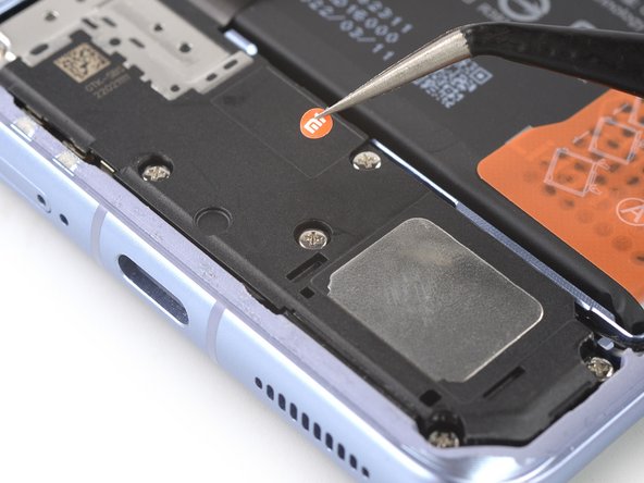

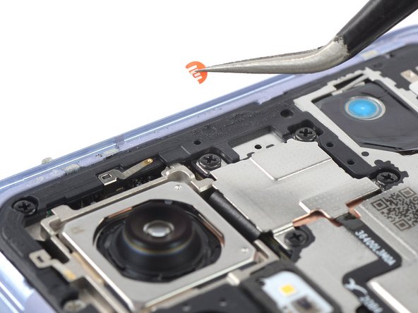

    2. Xiaomi 12 Screen Replacement, Remove the indicator sticker: crwdns2935265:010crwdnd2935265:01crwdnd2935265:02crwdne2935265:0 Xiaomi 12 Screen Replacement, Remove the indicator sticker: crwdns2935265:010crwdnd2935265:02crwdnd2935265:02crwdne2935265:0
      • An orange water damage indicator sticker covers a screw on the top edge of the motherboard cover. Pierce through it with your screwdriver or use tweezers to remove it.

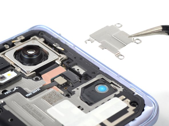

    4. Xiaomi 12 Screen Replacement, Remove the flash connector cover: crwdns2935265:012crwdnd2935265:01crwdnd2935265:02crwdne2935265:0 Xiaomi 12 Screen Replacement, Remove the flash connector cover: crwdns2935265:012crwdnd2935265:02crwdnd2935265:02crwdne2935265:0
      • Use tweezers or your fingers to remove the flash connector cover.

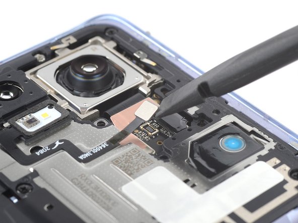

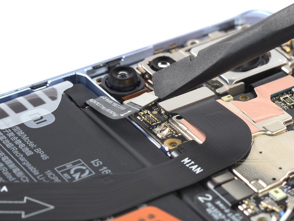

    5. Xiaomi 12 Screen Replacement, Disconnect the flash: crwdns2935265:013crwdnd2935265:01crwdnd2935265:02crwdne2935265:0 Xiaomi 12 Screen Replacement, Disconnect the flash: crwdns2935265:013crwdnd2935265:02crwdnd2935265:02crwdne2935265:0
      • Use the flat end of a spudger to pry up and disconnect the the flash press connector.

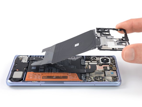

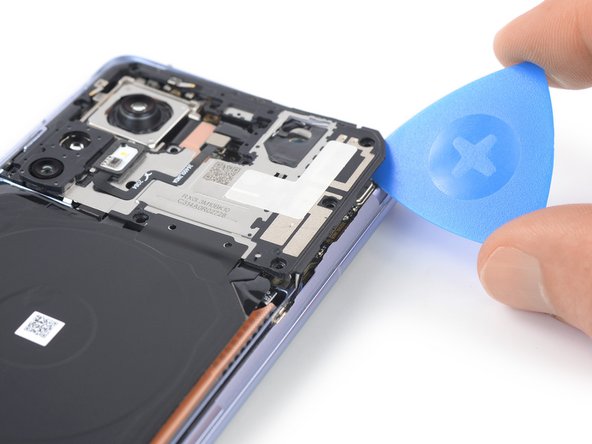

    7. Xiaomi 12 Screen Replacement, Pry up the motherboard cover: crwdns2935265:015crwdnd2935265:01crwdnd2935265:03crwdne2935265:0 Xiaomi 12 Screen Replacement, Pry up the motherboard cover: crwdns2935265:015crwdnd2935265:02crwdnd2935265:03crwdne2935265:0 Xiaomi 12 Screen Replacement, Pry up the motherboard cover: crwdns2935265:015crwdnd2935265:03crwdnd2935265:03crwdne2935265:0
      • The motherboard cover is further held in place by plastic clips.
      • Insert an opening pick under the bottom right corner of the motherboard cover and pry it up.
      • Slide the pick up along the right edge of the motherboard cover.
      • Twist the pick to release the remaining clips.
    8. Xiaomi 12 Screen Replacement, Remove the motherboard cover: crwdns2935265:016crwdnd2935265:01crwdnd2935265:02crwdne2935265:0 Xiaomi 12 Screen Replacement, Remove the motherboard cover: crwdns2935265:016crwdnd2935265:02crwdnd2935265:02crwdne2935265:0
      • Remove the motherboard cover.
      • The charging coil is attached to the motherboard cover and will lift up at the same time.
    9. Xiaomi 12 Screen Replacement, Disconnect the battery cables: crwdns2935265:017crwdnd2935265:01crwdnd2935265:03crwdne2935265:0 Xiaomi 12 Screen Replacement, Disconnect the battery cables: crwdns2935265:017crwdnd2935265:02crwdnd2935265:03crwdne2935265:0 Xiaomi 12 Screen Replacement, Disconnect the battery cables: crwdns2935265:017crwdnd2935265:03crwdnd2935265:03crwdne2935265:0
      • Use the flat end of a spudger to disconnect both battery cables by prying the connectors straight up from their sockets.

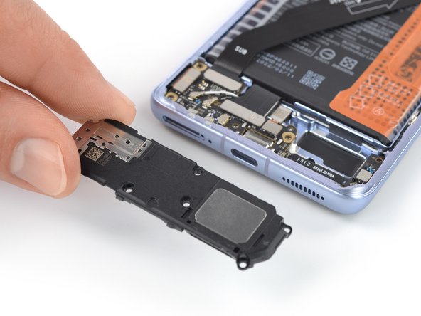

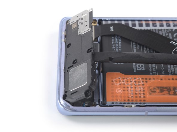

    2. Xiaomi 12 Screen Replacement, Unfasten the loudspeaker: crwdns2935265:019crwdnd2935265:01crwdnd2935265:01crwdne2935265:0
      • Use a Phillips screwdriver to remove the seven 3.4 mm-long screws securing the loudspeaker.
    3. Xiaomi 12 Screen Replacement, Pry up the loudspeaker: crwdns2935265:020crwdnd2935265:01crwdnd2935265:02crwdne2935265:0 Xiaomi 12 Screen Replacement, Pry up the loudspeaker: crwdns2935265:020crwdnd2935265:02crwdnd2935265:02crwdne2935265:0
      • Insert the flat end of a spudger under the top edge of the loudspeaker.
      • Pry upwards to to release the clips securing it to the frame.
    4. Xiaomi 12 Screen Replacement, Remove the loudspeaker: crwdns2935265:021crwdnd2935265:01crwdnd2935265:02crwdne2935265:0 Xiaomi 12 Screen Replacement, Remove the loudspeaker: crwdns2935265:021crwdnd2935265:02crwdnd2935265:02crwdne2935265:0
      • Remove the loudspeaker.

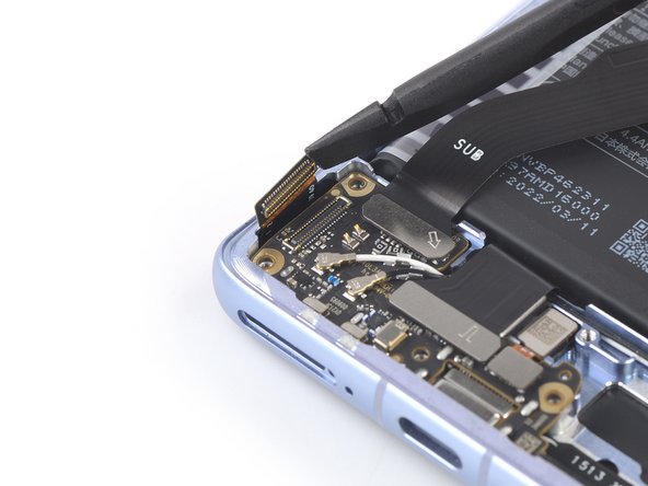

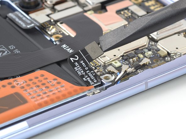

    1. Xiaomi 12 Screen Replacement, Disconnect the display: crwdns2935265:022crwdnd2935265:01crwdnd2935265:02crwdne2935265:0 Xiaomi 12 Screen Replacement, Disconnect the display: crwdns2935265:022crwdnd2935265:02crwdnd2935265:02crwdne2935265:0
      • Use the flat end of a spudger to disconnect the display cable by prying the connector straight up from its socket.
      • To re-attach press connectors like this one, carefully align and press down on one side until it clicks into place, then repeat on the other side. Don't press down in the middle. If the connector is misaligned, the pins can bend and cause permanent damage.

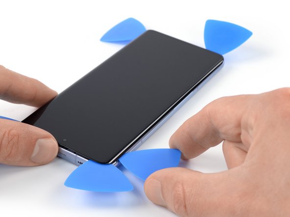

    2. Xiaomi 12 Screen Replacement, Loosen the display adhesive: crwdns2935265:023crwdnd2935265:01crwdnd2935265:01crwdne2935265:0
      • Prepare an iOpener and apply it to the screen for 5 minutes to loosen the adhesive underneath.
      • A hair dryer, heat gun, or hot plate may also be used, but be careful not to overheat the phone—the display and internal battery are both susceptible to heat damage.

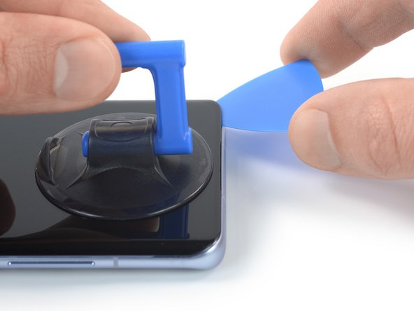

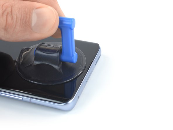

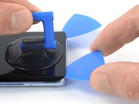

    3. Xiaomi 12 Screen Replacement, Insert an opening pick: crwdns2935265:024crwdnd2935265:01crwdnd2935265:03crwdne2935265:0 Xiaomi 12 Screen Replacement, Insert an opening pick: crwdns2935265:024crwdnd2935265:02crwdnd2935265:03crwdne2935265:0 Xiaomi 12 Screen Replacement, Insert an opening pick: crwdns2935265:024crwdnd2935265:03crwdnd2935265:03crwdne2935265:0
      • The adhesive securing the screen is extremely strong, and creating a gap requires significant force. If you're having trouble, apply more heat and try again.
      • Like the rear glass, if your screen is badly cracked, covering it with a layer of clear packing tape may allow the suction handle to adhere. Alternatively, very strong tape may be used instead of the suction handle. If all else fails, you can superglue the suction handle to the broken screen.
      • Apply a suction handle to the center of the screen's top edge, as close to the edge as possible.
      • Pull up on the suction handle with strong, steady force to create a gap between the screen and frame.
      • Insert an opening pick between the screen and the frame, near the earpiece speaker cutout.

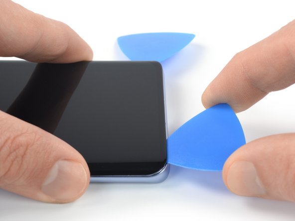

    4. Xiaomi 12 Screen Replacement, Slice the top edge adhesive: crwdns2935265:025crwdnd2935265:01crwdnd2935265:02crwdne2935265:0 Xiaomi 12 Screen Replacement, Slice the top edge adhesive: crwdns2935265:025crwdnd2935265:02crwdnd2935265:02crwdne2935265:0
      • During the following steps, don't insert your opening pick more than 4 mm to avoid damaging internal components.
      • Slide the pick to the top left corner of the screen to slice its adhesive.
      • Leave the pick in place to prevent the adhesive from resealing.
    5. Xiaomi 12 Screen Replacement: crwdns2935265:026crwdnd2935265:01crwdnd2935265:02crwdne2935265:0 Xiaomi 12 Screen Replacement: crwdns2935265:026crwdnd2935265:02crwdnd2935265:02crwdne2935265:0
      • Insert a second opening pick at the top left corner and slide it to the top right corner of the screen to slice the adhesive.

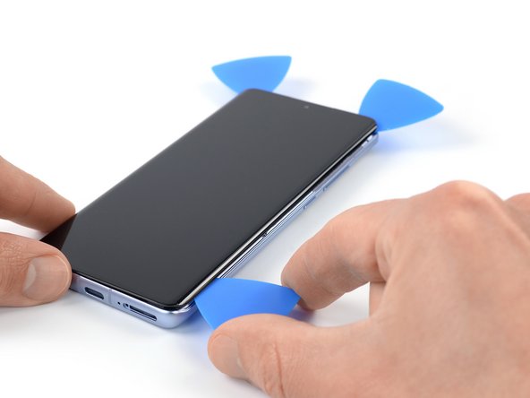

    6. Xiaomi 12 Screen Replacement, Slice the right edge adhesive: crwdns2935265:027crwdnd2935265:01crwdnd2935265:03crwdne2935265:0 Xiaomi 12 Screen Replacement, Slice the right edge adhesive: crwdns2935265:027crwdnd2935265:02crwdnd2935265:03crwdne2935265:0 Xiaomi 12 Screen Replacement, Slice the right edge adhesive: crwdns2935265:027crwdnd2935265:03crwdnd2935265:03crwdne2935265:0
      • If the adhesive becomes hard to cut, apply your iOpener for 1–2 minutes or use a hair dryer or heat gun to reheat it.
      • Insert a third opening pick under the top right corner of the screen.
      • Slide the opening pick along the right edge of the screen to slice the adhesive.
      • Leave the opening pick in the bottom right corner to prevent the adhesive from resealing.
    7. Xiaomi 12 Screen Replacement, Slice the bottom edge adhesive: crwdns2935265:028crwdnd2935265:01crwdnd2935265:02crwdne2935265:0 Xiaomi 12 Screen Replacement, Slice the bottom edge adhesive: crwdns2935265:028crwdnd2935265:02crwdnd2935265:02crwdne2935265:0
      • Insert a fourth opening pick under the bottom right corner of the screen.
      • Slide the opening pick along the bottom edge of the phone to slice the adhesive.
      • Leave the opening pick in the bottom left corner to prevent the adhesive from resealing.
    8. Xiaomi 12 Screen Replacement, Slice the left edge adhesive: crwdns2935265:029crwdnd2935265:01crwdnd2935265:02crwdne2935265:0 Xiaomi 12 Screen Replacement, Slice the left edge adhesive: crwdns2935265:029crwdnd2935265:02crwdnd2935265:02crwdne2935265:0
      • Insert a fifth opening pick under the bottom left corner of the screen and slide it along the left edge of the phone to slice the remaining adhesive.
      • Don't try to remove the display all the way yet, as the display cable is still threaded through the midframe.

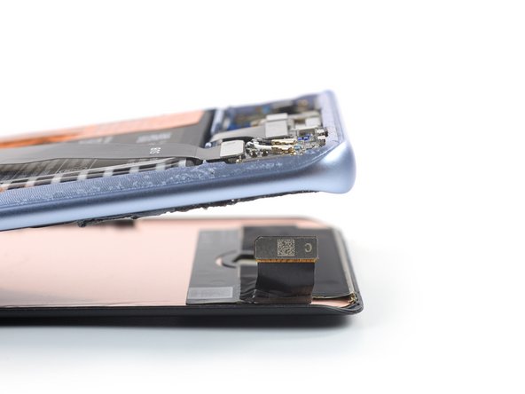

    9. Xiaomi 12 Screen Replacement, Loosen remaining adhesive: crwdns2935265:030crwdnd2935265:01crwdnd2935265:01crwdne2935265:0
      • There are thick patches of adhesive around the corners of the screen that need to be further softened before you can remove the screen.
      • Prepare an iOpener and apply it to the screen for 2 minutes to loosen the adhesive.
      • Lift the screen off of the frame until it separates from the thicker adhesive patches. Don‘t try to separate the screen completely before the display cable is freed in the next step.
      • If the screen is still stuck to the frame, slide an opening pick around the entire perimeter until the screen separates completely.

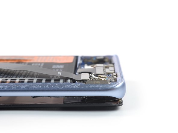

    10. Xiaomi 12 Screen Replacement, Free the display cable: crwdns2935265:031crwdnd2935265:01crwdnd2935265:03crwdne2935265:0 Xiaomi 12 Screen Replacement, Free the display cable: crwdns2935265:031crwdnd2935265:02crwdnd2935265:03crwdne2935265:0 Xiaomi 12 Screen Replacement, Free the display cable: crwdns2935265:031crwdnd2935265:03crwdnd2935265:03crwdne2935265:0
      • Flip the phone over, screen-side down.
      • Lift the bottom edge of the phone and carefully thread the display cable through its gap in the frame.
    11. Xiaomi 12 Screen Replacement, Remove the screen: crwdns2935265:032crwdnd2935265:01crwdnd2935265:01crwdne2935265:0
      • Remove the screen.
