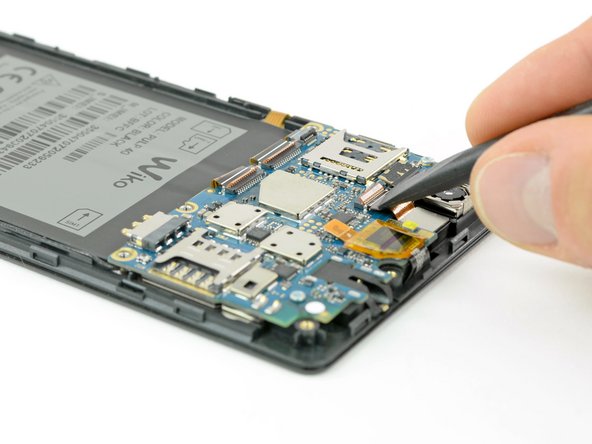

    • On the back of the display assembly we find the motherboard at the top section.
    • We take a moment to rejoice when we see all those ZIF connectors and bracket-covered press connectors. Then, start swiftly unlocking and unplugging them one by one.

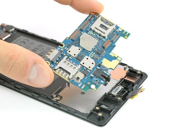

    • One of the display cables still clings to the motherboard but can be peeled off easily.
    • Just two more Phillips screws to unscrew and we can take the board out for a close inspection.

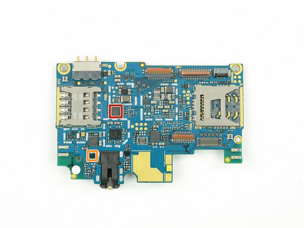

    • IC Identification, Continued:
    • Qorvo RF1496A SP12T Antenna Switch
    • Skyworks SKY13416-485LF SP6T Antenna Switch
    • Texas Instruments TPD1S414 USB Charger OVP Switch w/ ESD Protection
    • ON Semiconductor NCP114AMX310T 300 mA/3.1 V LDO Regulator
    • Silergy DC-DC Converters
    • Likely Maxscend GNSS LNA
  12. Wiko Pulp 4G Teardown: crwdns2935265:012crwdnd2935265:01crwdnd2935265:02crwdne2935265:0 Wiko Pulp 4G Teardown: crwdns2935265:012crwdnd2935265:02crwdnd2935265:02crwdne2935265:0

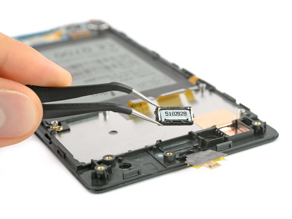

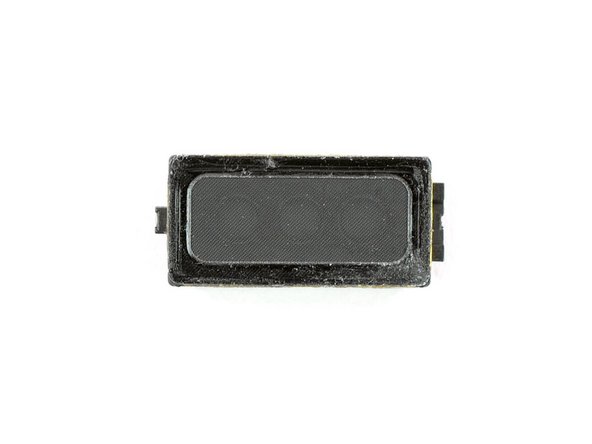

    • Behind the mother board we remove a rubber gasket that goes around the headphone jack and holds the lens for the LED flash.
    • Last part at the top section is the earpiece speaker.

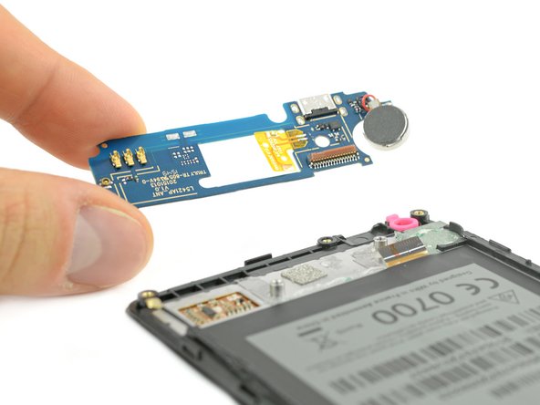

    • At the bottom of the display assembly we find a daughter board with some components.
    • First we disconnect the cable coming from the motherboard and pry out the vibrator.
    • Next we peel off a small connector plate and disconnect the antenna cable.
    • Now we are ready to carefully pry out the daughter board itself which is glued in with some double sided tape.

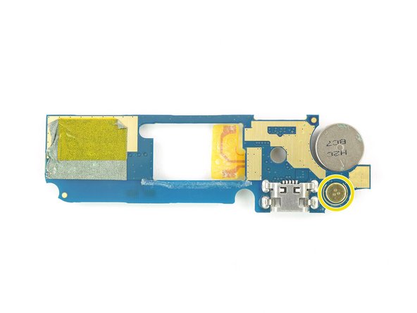

  15. Wiko Pulp 4G Teardown: crwdns2935265:015crwdnd2935265:01crwdnd2935265:02crwdne2935265:0 Wiko Pulp 4G Teardown: crwdns2935265:015crwdnd2935265:02crwdnd2935265:02crwdne2935265:0
    • Being able to detach the daughter board completely from the cable (and therefore from the mother board) is a big advantage over the shift5.1.
    • On the other hand, all of the components are soldered to the board, which makes repairing them individually a bit trickier.
    • USB port
    • Vibrator
    • Microphone

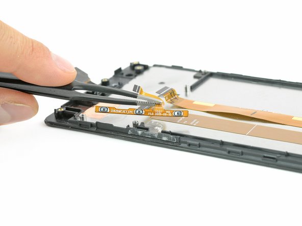

    • Speaking of the connection cable, we peel off the big sticker and find the second display cable running underneath and directly into the display itself.
    • With the sticker gone it is possible to also take away the power and volume buttons.
    • We stop here, leaving the connector cable in place.
