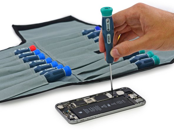

    • While there may not be any Phillips screws on the outside of this phone, there are certainly Phillips screws on the inside. Fortunately, our Pro Tech Screwdriver Set can handle any type of screw this phone dishes out.
    • With screwdriver in hand, we tackle the metal bracket screws that secure the front panel assembly in place.

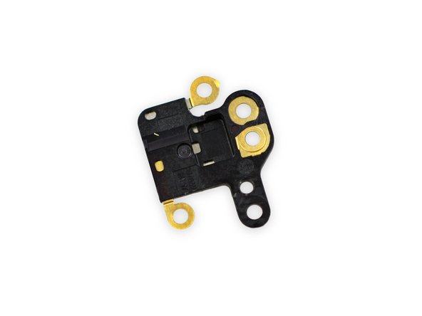

    • We tweeze out antennas faster than you can remove punny parts from a buzzing board game.
    • We master the operation and quickly move on.

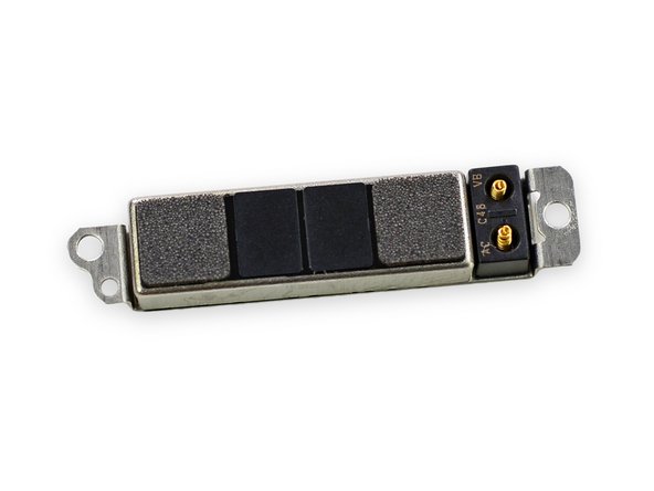

    • Removing the vibrator assembly. It's new and... improved?
    • Vibrator mechanisms seem to be one of those choices like Coke or Pepsi where there is never a clear answer. Apple keeps changing this part's design:
    • iPhone 4 (counterweight)
    • iPhone 4S (linear oscillating)
    • iPhone 5/5s (counterweight)
    • Based on appearances, we're guessing that Apple went with a linear oscillating design in this rendition of the iPhone.
