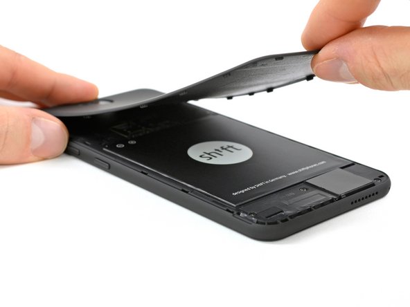

    • Having a user-removable battery usually equates to an easily removed back cover.
    • And that's what it is: very easy. We start with a small notch at the lower end of the cover and the flexible black plastic gives way to reveal the battery.

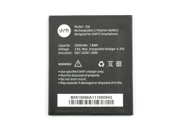

    • Taking the battery out is also easy as pie.
    • The 2000 mAh brings you 7.6 Wh at 3.8V, settling behind the 9.2 Wh from the Fairphone 2 battery.

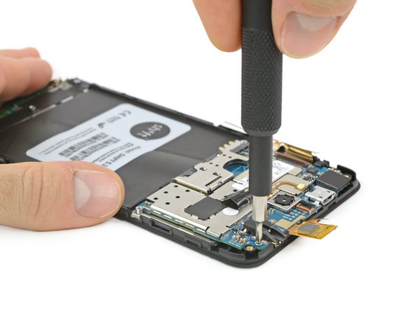

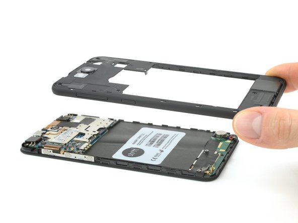

    • We bring out the Phillips #000 to loosen the seven screws and get further into the shift5.1.
    • A plastic opening tool helps us prying away the plastic frame.

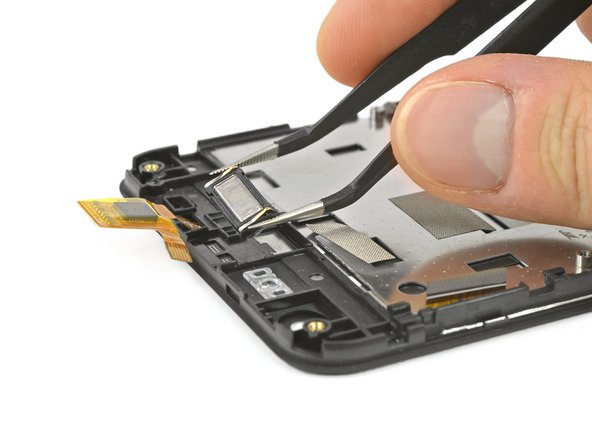

  6. Shift5.1 Teardown: crwdns2935265:06crwdnd2935265:01crwdnd2935265:02crwdne2935265:0 Shift5.1 Teardown: crwdns2935265:06crwdnd2935265:02crwdnd2935265:02crwdne2935265:0

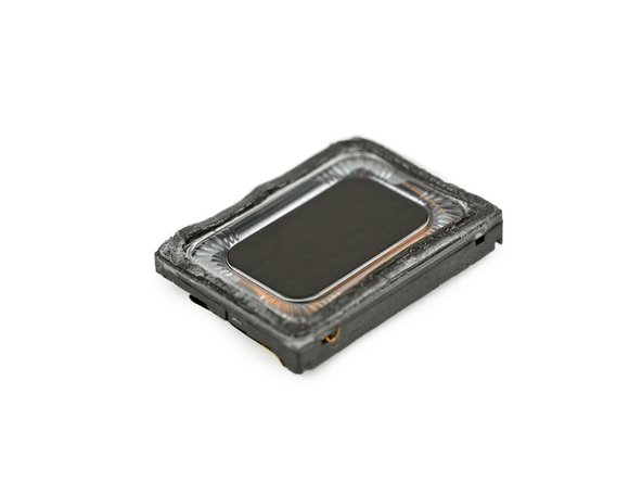

    • Before we take the frame aside we take a short look at the loudspeaker which is embedded with a mild double sided adhesive tape.

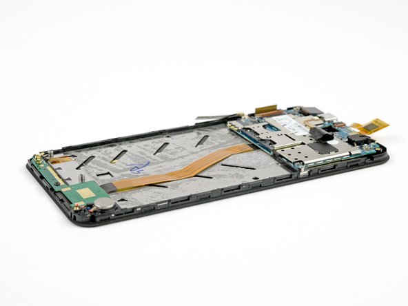

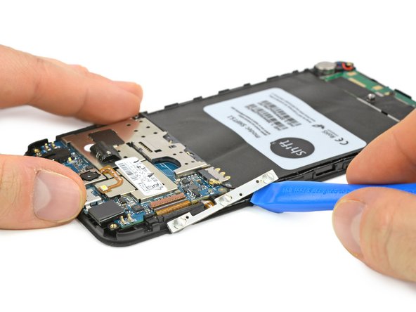

  7. Shift5.1 Teardown: crwdns2935265:07crwdnd2935265:01crwdnd2935265:03crwdne2935265:0 Shift5.1 Teardown: crwdns2935265:07crwdnd2935265:02crwdnd2935265:03crwdne2935265:0 Shift5.1 Teardown: crwdns2935265:07crwdnd2935265:03crwdnd2935265:03crwdne2935265:0
    • On the back of the display unit we see the motherboard with a multitude of components mounted on it.
    • We unplug both of the display connectors and peel the volume buttons and power button unit loose from the frame.
    • A single Phillips screw holds the motherboard in place.
  8. Shift5.1 Teardown: crwdns2935265:08crwdnd2935265:01crwdnd2935265:03crwdne2935265:0 Shift5.1 Teardown: crwdns2935265:08crwdnd2935265:02crwdnd2935265:03crwdne2935265:0 Shift5.1 Teardown: crwdns2935265:08crwdnd2935265:03crwdnd2935265:03crwdne2935265:0

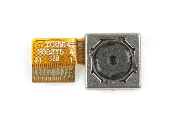

    • Now we can careful lift up the motherboard and take away the 8 MP rear camera.

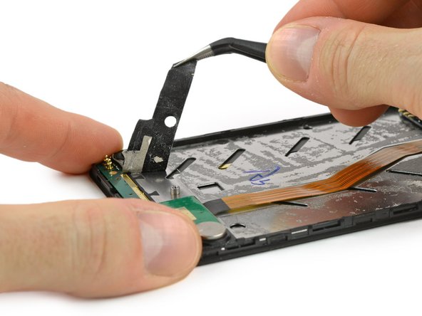

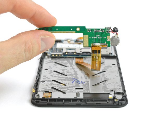

    • In regular teardown fashion, we get to work peeling up the strongly-adhered plastic cover in the base of the battery housing.
    • This huge black adhesive plastic foil hides the interconnect cable running from the motherboard to the daughterboard.
    • Breaking up adhesive is usually a destructive process, and this means that a simple daughterboard may become complicated quickly.
    • There is also a little adhesive tape over the daughterboard.

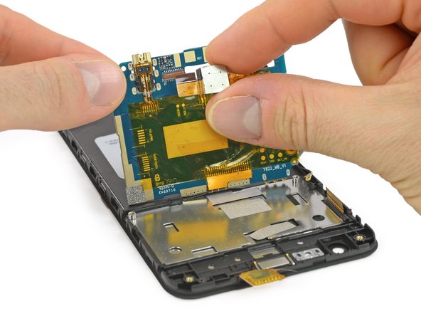

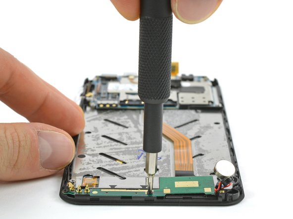

  10. Shift5.1 Teardown: crwdns2935265:010crwdnd2935265:01crwdnd2935265:03crwdne2935265:0 Shift5.1 Teardown: crwdns2935265:010crwdnd2935265:02crwdnd2935265:03crwdne2935265:0 Shift5.1 Teardown: crwdns2935265:010crwdnd2935265:03crwdnd2935265:03crwdne2935265:0
    • After lifting the vibrator and the microphone carefully out of their recesses we free the daughterboard by loosening two more Phillips screws.

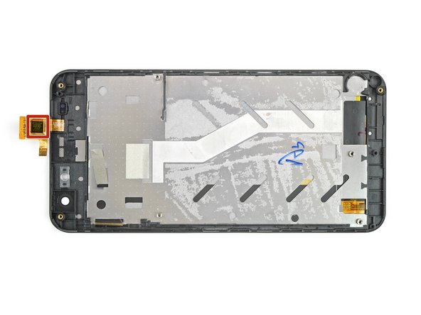

  13. Shift5.1 Teardown: crwdns2935265:013crwdnd2935265:01crwdnd2935265:03crwdne2935265:0 Shift5.1 Teardown: crwdns2935265:013crwdnd2935265:02crwdnd2935265:03crwdne2935265:0 Shift5.1 Teardown: crwdns2935265:013crwdnd2935265:03crwdnd2935265:03crwdne2935265:0
    • Last but not least we have the remaining display which carries the earpiece speaker.
    • Taking it out leaves us with the fused display which carries a GOODiX GT9147 touch screen controller on the flex cable.
  14. Shift5.1 Teardown: crwdns2935265:014crwdnd2935265:01crwdnd2935265:01crwdne2935265:0
