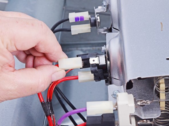

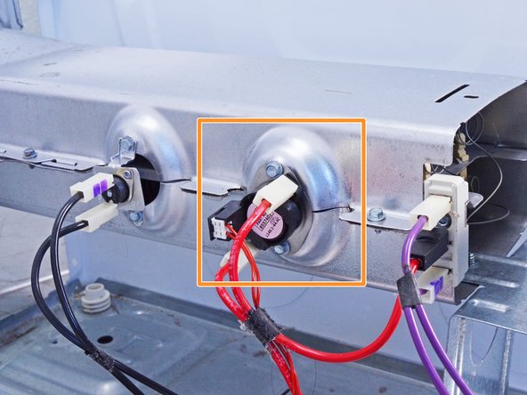

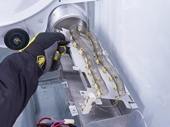

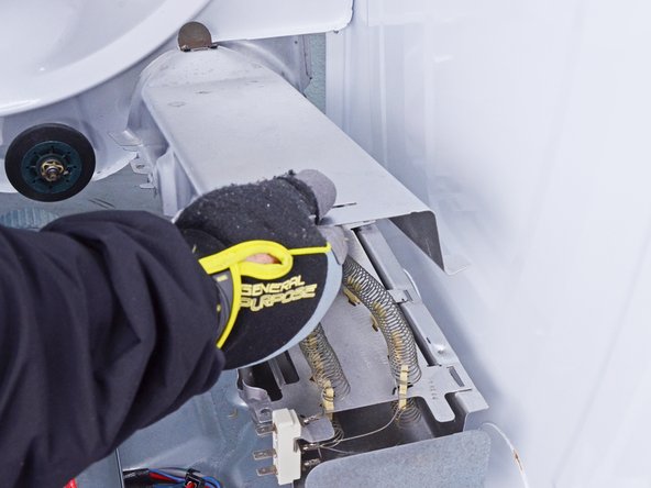

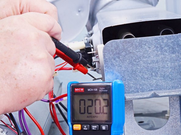

  41. Whirlpool WED87HED Dryer Heating Element Testing and Replacement, Heating element information: crwdns2935265:041crwdnd2935265:01crwdnd2935265:02crwdne2935265:0 Whirlpool WED87HED Dryer Heating Element Testing and Replacement, Heating element information: crwdns2935265:041crwdnd2935265:02crwdnd2935265:02crwdne2935265:0
    • The next four steps show disconnecting the heating element.

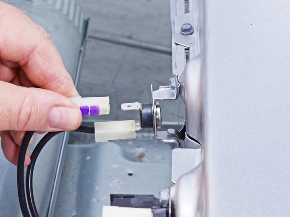

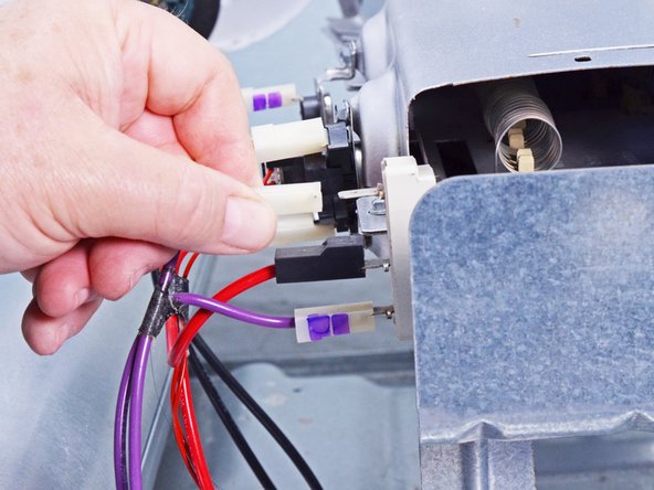

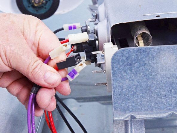

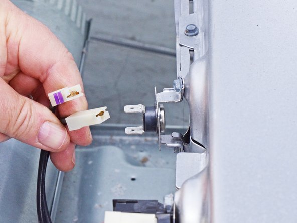

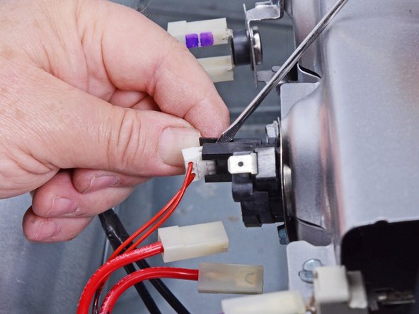

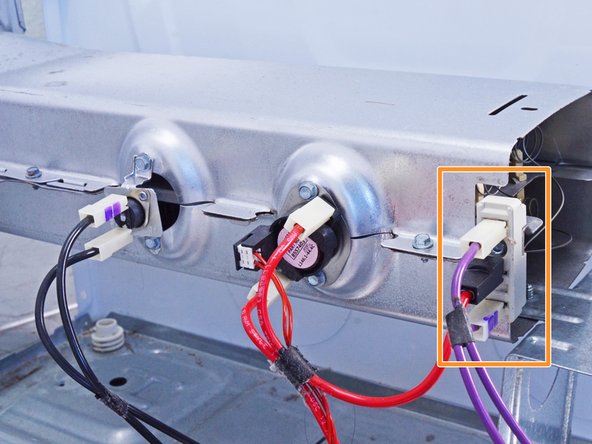

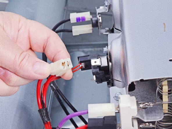

  42. Whirlpool WED87HED Dryer Heating Element Testing and Replacement, Disconnect the heating element: crwdns2935265:042crwdnd2935265:01crwdnd2935265:03crwdne2935265:0 Whirlpool WED87HED Dryer Heating Element Testing and Replacement, Disconnect the heating element: crwdns2935265:042crwdnd2935265:02crwdnd2935265:03crwdne2935265:0 Whirlpool WED87HED Dryer Heating Element Testing and Replacement, Disconnect the heating element: crwdns2935265:042crwdnd2935265:03crwdnd2935265:03crwdne2935265:0
    • Disconnect the three spade connectors attached to the heating element.
    • Note the locations of the spade connectors.

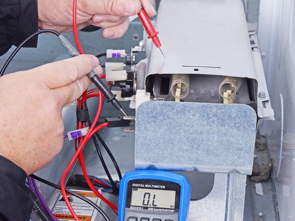

  43. Whirlpool WED87HED Dryer Heating Element Testing and Replacement, Test the heating element: crwdns2935265:043crwdnd2935265:01crwdnd2935265:02crwdne2935265:0 Whirlpool WED87HED Dryer Heating Element Testing and Replacement, Test the heating element: crwdns2935265:043crwdnd2935265:02crwdnd2935265:02crwdne2935265:0
    • These steps will require a multimeter. If you aren't familiar with how to use one, here is a guide that will help you
    • You will first check the resistance between the middle common terminal and each of the element terminals.
    • The resistance should be about 20 ohms (Ω). If the resistance is less than 18 Ω, or greater than 25 Ω, you should replace the element.
  44. Whirlpool WED87HED Dryer Heating Element Testing and Replacement: crwdns2935265:044crwdnd2935265:01crwdnd2935265:02crwdne2935265:0 Whirlpool WED87HED Dryer Heating Element Testing and Replacement: crwdns2935265:044crwdnd2935265:02crwdnd2935265:02crwdne2935265:0
    • Check the resistance between the top and bottom terminals.
    • The multimeter should read about 40 Ω.
    • Check resistance from the middle terminal to the heater housing.
    • The multimeter should read OL or "—"
    • If the element has the correct values when tested, you can stop here. You don't have to replace the heating element. As a precaution, while everything is accessible, you may want to test the components located on the heater housing.

  45. Whirlpool WED87HED Dryer Heating Element Testing and Replacement, Hi-limit thermostat/inlet thermistor information: crwdns2935265:045crwdnd2935265:01crwdnd2935265:02crwdne2935265:0 Whirlpool WED87HED Dryer Heating Element Testing and Replacement, Hi-limit thermostat/inlet thermistor information: crwdns2935265:045crwdnd2935265:02crwdnd2935265:02crwdne2935265:0
    • The next four steps show how to disconnect and remove the hi-limit thermostat and inlet thermistor.
    • The hi-limit thermostat and inlet thermistor are housed in one unit. Some dryers may not have an inlet thermistor.
  46. Whirlpool WED87HED Dryer Heating Element Testing and Replacement, Disconnect the hi-limit thermostat/inlet thermistor unit: crwdns2935265:046crwdnd2935265:01crwdnd2935265:03crwdne2935265:0 Whirlpool WED87HED Dryer Heating Element Testing and Replacement, Disconnect the hi-limit thermostat/inlet thermistor unit: crwdns2935265:046crwdnd2935265:02crwdnd2935265:03crwdne2935265:0 Whirlpool WED87HED Dryer Heating Element Testing and Replacement, Disconnect the hi-limit thermostat/inlet thermistor unit: crwdns2935265:046crwdnd2935265:03crwdnd2935265:03crwdne2935265:0
    • Pull the spade connectors straight off to disconnect the hi-limit thermostat portion of the hi-limit thermostat/inlet thermistor unit.
  47. Whirlpool WED87HED Dryer Heating Element Testing and Replacement, Disconnect the inlet thermistor: crwdns2935265:047crwdnd2935265:01crwdnd2935265:02crwdne2935265:0 Whirlpool WED87HED Dryer Heating Element Testing and Replacement, Disconnect the inlet thermistor: crwdns2935265:047crwdnd2935265:02crwdnd2935265:02crwdne2935265:0
    • Free the inlet thermistor connector by lifting the black locking tab with a small flathead screwdriver or spudger.
    • The black locking tab is fragile, so only lift it a small amount to free the connector. Make sure to grasp the connector, not the wires when removing them.
    • Once freed, pull the connector straight out to disconnect the inlet thermistor.

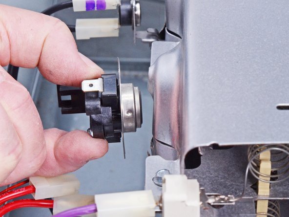

  48. Whirlpool WED87HED Dryer Heating Element Testing and Replacement, Unfasten the hi-limit thermostat/ inlet thermistor: crwdns2935265:048crwdnd2935265:01crwdnd2935265:01crwdne2935265:0
    • Use a 1/4 inch nut driver to remove the two 12.8 mm long sheet metal screws securing the hi-limit thermostat/inlet thermistor unit.
  49. Whirlpool WED87HED Dryer Heating Element Testing and Replacement, Remove the hi limit thermostat/ inlet thermistor: crwdns2935265:049crwdnd2935265:01crwdnd2935265:02crwdne2935265:0 Whirlpool WED87HED Dryer Heating Element Testing and Replacement, Remove the hi limit thermostat/ inlet thermistor: crwdns2935265:049crwdnd2935265:02crwdnd2935265:02crwdne2935265:0
    • Remove the unit by pulling it straight out from the mounting hole.
    • Note the orientation with the thermistor connector to the rear of the machine for reassembly.
  50. Whirlpool WED87HED Dryer Heating Element Testing and Replacement, Thermal cutoff switch information: crwdns2935265:050crwdnd2935265:01crwdnd2935265:02crwdne2935265:0 Whirlpool WED87HED Dryer Heating Element Testing and Replacement, Thermal cutoff switch information: crwdns2935265:050crwdnd2935265:02crwdnd2935265:02crwdne2935265:0
    • The following three steps show how to remove the thermal cutoff switch.

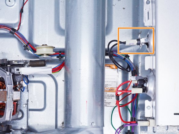

  51. Whirlpool WED87HED Dryer Heating Element Testing and Replacement, Disconnect the thermal cutoff switch: crwdns2935265:051crwdnd2935265:01crwdnd2935265:03crwdne2935265:0 Whirlpool WED87HED Dryer Heating Element Testing and Replacement, Disconnect the thermal cutoff switch: crwdns2935265:051crwdnd2935265:02crwdnd2935265:03crwdne2935265:0 Whirlpool WED87HED Dryer Heating Element Testing and Replacement, Disconnect the thermal cutoff switch: crwdns2935265:051crwdnd2935265:03crwdnd2935265:03crwdne2935265:0
    • Pull the two thermal cutoff switch spade connectors straight out of their slots to disconnect them.
    • Make sure to grasp the connectors and not the wires when disconnecting.

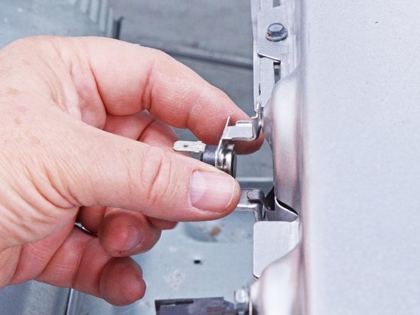

  52. Whirlpool WED87HED Dryer Heating Element Testing and Replacement, Unfasten the thermal cutoff switch: crwdns2935265:052crwdnd2935265:01crwdnd2935265:03crwdne2935265:0 Whirlpool WED87HED Dryer Heating Element Testing and Replacement, Unfasten the thermal cutoff switch: crwdns2935265:052crwdnd2935265:02crwdnd2935265:03crwdne2935265:0 Whirlpool WED87HED Dryer Heating Element Testing and Replacement, Unfasten the thermal cutoff switch: crwdns2935265:052crwdnd2935265:03crwdnd2935265:03crwdne2935265:0
    • Use a 1/4 inch nut driver to remove the two 12.8 mm-length sheet metal screws securing the thermal cutoff switch.
    • Note the orientation of the part, as there is a tab on the lower part of the heater housing that allows the part to fit properly only one way. The screw tabs are angled slightly to facilitate this.

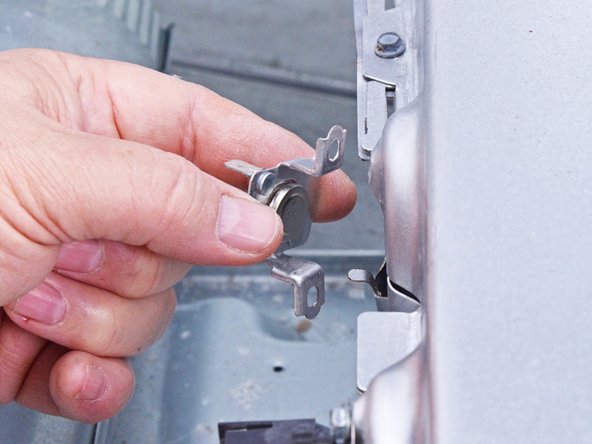

  53. Whirlpool WED87HED Dryer Heating Element Testing and Replacement, Remove the thermal cutoff switch: crwdns2935265:053crwdnd2935265:01crwdnd2935265:02crwdne2935265:0 Whirlpool WED87HED Dryer Heating Element Testing and Replacement, Remove the thermal cutoff switch: crwdns2935265:053crwdnd2935265:02crwdnd2935265:02crwdne2935265:0
    • Remove the thermal cutoff switch by lifting it off of the heater housing.
  54. Whirlpool WED87HED Dryer Heating Element Testing and Replacement, Unfasten the heater housing cover: crwdns2935265:054crwdnd2935265:01crwdnd2935265:01crwdne2935265:0
    • Use a 1/4 inch nut driver to remove the four 12.8 mm‑long sheet metal screws securing the heater housing cover.

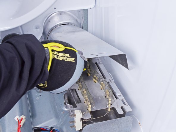

  55. Whirlpool WED87HED Dryer Heating Element Testing and Replacement, Remove the heater housing cover: crwdns2935265:055crwdnd2935265:01crwdnd2935265:03crwdne2935265:0 Whirlpool WED87HED Dryer Heating Element Testing and Replacement, Remove the heater housing cover: crwdns2935265:055crwdnd2935265:02crwdnd2935265:03crwdne2935265:0 Whirlpool WED87HED Dryer Heating Element Testing and Replacement, Remove the heater housing cover: crwdns2935265:055crwdnd2935265:03crwdnd2935265:03crwdne2935265:0
    • Put on gloves before continuing, as the heater housing cover is sharp
    • Lift the front of the heater housing cover to release the tabs securing it to the inlet housing pipe.
    • Make sure to lift the end of the cover well up so that you can get this tab to come free. Also the tabs on the side of the housing can stick in the slots.
    • Remove the heater housing cover.
    • During reassembly, make sure all the tabs on the cover have gone all the way through the slots on the sides of the housing and on the heating element. It will snap into place when it is correct.

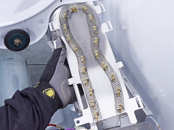

  56. Whirlpool WED87HED Dryer Heating Element Testing and Replacement, Remove the heating element: crwdns2935265:056crwdnd2935265:01crwdnd2935265:03crwdne2935265:0 Whirlpool WED87HED Dryer Heating Element Testing and Replacement, Remove the heating element: crwdns2935265:056crwdnd2935265:02crwdnd2935265:03crwdne2935265:0 Whirlpool WED87HED Dryer Heating Element Testing and Replacement, Remove the heating element: crwdns2935265:056crwdnd2935265:03crwdnd2935265:03crwdne2935265:0
    • Lift the heating element out of the slots in the lower part of the heater housing.
    • Remove the heating element.
