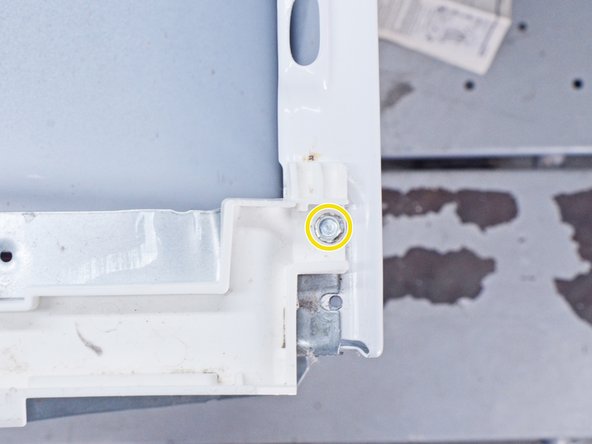

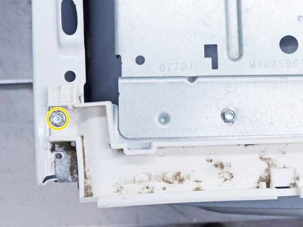

    • Throughout this guide, keep track of each screw and reinstall it exactly where it came from.
    • Use a 5/16 inch nut driver to remove the two 15.7 mm-long screws securing the top panel to the rear panel bracket.

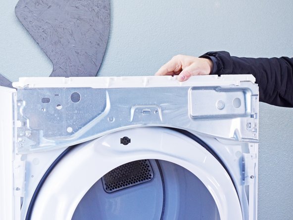

  3. Whirlpool WED87HED Dryer Hi-Limit Thermostat/Inlet Thermistor Testing and Replacement, Remove the top panel: crwdns2935265:03crwdnd2935265:01crwdnd2935265:02crwdne2935265:0 Whirlpool WED87HED Dryer Hi-Limit Thermostat/Inlet Thermistor Testing and Replacement, Remove the top panel: crwdns2935265:03crwdnd2935265:02crwdnd2935265:02crwdne2935265:0
    • Grasp the top and slide it 1/2 to 1 inch toward the rear of the machine.

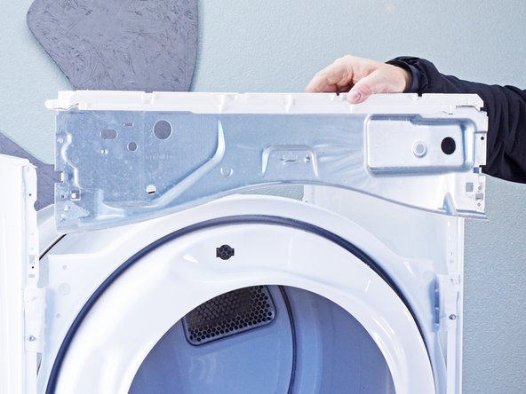

  4. Whirlpool WED87HED Dryer Hi-Limit Thermostat/Inlet Thermistor Testing and Replacement: crwdns2935265:04crwdnd2935265:01crwdnd2935265:02crwdne2935265:0 Whirlpool WED87HED Dryer Hi-Limit Thermostat/Inlet Thermistor Testing and Replacement: crwdns2935265:04crwdnd2935265:02crwdnd2935265:02crwdne2935265:0
    • Lift the top panel upward to separate it from the chassis.
    • Remove the top panel from the machine.

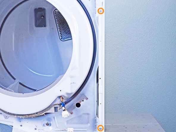

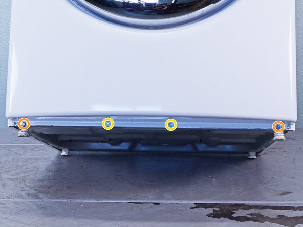

    • Use a 1/4 inch nut driver to remove the three upper front panel 16.4 mm-long sheet metal screws.
    • Tilt the machine backwards and prop it securely, or have a friend hold it.
    • Use a 1/4 inch nut driver to remove the four sheet metal screws on the bottom edge of the panel:
    • Two 16.4 mm screws
    • Two 13 mm screws

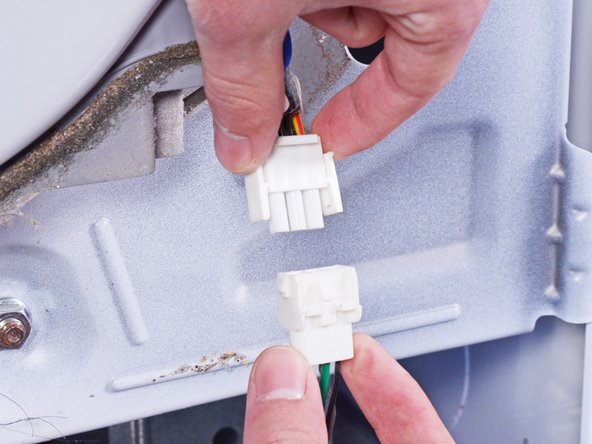

    • Squeeze the locking tabs on the moisture sensor connector.
    • Disconnect the connector.

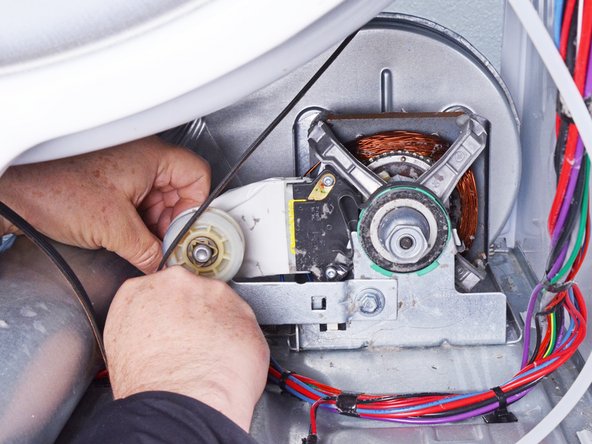

    • Take careful note of the belt path before proceeding.
    • Be very careful during this step! The idler arm is under spring tension and may pinch you, or it could damage the belt switch if the arm is allowed to snap down.
    • Push the idler arm (the metal upside-down "L") up to relieve the tension on the drive belt.
    • Remove the belt from the motor pulley.
    • Gently lower the idler arm until it rests parallel to the dryer floor.
    • During reassembly, refer to your notes or the belt path link to rethread the drive belt.

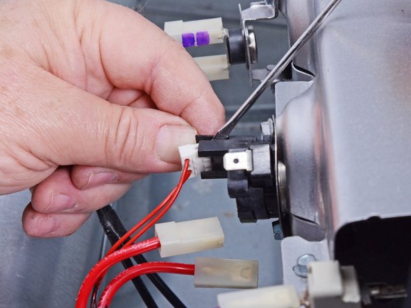

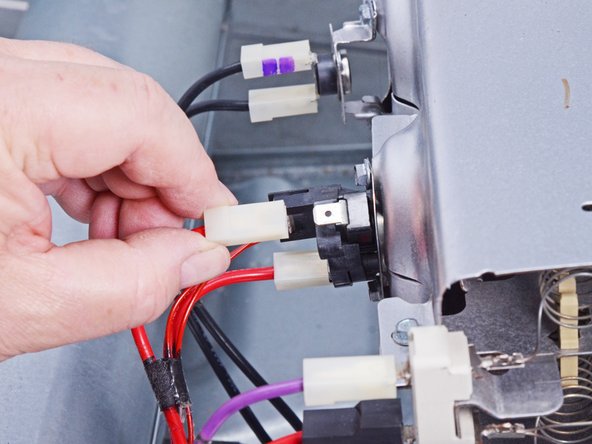

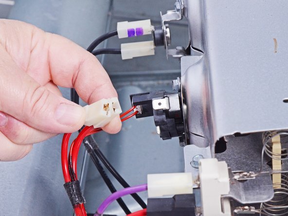

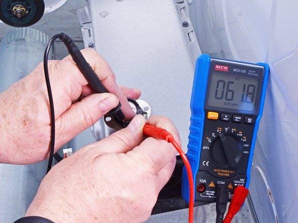

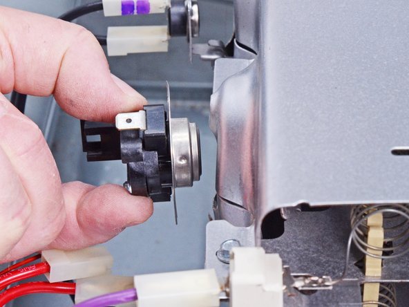

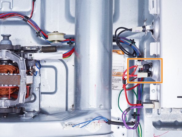

    • The following steps show how to test and replace the hi-limit thermostat/ inlet thermistor.
  42. Whirlpool WED87HED Dryer Hi-Limit Thermostat/Inlet Thermistor Testing and Replacement, Disconnect the hi-limit thermostat/inlet thermistor: crwdns2935265:042crwdnd2935265:01crwdnd2935265:03crwdne2935265:0 Whirlpool WED87HED Dryer Hi-Limit Thermostat/Inlet Thermistor Testing and Replacement, Disconnect the hi-limit thermostat/inlet thermistor: crwdns2935265:042crwdnd2935265:02crwdnd2935265:03crwdne2935265:0 Whirlpool WED87HED Dryer Hi-Limit Thermostat/Inlet Thermistor Testing and Replacement, Disconnect the hi-limit thermostat/inlet thermistor: crwdns2935265:042crwdnd2935265:03crwdnd2935265:03crwdne2935265:0
    • Pull the spade connectors straight off to disconnect the hi-limit thermostat portion of the hi-limit thermostat/inlet thermistor.

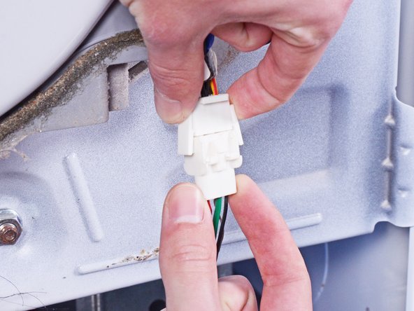

    • Be sure to grip the connectors and not the wire when disconnecting.
  43. Whirlpool WED87HED Dryer Hi-Limit Thermostat/Inlet Thermistor Testing and Replacement, Test the hi-limit thermostat: crwdns2935265:043crwdnd2935265:01crwdnd2935265:01crwdne2935265:0
    • If you do not need to test the hi-limit thermostat, skip this step.
    • This step requires a multimeter. If you aren't familiar with how to use one, here is a guide that will help you.
    • With the hi-limit thermostat disconnected, you can check it for continuity. It should show continuity (less than 1 Ω) at room temperature.
    • If it shows OL or anything above 1 Ω, replace it.
  44. Whirlpool WED87HED Dryer Hi-Limit Thermostat/Inlet Thermistor Testing and Replacement, Disconnect the inlet thermistor: crwdns2935265:044crwdnd2935265:01crwdnd2935265:02crwdne2935265:0 Whirlpool WED87HED Dryer Hi-Limit Thermostat/Inlet Thermistor Testing and Replacement, Disconnect the inlet thermistor: crwdns2935265:044crwdnd2935265:02crwdnd2935265:02crwdne2935265:0
    • Free the inlet thermistor connector by lifting the black locking tab with a small flathead screwdriver or spudger.
    • The locking tab is fragile, so only lift it a small amount to free the connector. Make sure to grasp the connector, not the wires when disconnecting them.
    • Once freed, pull the connector straight out to disconnect the inlet thermistor.

  47. Whirlpool WED87HED Dryer Hi-Limit Thermostat/Inlet Thermistor Testing and Replacement, Test the inlet thermistor: crwdns2935265:047crwdnd2935265:01crwdnd2935265:02crwdne2935265:0 Whirlpool WED87HED Dryer Hi-Limit Thermostat/Inlet Thermistor Testing and Replacement, Test the inlet thermistor: crwdns2935265:047crwdnd2935265:02crwdnd2935265:02crwdne2935265:0
    • This step shows how to test the inlet thermistor. If you just need to replace the hi-limit thermostat or inlet thermistor, you can skip this step.
    • With the thermistor removed from the heater housing, test for resistance with the multimeter across the two small terminals.
    • The value shown (61.8 kΩ) is acceptable for a good thermistor at room temperature (68°F/20°C). The nominal range at this temperature is 61.2‑63.7 kΩ.
    • If the device shows outside this range, replace it.
