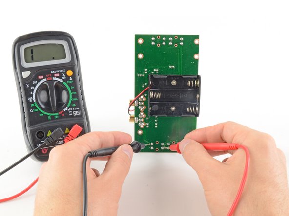

      • A continuity test tells us whether two things are electrically connected: if something is continuous, an electric current can flow freely from one end to the other.
      • If there's no continuity, it means there is a break somewhere in the circuit. This could indicate anything from a blown fuse or bad solder joint to an incorrectly wired circuit.
      • Continuity is one of the most useful tests for electronics repair.

    5. How To Use A Multimeter: crwdns2935265:05crwdnd2935265:01crwdnd2935265:02crwdne2935265:0 How To Use A Multimeter: crwdns2935265:05crwdnd2935265:02crwdnd2935265:02crwdne2935265:0
      • To complete your continuity test, place one probe at each end of the circuit or component you want to test.
      • As before, if your circuit is continuous, the screen displays a value of zero (or near zero), and the multimeter beeps.
      • If the screen displays 1 or OL (open loop), there's no continuity—that is, there's no path for electric current to flow from one probe to the other.
      • Continuity is non-directional, meaning it doesn't matter which probe goes where. But there are exceptions—for instance, if there's a diode in your circuit. A diode is like a one-way valve for electricity, meaning it will show continuity in one direction, but not in the other.
      • To check for this, reverse what the probes are touching and check for continuity. If the multimeter shows continuity, then it's possibly a diode.

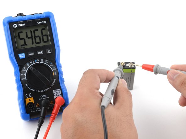

    10. How To Use A Multimeter: crwdns2935265:010crwdnd2935265:01crwdnd2935265:02crwdne2935265:0 How To Use A Multimeter: crwdns2935265:010crwdnd2935265:02crwdnd2935265:02crwdne2935265:0
      • Switch on your multimeter, and set the dial to DC voltage mode (indicated by a V with a straight line, or the symbol ⎓).
      • Virtually all consumer electronic devices run on DC voltage. AC voltage—the kind that runs through the lines to your house—is considerably more dangerous, and beyond the scope of this guide.
      • Your multimeter may be auto-ranging or manual ranging. An auto-ranging multimeter (such as the iFixit multimeter) will automatically determine the best measuring range. All you have to do is set what kind of measurement you want to take.
      • If your multimeter is manual ranging, you'll also need to set the correct range for the voltage you expect to measure.
      • Each setting on the dial lists the maximum voltage it can measure. So for example, if you expect to measure more than 2 volts but less than 20, use the 20 volt setting.
      • If you're not sure, start with the highest setting.

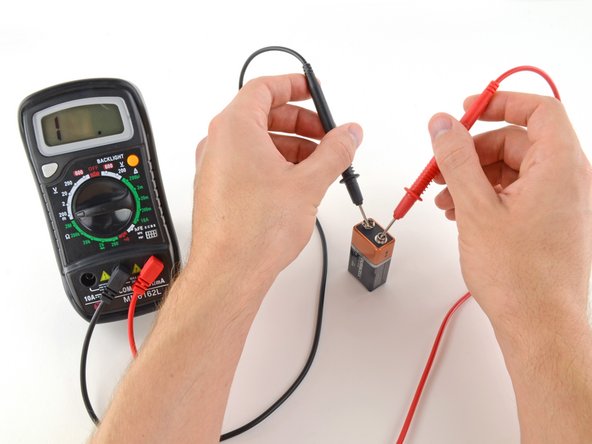

    11. How To Use A Multimeter, Auto-ranging voltage measurement: crwdns2935265:011crwdnd2935265:01crwdnd2935265:02crwdne2935265:0 How To Use A Multimeter, Auto-ranging voltage measurement: crwdns2935265:011crwdnd2935265:02crwdnd2935265:02crwdne2935265:0
      • If your multimeter is manual ranging, skip to the next step.
      • Place the red probe on the positive terminal, and the black probe on the negative terminal. The multimeter will display the measured voltage.
      • Reversing the probes won't do any harm; it just gives a negative reading.
      • Skip the next step, which describes how to measure voltage using manual ranging multimeters.
    12. How To Use A Multimeter, Manual ranging voltage measurement: crwdns2935265:012crwdnd2935265:01crwdnd2935265:03crwdne2935265:0 How To Use A Multimeter, Manual ranging voltage measurement: crwdns2935265:012crwdnd2935265:02crwdnd2935265:03crwdne2935265:0 How To Use A Multimeter, Manual ranging voltage measurement: crwdns2935265:012crwdnd2935265:03crwdnd2935265:03crwdne2935265:0
      • Follow this step to measure voltage with a manual ranging multimeter.
      • If your range was set too high, you may not get a very precise reading. Here the multimeter reads 9 volts. That's fine, but we can turn the dial to a lower range to get a more precise.
      • If you set the range too low, the multimeter simply reads 1 or OL, indicating that it is overloaded or out of range. This won't hurt the multimeter, but we need to set the dial to a higher range.
      • With the range set correctly, we get a reading of 9.42 volts.
      • Reversing the probes won't do any harm; it just gives us a negative reading.
