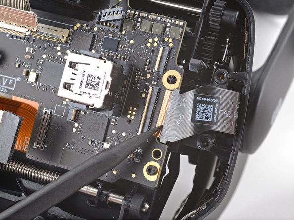

    • Use a spudger to unlock the ZIF connector at the top-left corner of the motherboard.
    • Disconnect the FPC ribbon cable from the motherboard.

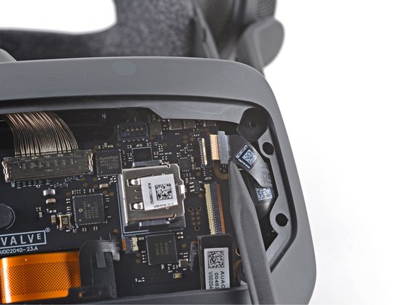

  16. Valve Index Headset Eye Tube Replacement: crwdns2935265:016crwdnd2935265:01crwdnd2935265:03crwdne2935265:0 Valve Index Headset Eye Tube Replacement: crwdns2935265:016crwdnd2935265:02crwdnd2935265:03crwdne2935265:0 Valve Index Headset Eye Tube Replacement: crwdns2935265:016crwdnd2935265:03crwdnd2935265:03crwdne2935265:0
    • Use a spudger to unlock the ZIF connector at the top-right corner of the motherboard.
    • Disconnect the FPC ribbon cable.

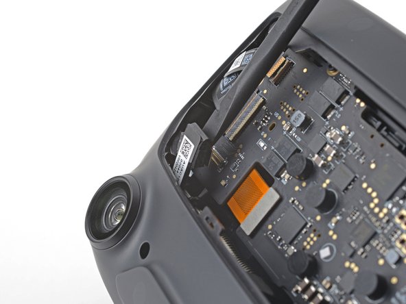

  17. Valve Index Headset Eye Tube Replacement: crwdns2935265:017crwdnd2935265:01crwdnd2935265:02crwdne2935265:0 Valve Index Headset Eye Tube Replacement: crwdns2935265:017crwdnd2935265:02crwdnd2935265:02crwdne2935265:0
    • Use the flat end of a spudger to disconnect the press connector from the bottom-left corner of the motherboard.
    • To re-attach press connectors like this one, carefully align and press down on one side until it clicks into place, then repeat on the other side. Do not press down on the middle. If the connector is misaligned, the pins can bend, causing permanent damage.
  18. Valve Index Headset Eye Tube Replacement: crwdns2935265:018crwdnd2935265:01crwdnd2935265:02crwdne2935265:0 Valve Index Headset Eye Tube Replacement: crwdns2935265:018crwdnd2935265:02crwdnd2935265:02crwdne2935265:0
    • Use the flat end of a spudger to disconnect the press connector from the bottom-right corner of the motherboard.

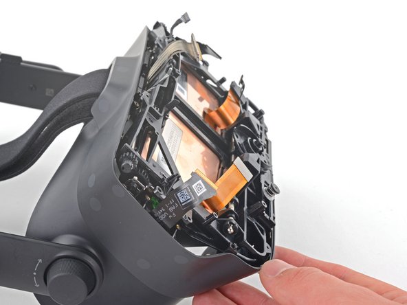

    • Insert an opening pick in between the front fascia and the headset.
    • Slide the opening pick over to separate the front fascia from the headset.
  20. Valve Index Headset Eye Tube Replacement: crwdns2935265:020crwdnd2935265:01crwdnd2935265:02crwdne2935265:0 Valve Index Headset Eye Tube Replacement: crwdns2935265:020crwdnd2935265:02crwdnd2935265:02crwdne2935265:0
    • Continue sliding the opening pick along the perimeter of the front fascia until all edges are free.
  21. Valve Index Headset Eye Tube Replacement: crwdns2935265:021crwdnd2935265:01crwdnd2935265:02crwdne2935265:0 Valve Index Headset Eye Tube Replacement: crwdns2935265:021crwdnd2935265:02crwdnd2935265:02crwdne2935265:0
    • Remove the front fascia.
  22. Valve Index Headset Eye Tube Replacement, Remove the motherboard: crwdns2935265:022crwdnd2935265:01crwdnd2935265:01crwdne2935265:0
    • Note the seven cables that must be disconnected in the following steps before the motherboard can be removed.
  23. Valve Index Headset Eye Tube Replacement: crwdns2935265:023crwdnd2935265:01crwdnd2935265:03crwdne2935265:0 Valve Index Headset Eye Tube Replacement: crwdns2935265:023crwdnd2935265:02crwdnd2935265:03crwdne2935265:0 Valve Index Headset Eye Tube Replacement: crwdns2935265:023crwdnd2935265:03crwdnd2935265:03crwdne2935265:0
    • Use the flat end of a spudger to unlock the wide ZIF connector on the left side of the motherboard.

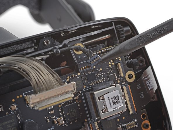

    • Use the pointed end of a spudger to gently disconnect the bundled cable connector from the top-right corner of the motherboard.

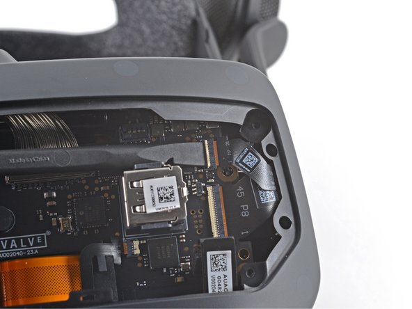

  27. Valve Index Headset Eye Tube Replacement: crwdns2935265:027crwdnd2935265:01crwdnd2935265:03crwdne2935265:0 Valve Index Headset Eye Tube Replacement: crwdns2935265:027crwdnd2935265:02crwdnd2935265:03crwdne2935265:0 Valve Index Headset Eye Tube Replacement: crwdns2935265:027crwdnd2935265:03crwdnd2935265:03crwdne2935265:0
    • Use the pointed end of a spudger to unlock the ZIF connector next to the USB port on the motherboard.
    • Disconnect the FPC cable from the motherboard.
    • During reassembly, make sure this ribbon cable is not trapped under the motherboard.
  28. Valve Index Headset Eye Tube Replacement: crwdns2935265:028crwdnd2935265:01crwdnd2935265:02crwdne2935265:0 Valve Index Headset Eye Tube Replacement: crwdns2935265:028crwdnd2935265:02crwdnd2935265:02crwdne2935265:0
    • Use the flat end of a spudger to disconnect the press connector below the USB port on the motherboard.
    • During reassembly, make sure this cable is not trapped under the motherboard.

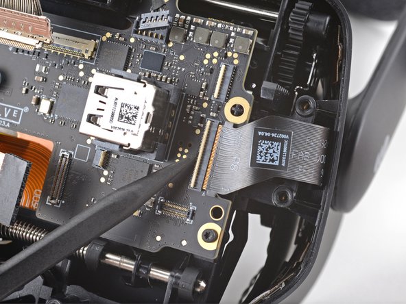

  29. Valve Index Headset Eye Tube Replacement: crwdns2935265:029crwdnd2935265:01crwdnd2935265:03crwdne2935265:0 Valve Index Headset Eye Tube Replacement: crwdns2935265:029crwdnd2935265:02crwdnd2935265:03crwdne2935265:0 Valve Index Headset Eye Tube Replacement: crwdns2935265:029crwdnd2935265:03crwdnd2935265:03crwdne2935265:0
    • Use a spudger to unlock the wide ZIF connector near the right edge of the motherboard.

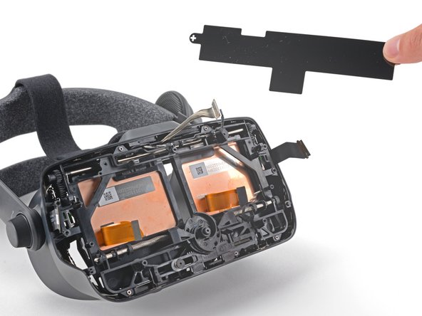

  32. Valve Index Headset Eye Tube Replacement, Remove the motherboard shield: crwdns2935265:032crwdnd2935265:01crwdnd2935265:02crwdne2935265:0 Valve Index Headset Eye Tube Replacement, Remove the motherboard shield: crwdns2935265:032crwdnd2935265:02crwdnd2935265:02crwdne2935265:0
    • Lift the motherboard shield off of the two cross-shaped alignment pegs.

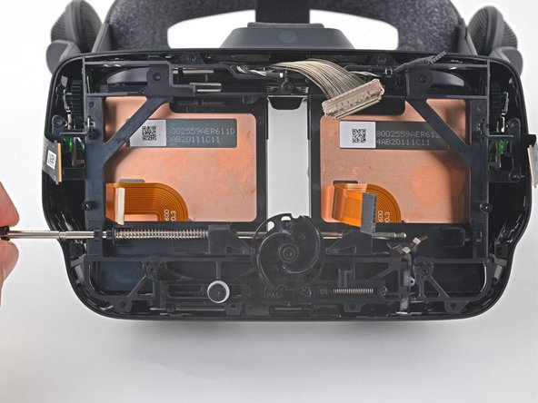

  35. Valve Index Headset Eye Tube Replacement, Remove the upper eye tube rail: crwdns2935265:035crwdnd2935265:01crwdnd2935265:01crwdne2935265:0

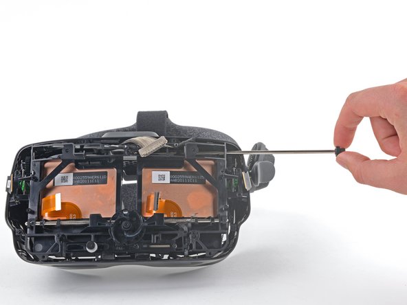

    • Use a T5 Torx screwdriver to remove the five 4.5 mm screws securing the midframe.
  36. Valve Index Headset Eye Tube Replacement: crwdns2935265:036crwdnd2935265:01crwdnd2935265:02crwdne2935265:0 Valve Index Headset Eye Tube Replacement: crwdns2935265:036crwdnd2935265:02crwdnd2935265:02crwdne2935265:0
    • With the midframe loose, slide the case towards the back of the headset to expose the eye tube rails.
  37. Valve Index Headset Eye Tube Replacement: crwdns2935265:037crwdnd2935265:01crwdnd2935265:01crwdne2935265:0
    • Use a T5 Torx screwdriver to remove the 4.4 mm screw securing the left end gear to the eye tube rail.
    • If the screw is not accessible, turn the eye relief knob to rotate the gear until it faces outward.
  38. Valve Index Headset Eye Tube Replacement: crwdns2935265:038crwdnd2935265:01crwdnd2935265:01crwdne2935265:0
    • Remove the left end gear from the eye tube rail.

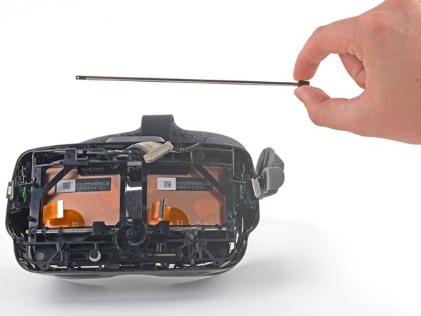

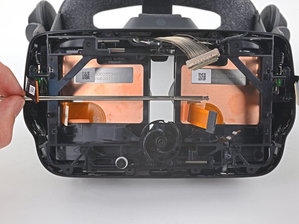

  39. Valve Index Headset Eye Tube Replacement: crwdns2935265:039crwdnd2935265:01crwdnd2935265:03crwdne2935265:0 Valve Index Headset Eye Tube Replacement: crwdns2935265:039crwdnd2935265:02crwdnd2935265:03crwdne2935265:0 Valve Index Headset Eye Tube Replacement: crwdns2935265:039crwdnd2935265:03crwdnd2935265:03crwdne2935265:0

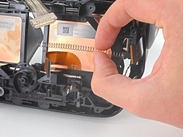

    • Grab the gear on the opposite side and slide the eye tube rail out of the headset.

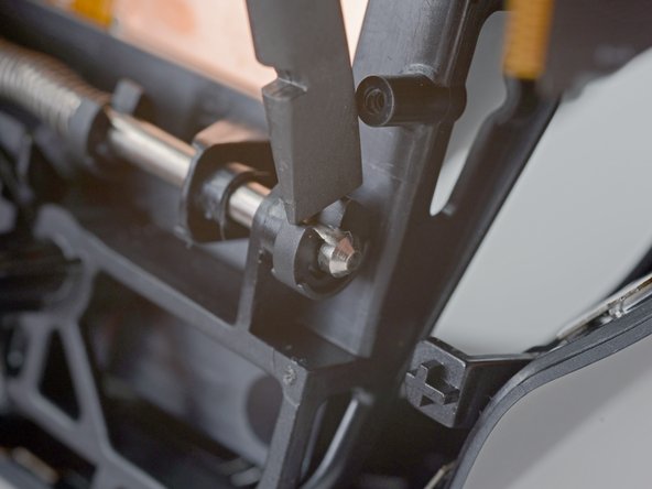

    • When removing the upper eye tube rail, two plastic bushing will fall out and two metal springs may fall out. Keep track of these parts.
    • During reassembly, slide the bushings back on to the eye tube rail and use a pair of tweezers to align the springs to their original positions.

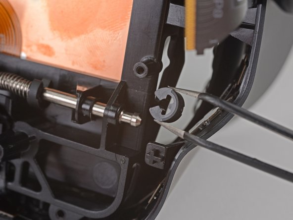

  40. Valve Index Headset Eye Tube Replacement, Remove the lower eye tube: crwdns2935265:040crwdnd2935265:01crwdnd2935265:03crwdne2935265:0 Valve Index Headset Eye Tube Replacement, Remove the lower eye tube: crwdns2935265:040crwdnd2935265:02crwdnd2935265:03crwdne2935265:0 Valve Index Headset Eye Tube Replacement, Remove the lower eye tube: crwdns2935265:040crwdnd2935265:03crwdnd2935265:03crwdne2935265:0
    • Use a spudger or your fingers to remove three of the four clips from the lower eye tube rail.
    • Hold the clips steady with one finger to prevent them from ejecting.
    • To reinstall these clips, place the open end on the groove in the rail and press them into place.
    • Two of the clips require holding the spring back to install them.
  41. Valve Index Headset Eye Tube Replacement: crwdns2935265:041crwdnd2935265:01crwdnd2935265:02crwdne2935265:0 Valve Index Headset Eye Tube Replacement: crwdns2935265:041crwdnd2935265:02crwdnd2935265:02crwdne2935265:0
    • Hold each spring with one hand to prevent them from ejecting as you slide the lower eye tube rail out.
    • During reassembly, slide the springs on to the rail and carefully "walk" them back with your fingers until they are entirely on the rail.

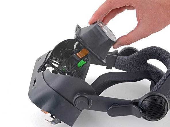

  43. Valve Index Headset Eye Tube Replacement, Remove the eye tube(s): crwdns2935265:043crwdnd2935265:01crwdnd2935265:02crwdne2935265:0 Valve Index Headset Eye Tube Replacement, Remove the eye tube(s): crwdns2935265:043crwdnd2935265:02crwdnd2935265:02crwdne2935265:0
    • Remove the eye tube(s).
    • The eye tubes are a tight fit and can be tricky to remove and install. Try different orientations as you work them in or out; do not force them.

I gained two extra small pieces not mentioned, I think when removing the top rail, they just dropped out into the housing. Looks like they go next to the eye tubes and are not included with the replacement so make sure you don't lose them!
https://imgur.com/a/AW4dHOW
Fizz - crwdns2934203:0crwdne2934203:0
I believe those are suppose to add tension to the top rail. I lost mine but it should be for a small metal spring tensioner (I think).
