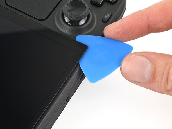

  2. Steam Deck OLED Screen Replacement, Mark your opening picks: crwdns2935265:02crwdnd2935265:01crwdnd2935265:03crwdne2935265:0 Steam Deck OLED Screen Replacement, Mark your opening picks: crwdns2935265:02crwdnd2935265:02crwdnd2935265:03crwdne2935265:0 Steam Deck OLED Screen Replacement, Mark your opening picks: crwdns2935265:02crwdnd2935265:03crwdnd2935265:03crwdne2935265:0
    • If inserted too far, an opening pick can damage your device. Follow this step to mark your pick and prevent damage.
    • Measure 3 mm from the tip and mark the opening pick with a permanent marker.
    • You can also mark the other corners of the pick with different measurements.
    • Alternatively, tape a coin to a pick 3 mm from the tip.

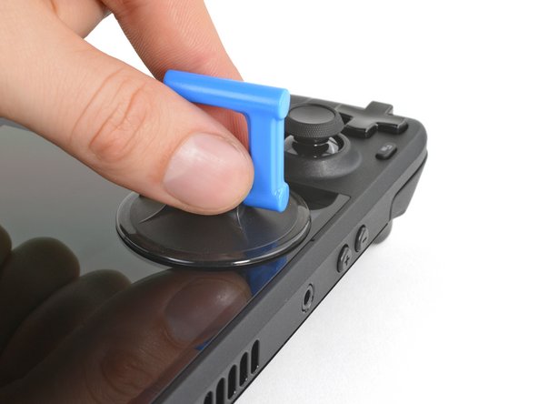

  4. Steam Deck OLED Screen Replacement, Apply a suction handle: crwdns2935265:04crwdnd2935265:01crwdnd2935265:02crwdne2935265:0 Steam Deck OLED Screen Replacement, Apply a suction handle: crwdns2935265:04crwdnd2935265:02crwdnd2935265:02crwdne2935265:0
    • Apply a suction handle to the top left corner of the screen, as close to the top edge as possible.
    • If your display is badly cracked, cover it with a layer of clear packing tape to help the suction cup adhere. Alternatively, you can pull using very strong tape instead of a suction cup. If all else fails, try supergluing the suction cup to the broken screen.

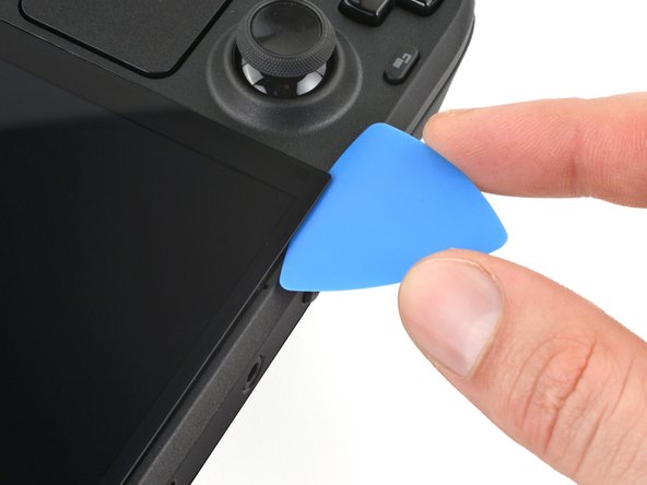

  5. Steam Deck OLED Screen Replacement, Insert an opening pick: crwdns2935265:05crwdnd2935265:01crwdnd2935265:03crwdne2935265:0 Steam Deck OLED Screen Replacement, Insert an opening pick: crwdns2935265:05crwdnd2935265:02crwdnd2935265:03crwdne2935265:0 Steam Deck OLED Screen Replacement, Insert an opening pick: crwdns2935265:05crwdnd2935265:03crwdnd2935265:03crwdne2935265:0
    • Pull up on the suction handle with a strong, steady force to create a gap between the screen and the frame.
    • Insert the tip of an opening pick into the gap.
    • Don't insert your pick deeper than 3 mm (~1/8 of an inch) to avoid damaging the screen panel, ambient light sensor, or sensor cable.

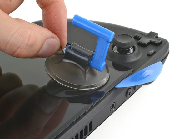

  6. Steam Deck OLED Screen Replacement, Remove the suction handle: crwdns2935265:06crwdnd2935265:01crwdnd2935265:02crwdne2935265:0 Steam Deck OLED Screen Replacement, Remove the suction handle: crwdns2935265:06crwdnd2935265:02crwdnd2935265:02crwdne2935265:0
    • Pull up on the nub on the back of the suction handle to remove it from the screen.
  7. Steam Deck OLED Screen Replacement, Screen information: crwdns2935265:07crwdnd2935265:01crwdnd2935265:03crwdne2935265:0 Steam Deck OLED Screen Replacement, Screen information: crwdns2935265:07crwdnd2935265:02crwdnd2935265:03crwdne2935265:0 Steam Deck OLED Screen Replacement, Screen information: crwdns2935265:07crwdnd2935265:03crwdnd2935265:03crwdne2935265:0
    • As you slice through the adhesive securing the screen, note the following:
    • Along the top and bottom edges, don't insert your pick deeper than 3 mm (~1/8 of an inch) to avoid damaging the sensors, sensors cable, or screen cable.
    • Along the left and right edges, don't insert your pick deeper than 5 mm (~1/5 of an inch) to avoid damaging the screen panel.

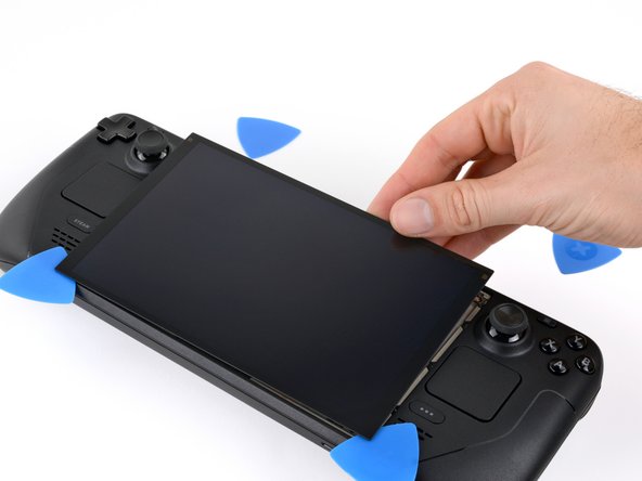

  15. Steam Deck OLED Screen Replacement, Lift the top edge of the screen: crwdns2935265:015crwdnd2935265:01crwdnd2935265:03crwdne2935265:0 Steam Deck OLED Screen Replacement, Lift the top edge of the screen: crwdns2935265:015crwdnd2935265:02crwdnd2935265:03crwdne2935265:0 Steam Deck OLED Screen Replacement, Lift the top edge of the screen: crwdns2935265:015crwdnd2935265:03crwdnd2935265:03crwdne2935265:0
    • Grip the two picks along the top edge.
    • Pry up to lift the top edge of the screen away from the frame until you can grab it.
    • If the screen feels stuck, go back around the perimeter and check for missed sections of adhesive. If you're using a hair dryer, use it to lightly heat the stuck sections of adhesive.
