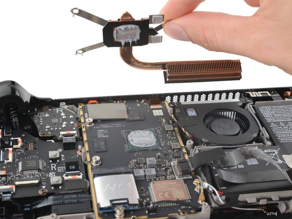

  15. Steam Deck OLED Heat Sink Replacement, Remove the heat sink screws: crwdns2935265:015crwdnd2935265:01crwdnd2935265:01crwdne2935265:0
    • Use your T6 Torx driver to remove the three 3.3 mm‑long screws securing the heat sink.
    • During reassembly, install the screws in the order marked on the heat sink mounts: 1, 2, then 3.
  16. Steam Deck OLED Heat Sink Replacement, Remove the heat sink: crwdns2935265:016crwdnd2935265:01crwdnd2935265:02crwdne2935265:0 Steam Deck OLED Heat Sink Replacement, Remove the heat sink: crwdns2935265:016crwdnd2935265:02crwdnd2935265:02crwdne2935265:0
    • Lift the heat sink from the motherboard and remove it.
    • Depending on the age of your device, this might require some force. A twisting motion may help loosen the thermal paste.
    • Before reinstalling the heat sink, follow this guide to clean the heat sink and APU and reapply thermal paste.
