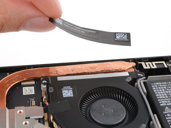

    1. Steam Deck OLED Fan Replacement, Disconnect the right button board: crwdns2935265:07crwdnd2935265:01crwdnd2935265:03crwdne2935265:0 Steam Deck OLED Fan Replacement, Disconnect the right button board: crwdns2935265:07crwdnd2935265:02crwdnd2935265:03crwdne2935265:0 Steam Deck OLED Fan Replacement, Disconnect the right button board: crwdns2935265:07crwdnd2935265:03crwdnd2935265:03crwdne2935265:0
      • Use a spudger to flip up the small white locking flap on the right button board interconnect cable ZIF connector.
      • Use tweezers or your fingers to grip the cable's pull tab and slide it straight out of its socket to disconnect it.
      • The pull tab may be labelled C‑R.
    2. Steam Deck OLED Fan Replacement, Separate the cable adhesive: crwdns2935265:08crwdnd2935265:01crwdnd2935265:03crwdne2935265:0 Steam Deck OLED Fan Replacement, Separate the cable adhesive: crwdns2935265:08crwdnd2935265:02crwdnd2935265:03crwdne2935265:0 Steam Deck OLED Fan Replacement, Separate the cable adhesive: crwdns2935265:08crwdnd2935265:03crwdnd2935265:03crwdne2935265:0
      • The interconnect cable is adhered to the motherboard shield.
      • Insert an opening pick between the interconnect cable and the motherboard shield.
      • Be careful not to crease or tear the cable.
      • If you're having trouble inserting a pick, lightly heat the cable using an iOpener or a hair dryer.
      • Slide your pick along the shield to separate the cable.
    3. Steam Deck OLED Fan Replacement, Move the interconnect cable: crwdns2935265:09crwdnd2935265:01crwdnd2935265:03crwdne2935265:0 Steam Deck OLED Fan Replacement, Move the interconnect cable: crwdns2935265:09crwdnd2935265:02crwdnd2935265:03crwdne2935265:0 Steam Deck OLED Fan Replacement, Move the interconnect cable: crwdns2935265:09crwdnd2935265:03crwdnd2935265:03crwdne2935265:0
      • During the rest of the repair, it may be helpful to move the interconnect cable over the battery and out of the way of the motherboard shield.
      • Be careful not to crease or strain the cable, as it's still adhered to the battery.
      • Tape the cable in place away from the motherboard shield.

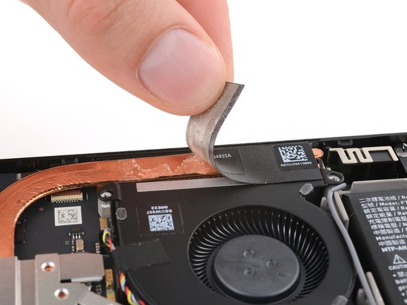

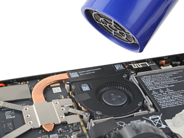

    1. Steam Deck OLED Fan Replacement, Soften the sticker adhesive: crwdns2935265:013crwdnd2935265:01crwdnd2935265:02crwdne2935265:0 Steam Deck OLED Fan Replacement, Soften the sticker adhesive: crwdns2935265:013crwdnd2935265:02crwdnd2935265:02crwdne2935265:0
    2. Steam Deck OLED Fan Replacement, Remove the heat sink sticker: crwdns2935265:014crwdnd2935265:01crwdnd2935265:03crwdne2935265:0 Steam Deck OLED Fan Replacement, Remove the heat sink sticker: crwdns2935265:014crwdnd2935265:02crwdnd2935265:03crwdne2935265:0 Steam Deck OLED Fan Replacement, Remove the heat sink sticker: crwdns2935265:014crwdnd2935265:03crwdnd2935265:03crwdne2935265:0
      • Try not to tear the heat sink sticker, as you'll reuse it during reassembly.
      • Slide the tip of an opening pick under one edge of the heat sink sticker.
      • Peel the sticker up until you can grab it with your fingers.
      • Gently remove the sticker from the heat sink and fan.
      • During reassembly, place the sticker back in its original location. The residual adhesive should stick well.
      • If the residual adhesive isn't sticky anymore, tape the outside edges of the sticker to the heat sink and fan with small strips of tape.

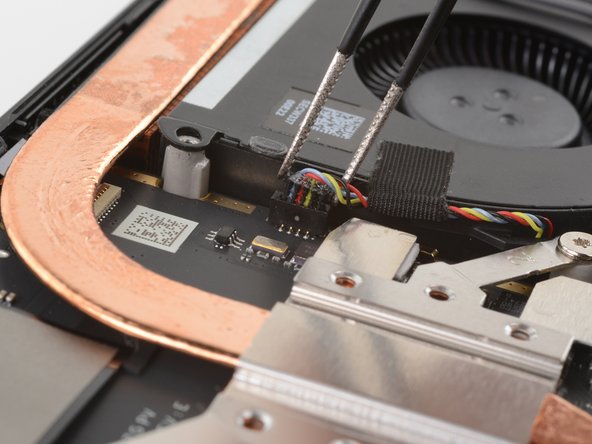

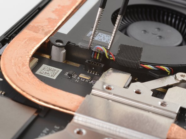

    1. Steam Deck OLED Fan Replacement, Disconnect the fan: crwdns2935265:015crwdnd2935265:01crwdnd2935265:03crwdne2935265:0 Steam Deck OLED Fan Replacement, Disconnect the fan: crwdns2935265:015crwdnd2935265:02crwdnd2935265:03crwdne2935265:0 Steam Deck OLED Fan Replacement, Disconnect the fan: crwdns2935265:015crwdnd2935265:03crwdnd2935265:03crwdne2935265:0
      • Use blunt nose tweezers to grip the edges of the fan connector and walk it side-to-side out of its socket to disconnect it.
      • Don't pull on the cables—only pull on the connector body.
      • During reassembly, insert the connector gently. Make sure the exposed colored wires within the connector face away from the fan.
      • Don't force the connector into the socket, as you might damage the fragile internal pins.

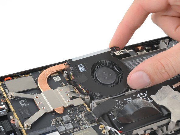

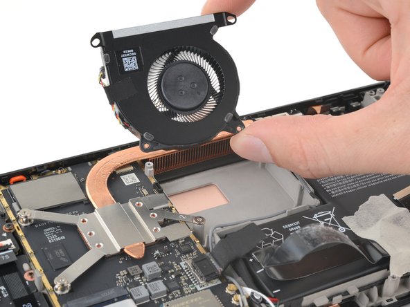

    2. Steam Deck OLED Fan Replacement, Remove the fan screws: crwdns2935265:016crwdnd2935265:01crwdnd2935265:01crwdne2935265:0
      • Use your T6 Torx driver to remove the two 3.8 mm‑long screws securing the fan.
      • Don't worry—you already removed the top two fan screws earlier in disassembly. They double as two of the back cover screws.
    3. Steam Deck OLED Fan Replacement, Remove the fan: crwdns2935265:017crwdnd2935265:01crwdnd2935265:03crwdne2935265:0 Steam Deck OLED Fan Replacement, Remove the fan: crwdns2935265:017crwdnd2935265:02crwdnd2935265:03crwdne2935265:0 Steam Deck OLED Fan Replacement, Remove the fan: crwdns2935265:017crwdnd2935265:03crwdnd2935265:03crwdne2935265:0
      • Lift the top edge of the fan from its recess in the midframe.
      • Remove the fan.
