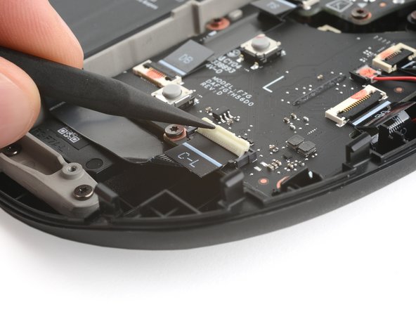

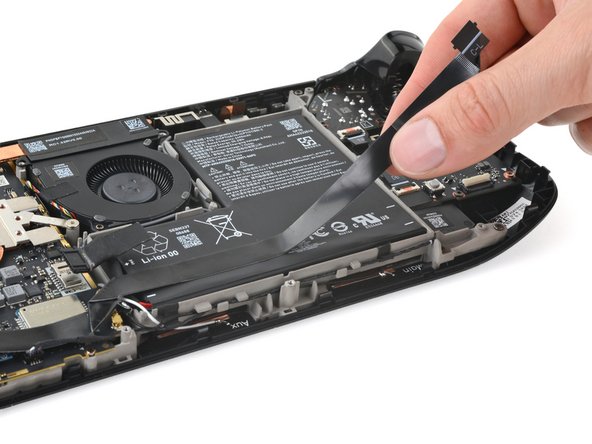

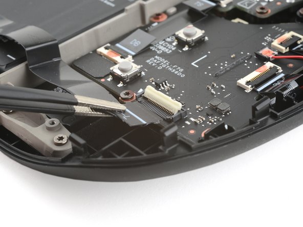

  13. Steam Deck OLED Battery Replacement, Disconnect the interconnect cable: crwdns2935265:013crwdnd2935265:01crwdnd2935265:03crwdne2935265:0 Steam Deck OLED Battery Replacement, Disconnect the interconnect cable: crwdns2935265:013crwdnd2935265:02crwdnd2935265:03crwdne2935265:0 Steam Deck OLED Battery Replacement, Disconnect the interconnect cable: crwdns2935265:013crwdnd2935265:03crwdnd2935265:03crwdne2935265:0
    • Use a spudger to flip up the small white locking flap on the left button board interconnect cable ZIF connector.
    • The pull tab on this connector may be labeled C‑L.
    • Use tweezers or your fingers to grip the cable's pull tab and slide it straight out of its socket to disconnect it.

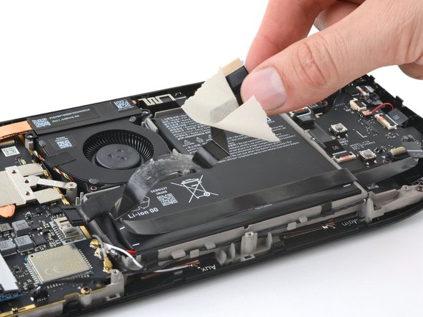

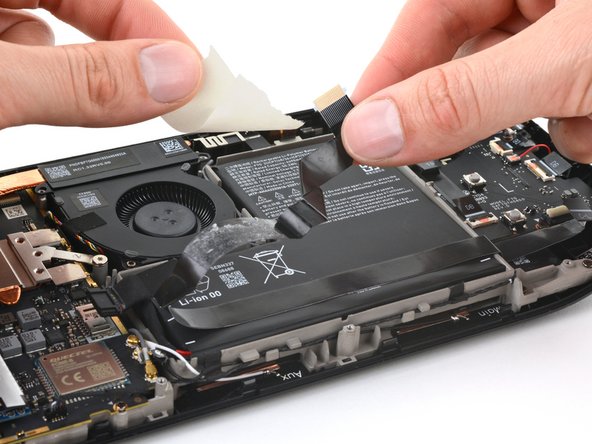

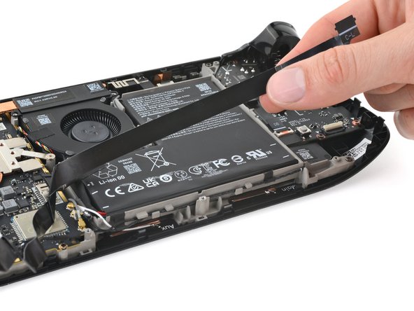

  14. Steam Deck OLED Battery Replacement, Remove the interconnect cable: crwdns2935265:014crwdnd2935265:01crwdnd2935265:03crwdne2935265:0 Steam Deck OLED Battery Replacement, Remove the interconnect cable: crwdns2935265:014crwdnd2935265:02crwdnd2935265:03crwdne2935265:0 Steam Deck OLED Battery Replacement, Remove the interconnect cable: crwdns2935265:014crwdnd2935265:03crwdnd2935265:03crwdne2935265:0
    • Peel the interconnect cable from the battery.
    • If you taped the cable in place, remove the tape.
  15. Steam Deck OLED Battery Replacement: crwdns2935265:015crwdnd2935265:01crwdnd2935265:03crwdne2935265:0 Steam Deck OLED Battery Replacement: crwdns2935265:015crwdnd2935265:02crwdnd2935265:03crwdne2935265:0 Steam Deck OLED Battery Replacement: crwdns2935265:015crwdnd2935265:03crwdnd2935265:03crwdne2935265:0
    • Grip one end of the interconnect cable and peel it at a low angle off the battery.
    • Be careful not to crease the cable.

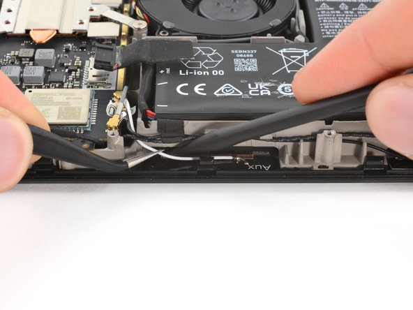

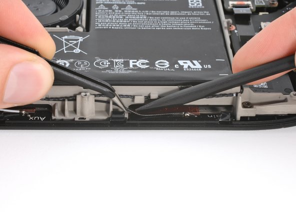

  17. Steam Deck OLED Battery Replacement, Reposition the antenna cables: crwdns2935265:017crwdnd2935265:01crwdnd2935265:03crwdne2935265:0 Steam Deck OLED Battery Replacement, Reposition the antenna cables: crwdns2935265:017crwdnd2935265:02crwdnd2935265:03crwdne2935265:0 Steam Deck OLED Battery Replacement, Reposition the antenna cables: crwdns2935265:017crwdnd2935265:03crwdnd2935265:03crwdne2935265:0
    • The antenna cables block the slots in the midframe. In this step, you'll shift them down to make room for the cards to slide underneath the battery.
    • Use tweezers to grip the black antenna cable in front of the right slot in the midframe.
    • Gently pull the antenna cable to the right and use a spudger to press the cable down and out of the way of the slot.
    • Repeat for the white antenna cable in front of the left slot in the midframe.

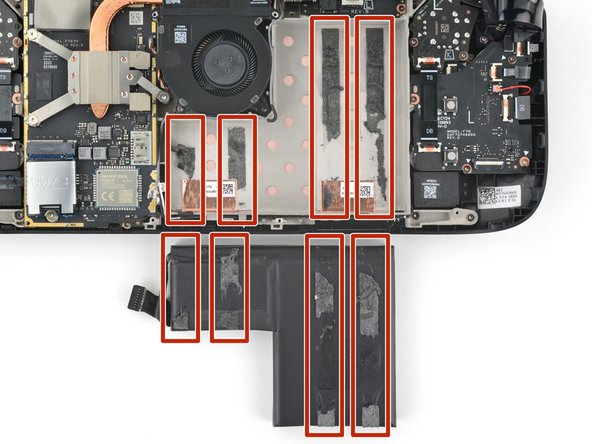

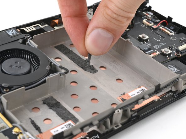

  18. Steam Deck OLED Battery Replacement, Battery adhesive information: crwdns2935265:018crwdnd2935265:01crwdnd2935265:02crwdne2935265:0 Steam Deck OLED Battery Replacement, Battery adhesive information: crwdns2935265:018crwdnd2935265:02crwdnd2935265:02crwdne2935265:0
    • Four long strips of strong adhesive secure the battery to the midframe. Use this picture as a reference as you slice through the adhesive in the remaining steps.

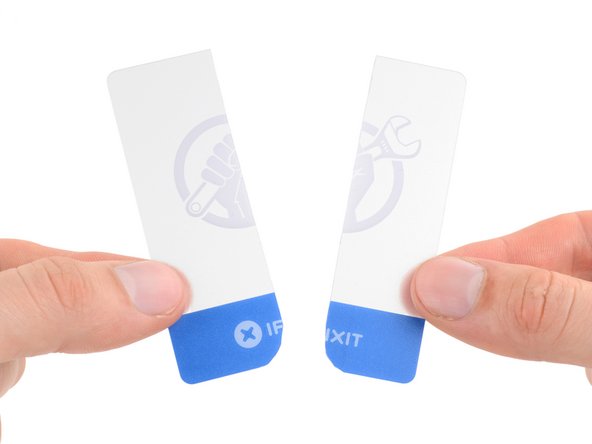

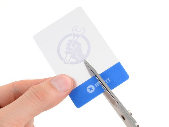

  19. Steam Deck OLED Battery Replacement, Cut a plastic card: crwdns2935265:019crwdnd2935265:01crwdnd2935265:03crwdne2935265:0 Steam Deck OLED Battery Replacement, Cut a plastic card: crwdns2935265:019crwdnd2935265:02crwdnd2935265:03crwdne2935265:0 Steam Deck OLED Battery Replacement, Cut a plastic card: crwdns2935265:019crwdnd2935265:03crwdnd2935265:03crwdne2935265:0
    Plastic Cards
    $2.99
    • You'll need two thin cards to fit through the slots in the midframe and slide under the battery.
    • Use scissors to cut a plastic card in half, longways.
    • It's okay if the two pieces of card aren't the same width—one of the slots in the midframe is wider than the other.
    • Cut the corners of the cards to be round, as sharp edges can scrape or puncture the battery, potentially causing a fire hazard.

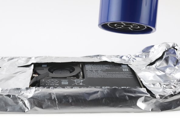

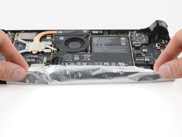

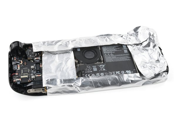

  20. Steam Deck OLED Battery Replacement, Protect the frame: crwdns2935265:020crwdnd2935265:01crwdnd2935265:03crwdne2935265:0 Steam Deck OLED Battery Replacement, Protect the frame: crwdns2935265:020crwdnd2935265:02crwdnd2935265:03crwdne2935265:0 Steam Deck OLED Battery Replacement, Protect the frame: crwdns2935265:020crwdnd2935265:03crwdnd2935265:03crwdne2935265:0
    • Wrap a layer of aluminum foil around the frame so that just the battery is exposed.
    • This is to protect the plastic frame from heat damage during the next step.
  21. Steam Deck OLED Battery Replacement: crwdns2935265:021crwdnd2935265:01crwdnd2935265:02crwdne2935265:0 Steam Deck OLED Battery Replacement: crwdns2935265:021crwdnd2935265:02crwdnd2935265:02crwdne2935265:0
    • Use a hair dryer or heat gun on a "low" setting to slowly heat the battery and soften the adhesive underneath.
    • Do not overheat the battery or surrounding components, including the soft plastic frame. Take your time and keep the battery warm for one to three minutes to allow the adhesive to soften.
    • Remove the aluminum foil.

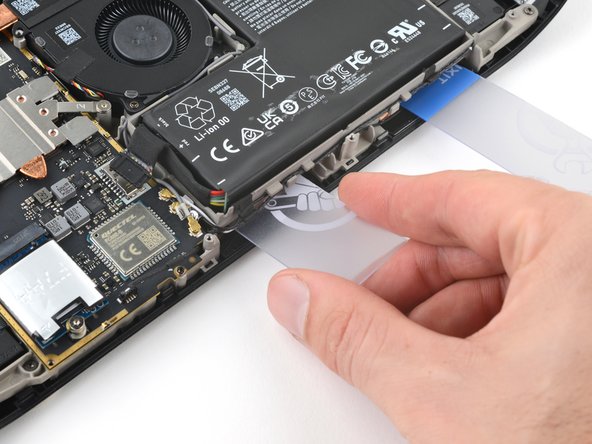

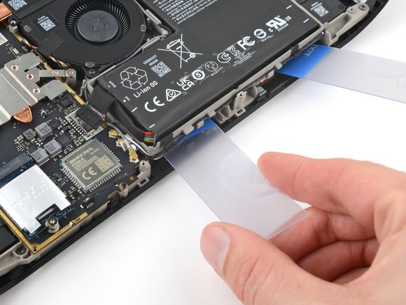

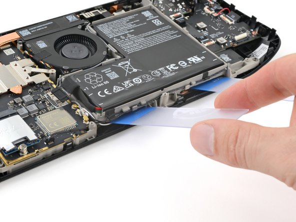

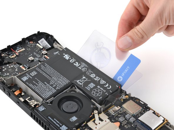

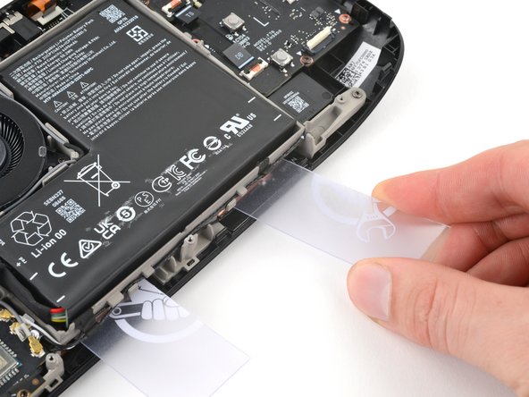

  22. Steam Deck OLED Battery Replacement, Insert the plastic cards: crwdns2935265:022crwdnd2935265:01crwdnd2935265:03crwdne2935265:0 Steam Deck OLED Battery Replacement, Insert the plastic cards: crwdns2935265:022crwdnd2935265:02crwdnd2935265:03crwdne2935265:0 Steam Deck OLED Battery Replacement, Insert the plastic cards: crwdns2935265:022crwdnd2935265:03crwdnd2935265:03crwdne2935265:0
    • Insert the tip of one of the plastic cards into the right slot in the midframe and under the battery.
    • If one of your cards is wider than the other, use it for this slot.
    • Insert the tip of the other card into the left slot in the midframe and under the battery.

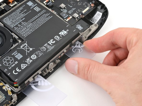

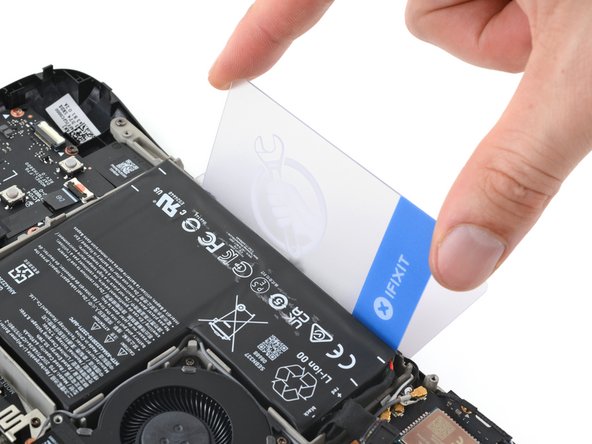

  23. Steam Deck OLED Battery Replacement, Slice the battery adhesive: crwdns2935265:023crwdnd2935265:01crwdnd2935265:03crwdne2935265:0 Steam Deck OLED Battery Replacement, Slice the battery adhesive: crwdns2935265:023crwdnd2935265:02crwdnd2935265:03crwdne2935265:0 Steam Deck OLED Battery Replacement, Slice the battery adhesive: crwdns2935265:023crwdnd2935265:03crwdnd2935265:03crwdne2935265:0
    • Inserting the cards under the battery takes significant force. Take your time and work carefully.
    • Grip the left card and slide it fully underneath the battery.
    • If the card becomes stuck, wiggle or rotate it to help slice the adhesive.
  24. Steam Deck OLED Battery Replacement: crwdns2935265:024crwdnd2935265:01crwdnd2935265:03crwdne2935265:0 Steam Deck OLED Battery Replacement: crwdns2935265:024crwdnd2935265:02crwdnd2935265:03crwdne2935265:0 Steam Deck OLED Battery Replacement: crwdns2935265:024crwdnd2935265:03crwdnd2935265:03crwdne2935265:0
    iFixit Adhesive Remover
    $19.99

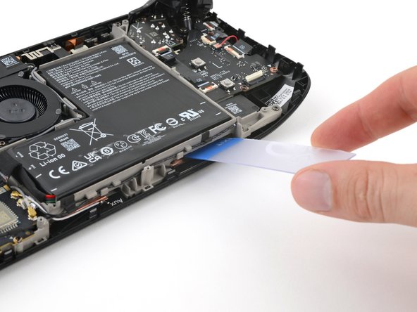

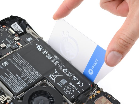

    • Grip the right card and fully insert it underneath the battery to separate the adhesive.
    • If you can't insert the card any farther, remove it and coat the tip with a single drop of highly-concentrated isopropyl alcohol (over 90%) or adhesive remover.
    • Don't use more than a single drop at a time, as excess liquid will damage the screen.

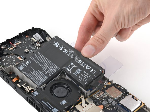

  25. Steam Deck OLED Battery Replacement, Pry up the battery: crwdns2935265:025crwdnd2935265:01crwdnd2935265:03crwdne2935265:0 Steam Deck OLED Battery Replacement, Pry up the battery: crwdns2935265:025crwdnd2935265:02crwdnd2935265:03crwdne2935265:0 Steam Deck OLED Battery Replacement, Pry up the battery: crwdns2935265:025crwdnd2935265:03crwdnd2935265:03crwdne2935265:0
    • Insert the flat edge of another, uncut plastic card between the bottom edge of the battery and the midframe.
    • Pry up the battery with a steady force to loosen the remaining adhesive along the bottom edge.
    • The bottom edge of the battery might not release right away. Keep a steady force on the plastic card for 30 seconds at a time before trying again.
  26. Steam Deck OLED Battery Replacement: crwdns2935265:026crwdnd2935265:01crwdnd2935265:03crwdne2935265:0 Steam Deck OLED Battery Replacement: crwdns2935265:026crwdnd2935265:02crwdnd2935265:03crwdne2935265:0 Steam Deck OLED Battery Replacement: crwdns2935265:026crwdnd2935265:03crwdnd2935265:03crwdne2935265:0
    • Pry up the battery until you can grab it with your fingers.
    • If the battery still feels stuck, twist and pry the two halves of the first plastic card to help separate the remaining adhesive.
    • Be careful not to pry up the larger section of the battery much farther than the smaller section, as the pouch may rip at the seam.

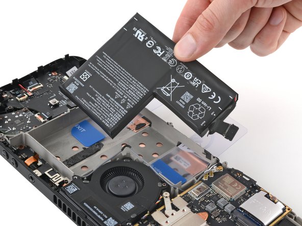

  27. Steam Deck OLED Battery Replacement, Remove the battery: crwdns2935265:027crwdnd2935265:01crwdnd2935265:02crwdne2935265:0 Steam Deck OLED Battery Replacement, Remove the battery: crwdns2935265:027crwdnd2935265:02crwdnd2935265:02crwdne2935265:0
    • Remove the battery.
  28. Steam Deck OLED Battery Replacement, Reassembly information: crwdns2935265:028crwdnd2935265:01crwdnd2935265:02crwdne2935265:0 Steam Deck OLED Battery Replacement, Reassembly information: crwdns2935265:028crwdnd2935265:02crwdnd2935265:02crwdne2935265:0
    • Don't reuse the battery after it's been removed, as doing so is a potential safety hazard. Replace it with a new battery.
    • To install a replacement battery:
    • Remove the old adhesive from the midframe by rolling chunks up with your fingers and peeling them off.
    • Dampen a microfiber or lint-free cloth with a few drops of isopropyl alcohol (over 90%) and wipe the midframe clean. Don't let any liquid drip through the circular cutouts in the battery recess.
    • Remove the protective liner from one side of each replacement adhesive strip. Apply each strip to the battery, using the old battery as reference for where it should go.
    • Press the new battery firmly into place.

More a question than a commentary : I'm replacing the battery because mine is not working, the deck turns off when not plugged in.
But I think the battery is full, with no way to drain it.
Is it dangerous to apply heat to a full battery? What are the alternatives?
AshEnke - crwdns2934203:0crwdne2934203:0 crwdns2950251:0crwdne2950251:0
I have the exact same problem. Battery is full and there's no way to drain it. Unplugging the charging simply turns the deck, off.
Hermann Tan - crwdns2950251:0crwdne2950251:0
Had the exact same problem and just did the swap. I did it with a hairdryer on low and was very careful with it. Did fix the problem with the deck turning off when not plugged in so if you want to take a shot I did work for me!
UnseenVerse - crwdns2950251:0crwdne2950251:0
I can answer my own quesdtion, I decided to try it with the heat and take extra care.
I managed to remove the adhesive and it wasn't too hard ! I don't know if the heat helped or not but the main difficulty was removing all the leftover adhesive once the battery was off. Prying the battery loose went quite well.
