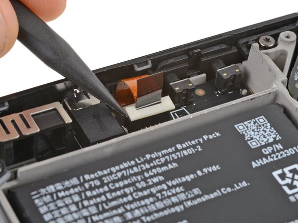

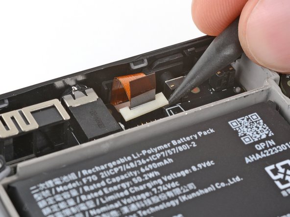

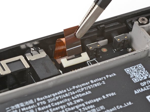

  11. Steam Deck OLED Audio Board Replacement, Unlock the audio board connector: crwdns2935265:011crwdnd2935265:01crwdnd2935265:03crwdne2935265:0 Steam Deck OLED Audio Board Replacement, Unlock the audio board connector: crwdns2935265:011crwdnd2935265:02crwdnd2935265:03crwdne2935265:0 Steam Deck OLED Audio Board Replacement, Unlock the audio board connector: crwdns2935265:011crwdnd2935265:03crwdnd2935265:03crwdne2935265:0
    • Use your fingers or a spudger to gently push on alternating sides of the white locking tab to lift it and release the cable.
    • Be careful not to bend the connector.
    • During reassembly, gently press down on the locking tab to secure the cable.

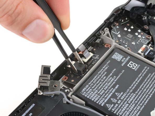

  12. Steam Deck OLED Audio Board Replacement, Disconnect the audio board: crwdns2935265:012crwdnd2935265:01crwdnd2935265:02crwdne2935265:0 Steam Deck OLED Audio Board Replacement, Disconnect the audio board: crwdns2935265:012crwdnd2935265:02crwdnd2935265:02crwdne2935265:0
    • Use tweezers or your fingers to pull the audio board cable out of its socket to disconnect it.
    • With the locking tab released, the cable will slide out with little to no resistance. If it doesn't, check that the white locking tab is fully released.
    • During reassembly, ensure that the locking tab is in its unlocked, lifted position before inserting the cable.

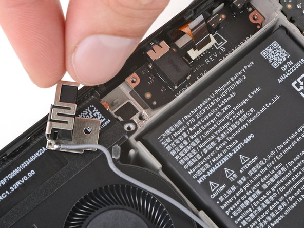

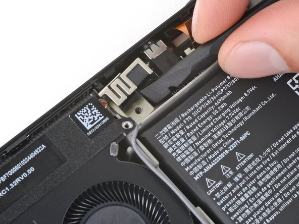

  14. Steam Deck OLED Audio Board Replacement, Move the antenna: crwdns2935265:014crwdnd2935265:01crwdnd2935265:03crwdne2935265:0 Steam Deck OLED Audio Board Replacement, Move the antenna: crwdns2935265:014crwdnd2935265:02crwdnd2935265:03crwdne2935265:0 Steam Deck OLED Audio Board Replacement, Move the antenna: crwdns2935265:014crwdnd2935265:03crwdnd2935265:03crwdne2935265:0
    • Adhesive secures the metal bracket and antenna to the midframe, just to the left of the audio board.
    • Insert the flat end of a spudger between the right edge of the metal bracket and the midframe.
    • Pry up with a steady force to separate the bracket from the midframe.
    • Depending on the age of your device, this may take more or less force. If it feels stubborn, lightly heat it with a hair dryer or heat gun.
    • Grab the bracket and antenna and move them to the left, out of the way of the audio board.

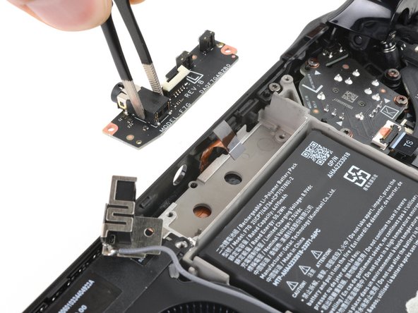

  15. Steam Deck OLED Audio Board Replacement, Remove the audio board: crwdns2935265:015crwdnd2935265:01crwdnd2935265:03crwdne2935265:0 Steam Deck OLED Audio Board Replacement, Remove the audio board: crwdns2935265:015crwdnd2935265:02crwdnd2935265:03crwdne2935265:0 Steam Deck OLED Audio Board Replacement, Remove the audio board: crwdns2935265:015crwdnd2935265:03crwdnd2935265:03crwdne2935265:0
    • Use tweezers or your fingers to grip the audio board by the headphone jack.
    • Pivot the audio board up and away from the edge of the frame.
    • Remove the audio board.
