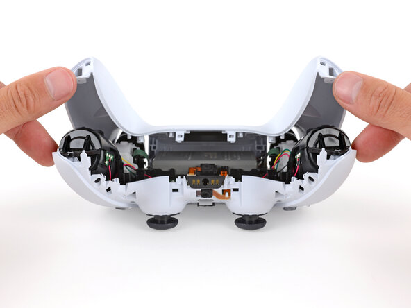

    6. Sony DualSense Controller Microphone Replacement: crwdns2935265:013crwdnd2935265:01crwdnd2935265:02crwdne2935265:0 Sony DualSense Controller Microphone Replacement: crwdns2935265:013crwdnd2935265:02crwdnd2935265:02crwdne2935265:0
      • Lay your controller upside down so the joysticks are on your work surface.
      • Hold the controller down with your fingers and use your thumbs to lift the rear case away from the controller to fully separate it.

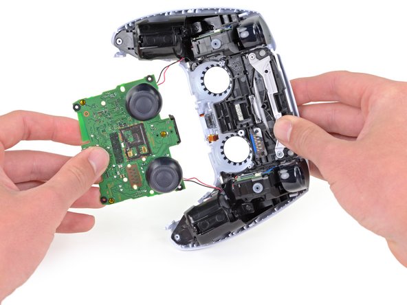

    10. Sony DualSense Controller Microphone Replacement, Lift out the motherboard: crwdns2935265:026crwdnd2935265:01crwdnd2935265:03crwdne2935265:0 Sony DualSense Controller Microphone Replacement, Lift out the motherboard: crwdns2935265:026crwdnd2935265:02crwdnd2935265:03crwdne2935265:0 Sony DualSense Controller Microphone Replacement, Lift out the motherboard: crwdns2935265:026crwdnd2935265:03crwdnd2935265:03crwdne2935265:0
      • Carefully guide the joysticks through the front case and lift the motherboard out.
      • The motherboard is held down by two clips. One between the motherboard itself and the right trigger assembly, and one between the motherboard itself and the left trigger assembly. Gently push on either clip to release the motherboard from its restraints.
      • Do not completely remove the motherboard. There are four soldered wires tethering the motherboard to the vibrator motors.
