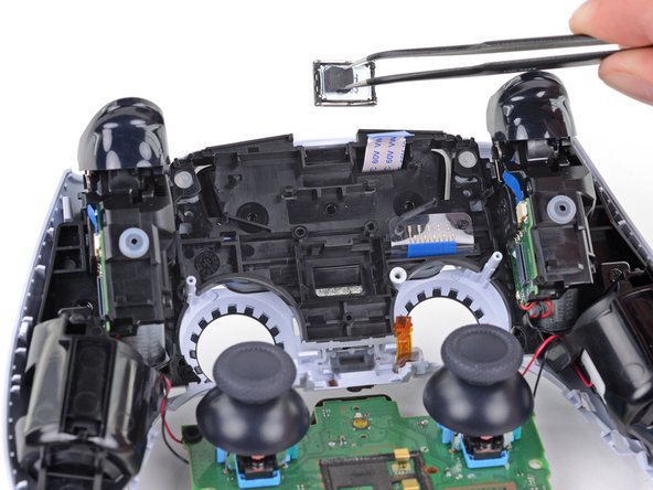

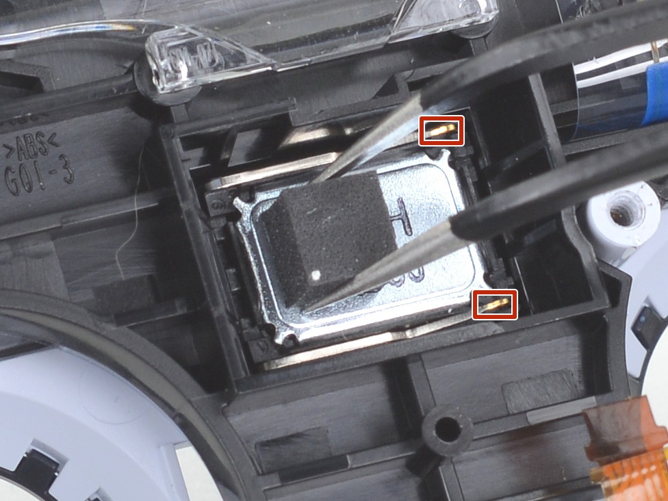

    1. Sony DualSense Controller Buttons Replacement, Remove the speaker: crwdns2935265:030crwdnd2935265:01crwdnd2935265:03crwdne2935265:0 Sony DualSense Controller Buttons Replacement, Remove the speaker: crwdns2935265:030crwdnd2935265:02crwdnd2935265:03crwdne2935265:0 Sony DualSense Controller Buttons Replacement, Remove the speaker: crwdns2935265:030crwdnd2935265:03crwdnd2935265:03crwdne2935265:0
      • Use a pair of tweezers to remove the speaker from the midframe.
      • Be sure to reinstall the speaker in the correct orientation with the foam pad on the left side and the gold contact points on the right.
    2. Sony DualSense Controller Buttons Replacement, Remove the midframe: crwdns2935265:031crwdnd2935265:01crwdnd2935265:02crwdne2935265:0 Sony DualSense Controller Buttons Replacement, Remove the midframe: crwdns2935265:031crwdnd2935265:02crwdnd2935265:02crwdne2935265:0
      • Use a Phillips screwdriver to remove the two 6.4 mm screws securing the midframe to the front case.
    3. Sony DualSense Controller Buttons Replacement: crwdns2935265:032crwdnd2935265:01crwdnd2935265:03crwdne2935265:0 Sony DualSense Controller Buttons Replacement: crwdns2935265:032crwdnd2935265:02crwdnd2935265:03crwdne2935265:0 Sony DualSense Controller Buttons Replacement: crwdns2935265:032crwdnd2935265:03crwdnd2935265:03crwdne2935265:0
      • Carefully lift the midframe and motherboard up and out of the front case.
      • Be careful not to strain the vibrator motor wires.
      • During reassembly, feed the touchpad's ribbon cable back through its rectangular opening in the midframe.
