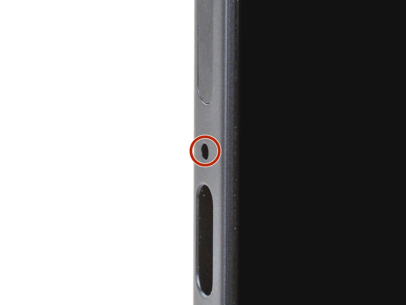

  2. Samsung Galaxy S25 Edge Sub Board Replacement, Remove the SIM card tray: crwdns2935265:02crwdnd2935265:01crwdnd2935265:03crwdne2935265:0 Samsung Galaxy S25 Edge Sub Board Replacement, Remove the SIM card tray: crwdns2935265:02crwdnd2935265:02crwdnd2935265:03crwdne2935265:0 Samsung Galaxy S25 Edge Sub Board Replacement, Remove the SIM card tray: crwdns2935265:02crwdnd2935265:03crwdnd2935265:03crwdne2935265:0
    iFixit Precision 4 mm Screwdriver Bit
    $2.99
    • Insert a SIM eject tool, SIM eject bit, or straightened paperclip into the SIM card tray hole on the bottom edge of your phone.
    • A small mic hole is next to the SIM tray—don't confuse the two!
    • Firmly press the SIM eject tool into the hole to eject the SIM card tray.
    • Remove the SIM card tray.
    • When reinserting the tray, make sure the hole is on the left side before firmly pushing the tray into place.

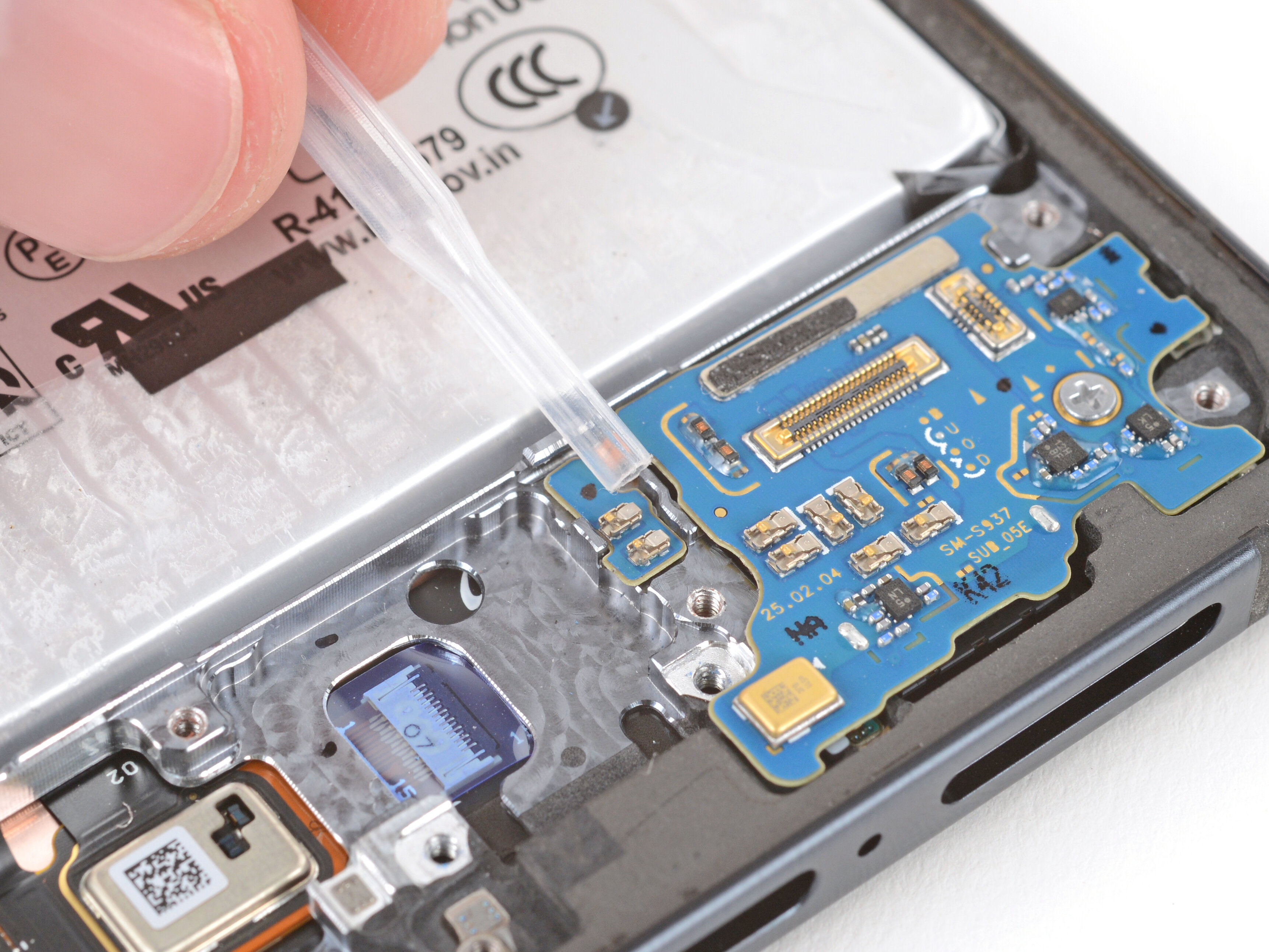

  25. Samsung Galaxy S25 Edge Sub Board Replacement, Pry up the sub board: crwdns2935265:025crwdnd2935265:01crwdnd2935265:02crwdne2935265:0 Samsung Galaxy S25 Edge Sub Board Replacement, Pry up the sub board: crwdns2935265:025crwdnd2935265:02crwdnd2935265:02crwdne2935265:0
    • Use the point of a spudger to gently pry up the small extension board near the top left corner of the sub board.
    • If you're having trouble, lightly heat the board with an iOpener, hair dryer, or heat gun. Alternatively, you can apply one drop of high‑concentration (>90%) isopropyl alcohol under the board to soften its adhesive.
  26. Samsung Galaxy S25 Edge Sub Board Replacement, Remove the sub board screw: crwdns2935265:026crwdnd2935265:01crwdnd2935265:02crwdne2935265:0 Samsung Galaxy S25 Edge Sub Board Replacement, Remove the sub board screw: crwdns2935265:026crwdnd2935265:02crwdnd2935265:02crwdne2935265:0
    • Use a Phillips screwdriver to remove the 2.3 mm‑long screw securing the sub board.
  27. Samsung Galaxy S25 Edge Sub Board Replacement, Remove the sub board: crwdns2935265:027crwdnd2935265:01crwdnd2935265:03crwdne2935265:0 Samsung Galaxy S25 Edge Sub Board Replacement, Remove the sub board: crwdns2935265:027crwdnd2935265:02crwdnd2935265:03crwdne2935265:0 Samsung Galaxy S25 Edge Sub Board Replacement, Remove the sub board: crwdns2935265:027crwdnd2935265:03crwdnd2935265:03crwdne2935265:0
    • Before trying to pry up the sub board, make sure you removed the SIM card tray.
    • Use the point of a spudger to pry up and unclip the sub board by the notch on its right edge.
    • Grip the board by its edges and remove it.
