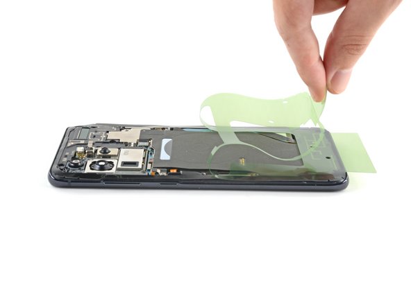

    2. How to Replace the Back Cover Adhesive (Frame First): crwdns2935265:02crwdnd2935265:01crwdnd2935265:01crwdne2935265:0
      • Before removing any liners, position the adhesive strip with the clear liner facing down over the frame to find the proper orientation.
      • You can use the rear camera cutout as a reference point.
      • If the adhesive matches the back cover instead of the frame, follow this cover-first adhesive guide.
    3. How to Replace the Back Cover Adhesive (Frame First), Expose the adhesive: crwdns2935265:03crwdnd2935265:01crwdnd2935265:02crwdne2935265:0 How to Replace the Back Cover Adhesive (Frame First), Expose the adhesive: crwdns2935265:03crwdnd2935265:02crwdnd2935265:02crwdne2935265:0
      • Peel the clear liner off of the adhesive strip to expose the adhesive.
    4. How to Replace the Back Cover Adhesive (Frame First), Align the adhesive: crwdns2935265:04crwdnd2935265:01crwdnd2935265:03crwdne2935265:0 How to Replace the Back Cover Adhesive (Frame First), Align the adhesive: crwdns2935265:04crwdnd2935265:02crwdnd2935265:03crwdne2935265:0 How to Replace the Back Cover Adhesive (Frame First), Align the adhesive: crwdns2935265:04crwdnd2935265:03crwdnd2935265:03crwdne2935265:0
      • Be very careful with this step, as misaligning the adhesive can cause it to peek out of the phone during reassembly, leading to an improper seal.
      • The adhesive is very sticky! Be careful with alignment, as you won't be able to reposition the adhesive once it sticks.
      • Carefully align the sticky side of the adhesive over the edges of the frame.
      • You can use the screw holes to help line up the adhesive.
      • Press down on the perimeter of the adhesive strip to bond it to the frame.
