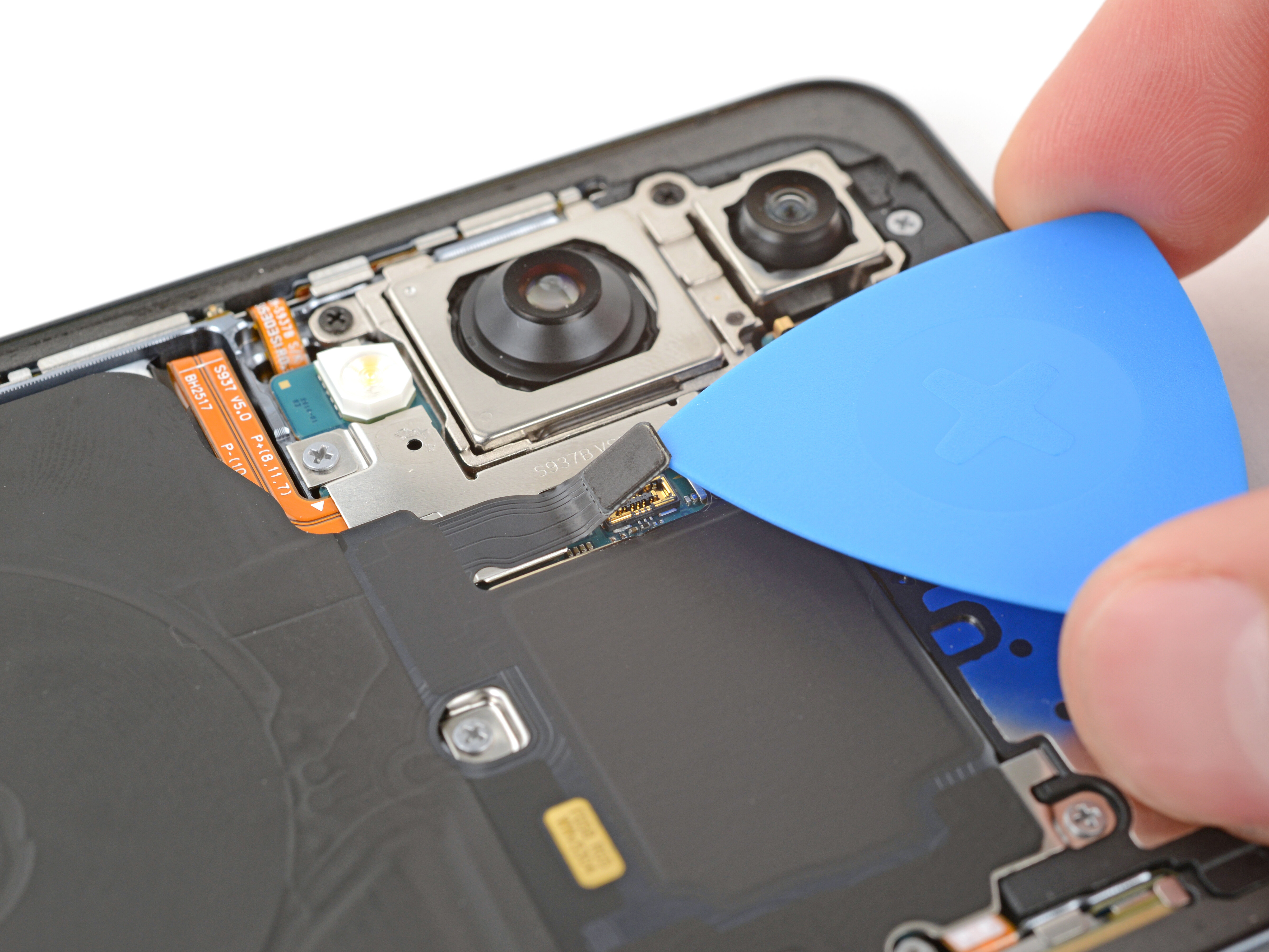

  9. Samsung Galaxy S25 Edge Logic Board Replacement, Disconnect the wireless charging assembly: crwdns2935265:09crwdnd2935265:01crwdnd2935265:02crwdne2935265:0 Samsung Galaxy S25 Edge Logic Board Replacement, Disconnect the wireless charging assembly: crwdns2935265:09crwdnd2935265:02crwdnd2935265:02crwdne2935265:0
    • Use the point of a spudger to pry up and disconnect the wireless charging assembly press connector from its top edge.
    • Getting the spudger under the connector can be tricky. If you're having trouble, try using the tip of an opening pick instead.

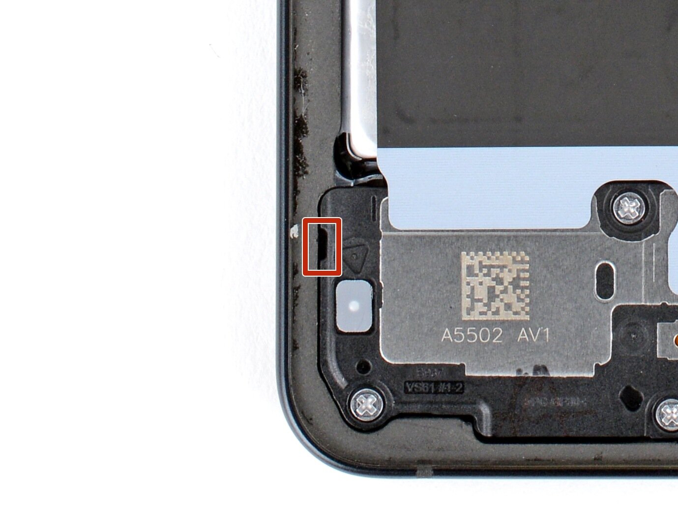

  11. Samsung Galaxy S25 Edge Logic Board Replacement, Pry up the loudspeaker: crwdns2935265:011crwdnd2935265:01crwdnd2935265:03crwdne2935265:0 Samsung Galaxy S25 Edge Logic Board Replacement, Pry up the loudspeaker: crwdns2935265:011crwdnd2935265:02crwdnd2935265:03crwdne2935265:0 Samsung Galaxy S25 Edge Logic Board Replacement, Pry up the loudspeaker: crwdns2935265:011crwdnd2935265:03crwdnd2935265:03crwdne2935265:0
    • The wireless charging coil is connected to the loudspeaker with delicate tape. It's easiest to remove the coil and loudspeaker together as one assembly to avoid damage.
    • Use angled tweezers to pry up and unclip the loudspeaker by the notch on its left edge.
    • During reassembly, press down firmly around the perimeter of the loudspeaker to engage its clips.

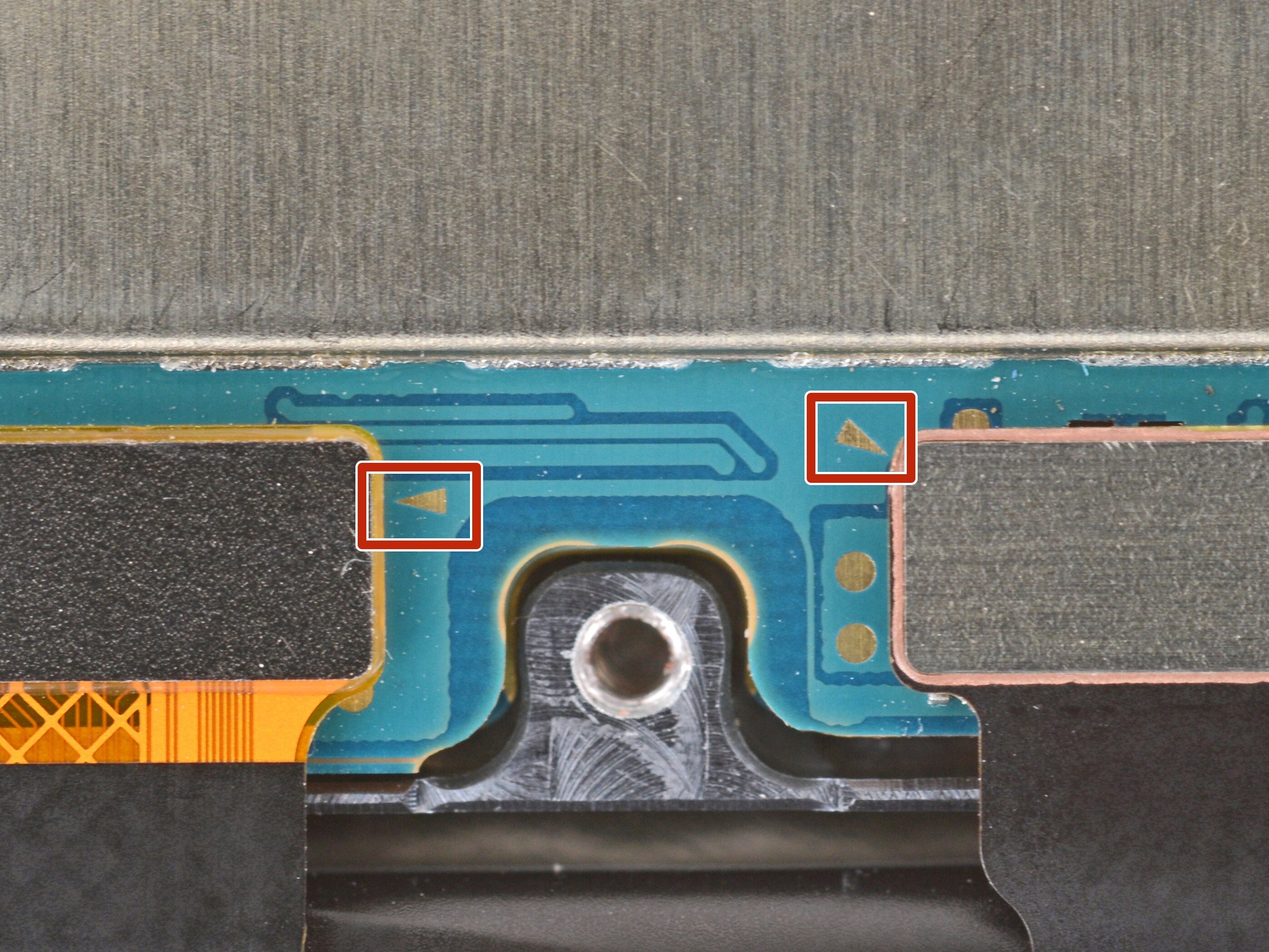

  13. Samsung Galaxy S25 Edge Logic Board Replacement, Disconnect the battery: crwdns2935265:013crwdnd2935265:01crwdnd2935265:02crwdne2935265:0 Samsung Galaxy S25 Edge Logic Board Replacement, Disconnect the battery: crwdns2935265:013crwdnd2935265:02crwdnd2935265:02crwdne2935265:0
    • Every press connector has a corresponding gold arrow on the board that shows the proper location to pry—nifty! Prying at the wrong location risks damaging the fragile surface‑mounted components on the board.
    • Use the point of a spudger to pry up and disconnect the battery press connector.
