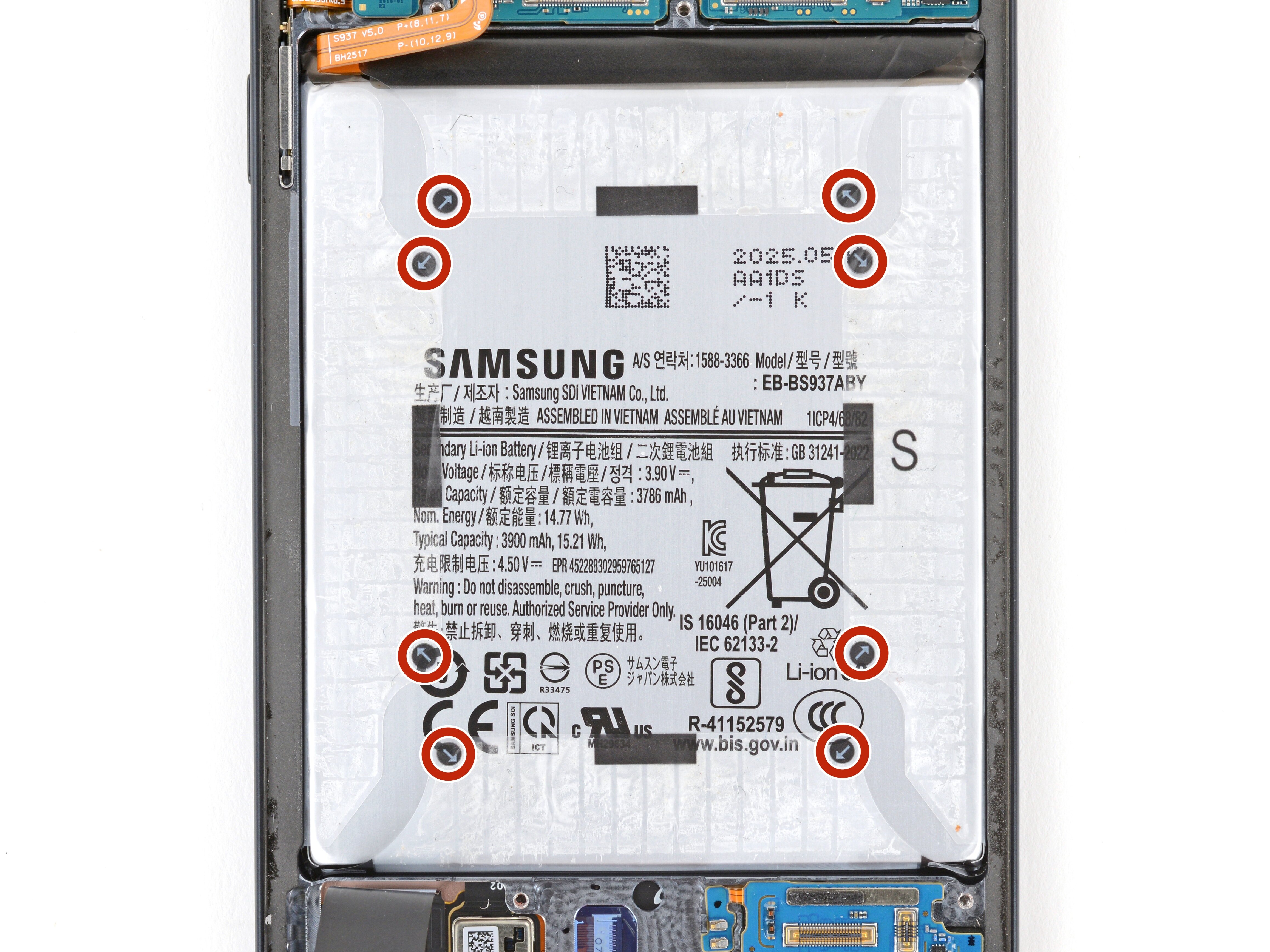

  26. Samsung Galaxy S25 Edge Battery Replacement, Peel up the plastic battery tabs: crwdns2935265:026crwdnd2935265:01crwdnd2935265:03crwdne2935265:0 Samsung Galaxy S25 Edge Battery Replacement, Peel up the plastic battery tabs: crwdns2935265:026crwdnd2935265:02crwdnd2935265:03crwdne2935265:0 Samsung Galaxy S25 Edge Battery Replacement, Peel up the plastic battery tabs: crwdns2935265:026crwdnd2935265:03crwdnd2935265:03crwdne2935265:0
    • Be very careful not to puncture or dent the battery, as it can leak dangerous chemicals or catch fire. Don’t use sharp or metal tools.
    • Use your fingers to peel the four plastic tabs completely off the edges of the battery, starting at the black, circular arrow markings.
    • If you're having trouble, use the tip of an opening pick to gently lift the tab until you can grip it with your fingers.
  27. Samsung Galaxy S25 Edge Battery Replacement, Remove the battery: crwdns2935265:027crwdnd2935265:01crwdnd2935265:02crwdne2935265:0 Samsung Galaxy S25 Edge Battery Replacement, Remove the battery: crwdns2935265:027crwdnd2935265:02crwdnd2935265:02crwdne2935265:0
    • Use your fingers to remove the battery.
    • If the battery feels stuck, don't try to force it out. Check that all the plastic tabs are fully out of the way. When they're all unstuck, the battery will lift away effortlessly.
