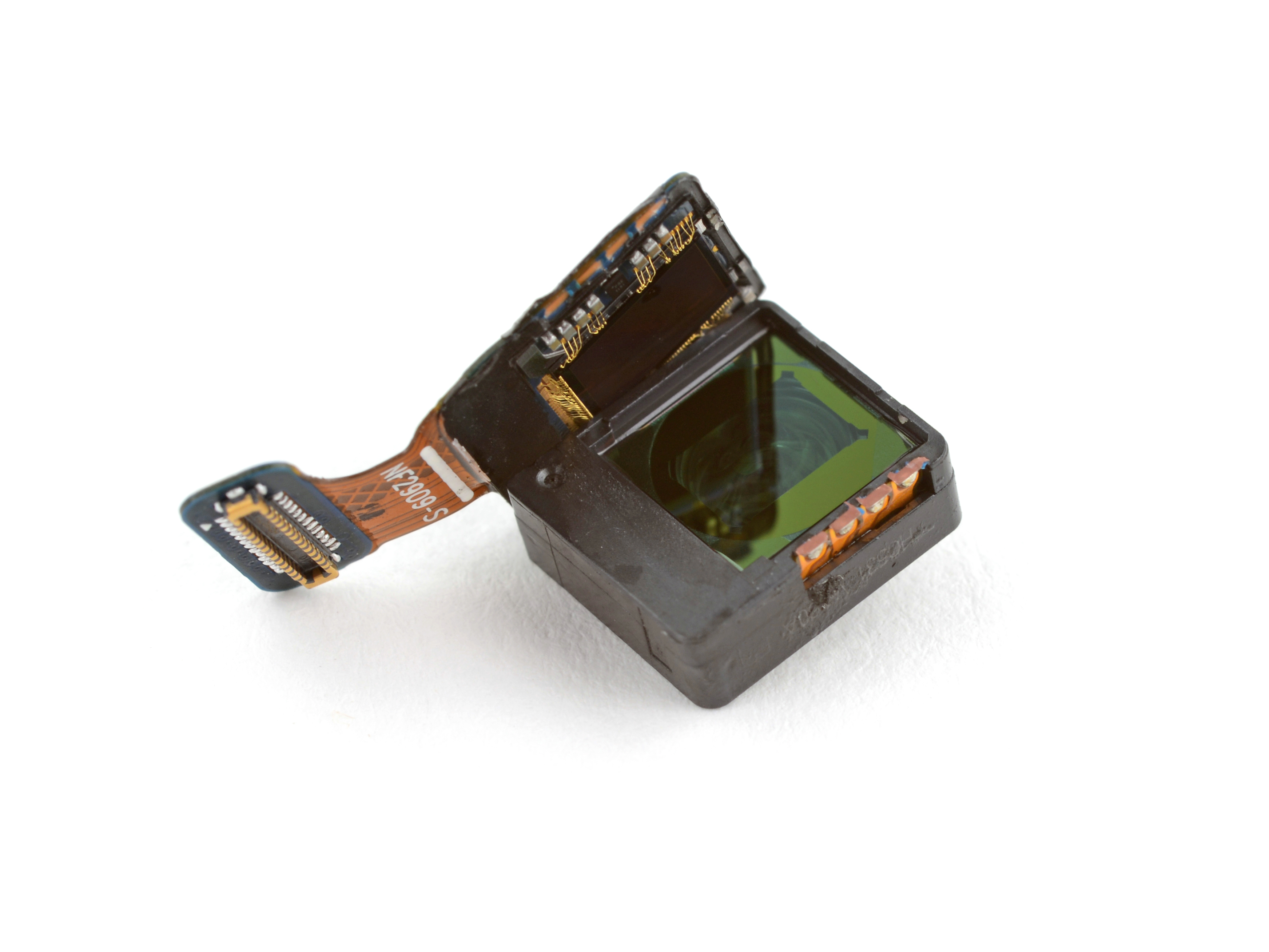

  47. Samsung Galaxy S24 Ultra Screen and Battery Assembly Replacement, Remove the front camera: crwdns2935265:047crwdnd2935265:01crwdnd2935265:01crwdne2935265:0
    • Flip over the phone so the screen is facing up.
    • Heat an iOpener and apply it to the top edge of the screen for two minutes to loosen the front camera adhesive.
    • You may alternatively use a hair dryer, heat gun, or hot plate, but be careful not to overheat the phone—the display and internal battery are susceptible to heat damage.
    • Flip the phone back over so the back of the front camera is accessible.
  48. Samsung Galaxy S24 Ultra Screen and Battery Assembly Replacement: crwdns2935265:048crwdnd2935265:01crwdnd2935265:03crwdne2935265:0 Samsung Galaxy S24 Ultra Screen and Battery Assembly Replacement: crwdns2935265:048crwdnd2935265:02crwdnd2935265:03crwdne2935265:0 Samsung Galaxy S24 Ultra Screen and Battery Assembly Replacement: crwdns2935265:048crwdnd2935265:03crwdnd2935265:03crwdne2935265:0
    • The adhesive securing the camera is very strong. Work slowly and apply more heat if the front camera feels stuck. Avoid separating the sensor from the lens, such as this.
    • Use the flat end of a spudger to pry the front camera from its recess in the frame.
    • If the camera doesn't loosen, use a SIM eject tool to scrape away the epoxy surrounding the camera.
    • Lift and remove the front camera.
