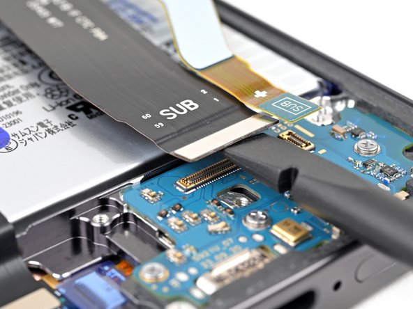

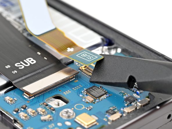

  21. Samsung Galaxy S24 USB-C Port and Daughterboard Replacement, Remove the interconnect cables: crwdns2935265:021crwdnd2935265:01crwdnd2935265:02crwdne2935265:0 Samsung Galaxy S24 USB-C Port and Daughterboard Replacement, Remove the interconnect cables: crwdns2935265:021crwdnd2935265:02crwdnd2935265:02crwdne2935265:0
    • Insert the flat end of a spudger under the secondary interconnect cable press connector labeled "SUB" and pry up to disconnect it.

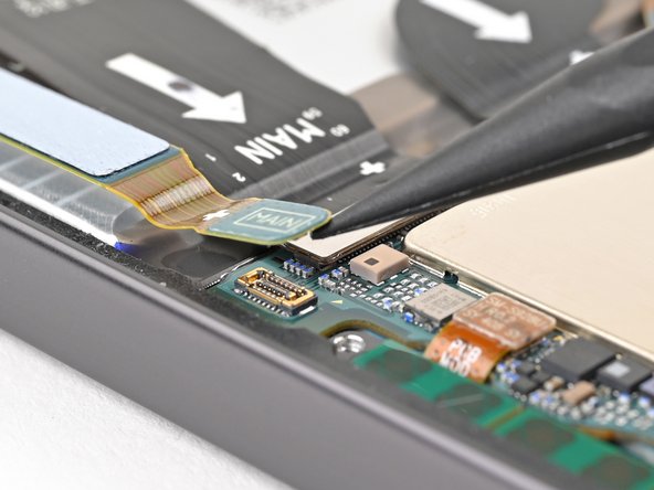

  22. Samsung Galaxy S24 USB-C Port and Daughterboard Replacement: crwdns2935265:022crwdnd2935265:01crwdnd2935265:02crwdne2935265:0 Samsung Galaxy S24 USB-C Port and Daughterboard Replacement: crwdns2935265:022crwdnd2935265:02crwdnd2935265:02crwdne2935265:0
    • Repeat for the primary interconnect cable connector, also labeled "SUB."

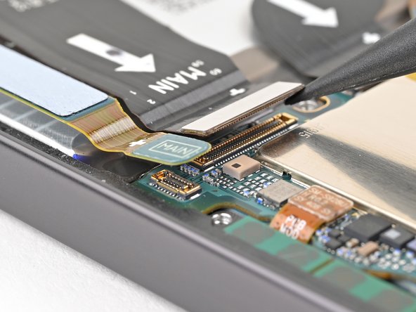

  23. Samsung Galaxy S24 USB-C Port and Daughterboard Replacement: crwdns2935265:023crwdnd2935265:01crwdnd2935265:03crwdne2935265:0 Samsung Galaxy S24 USB-C Port and Daughterboard Replacement: crwdns2935265:023crwdnd2935265:02crwdnd2935265:03crwdne2935265:0 Samsung Galaxy S24 USB-C Port and Daughterboard Replacement: crwdns2935265:023crwdnd2935265:03crwdnd2935265:03crwdne2935265:0
    • Repeat the previous step for the primary and secondary interconnect cable connectors on the motherboard.

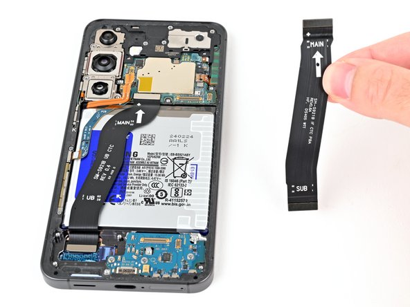

  24. Samsung Galaxy S24 USB-C Port and Daughterboard Replacement: crwdns2935265:024crwdnd2935265:01crwdnd2935265:02crwdne2935265:0 Samsung Galaxy S24 USB-C Port and Daughterboard Replacement: crwdns2935265:024crwdnd2935265:02crwdnd2935265:02crwdne2935265:0
    • Remove the primary and secondary interconnect cables from your phone.

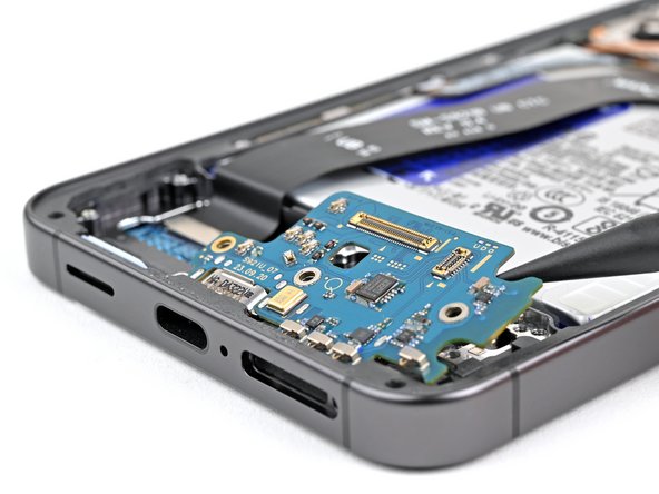

  25. Samsung Galaxy S24 USB-C Port and Daughterboard Replacement, Remove the daughterboard screws: crwdns2935265:025crwdnd2935265:01crwdnd2935265:01crwdne2935265:0
    • Use a Phillips screwdriver to remove the three 3.4 mm‑long screws securing the USB-C port and daughterboard.

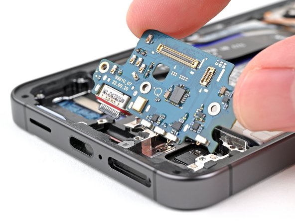

  26. Samsung Galaxy S24 USB-C Port and Daughterboard Replacement, Remove the USB-C port and daughterboard: crwdns2935265:026crwdnd2935265:01crwdnd2935265:03crwdne2935265:0 Samsung Galaxy S24 USB-C Port and Daughterboard Replacement, Remove the USB-C port and daughterboard: crwdns2935265:026crwdnd2935265:02crwdnd2935265:03crwdne2935265:0 Samsung Galaxy S24 USB-C Port and Daughterboard Replacement, Remove the USB-C port and daughterboard: crwdns2935265:026crwdnd2935265:03crwdnd2935265:03crwdne2935265:0
    • Insert the point of a spudger underneath the top right corner of the daughterboard and lift it up enough to grab it with your fingers.
    • Don't pry against the battery! Angle your spudger so you pry against the frame, if needed.
    • Remove the USB-C port and daughterboard from your phone.
    • During reassembly, reinsert the USB-C port into its recess at an angle before pressing the daughterboard flat onto the frame.
