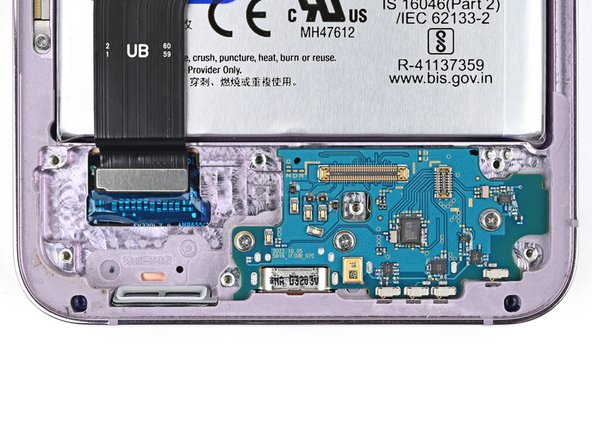

  22. Samsung Galaxy S23 Plus USB-C Port and Daughterboard Replacement, Disconnect the interconnect cables: crwdns2935265:022crwdnd2935265:01crwdnd2935265:03crwdne2935265:0 Samsung Galaxy S23 Plus USB-C Port and Daughterboard Replacement, Disconnect the interconnect cables: crwdns2935265:022crwdnd2935265:02crwdnd2935265:03crwdne2935265:0 Samsung Galaxy S23 Plus USB-C Port and Daughterboard Replacement, Disconnect the interconnect cables: crwdns2935265:022crwdnd2935265:03crwdnd2935265:03crwdne2935265:0
    • Use your spudger to pry up and disconnect the primary and secondary interconnect cable press connectors from the daughterboard.
  23. Samsung Galaxy S23 Plus USB-C Port and Daughterboard Replacement: crwdns2935265:023crwdnd2935265:01crwdnd2935265:03crwdne2935265:0 Samsung Galaxy S23 Plus USB-C Port and Daughterboard Replacement: crwdns2935265:023crwdnd2935265:02crwdnd2935265:03crwdne2935265:0 Samsung Galaxy S23 Plus USB-C Port and Daughterboard Replacement: crwdns2935265:023crwdnd2935265:03crwdnd2935265:03crwdne2935265:0
    • Repeat the previous step for the primary and secondary interconnect cable connectors on the motherboard.
  24. Samsung Galaxy S23 Plus USB-C Port and Daughterboard Replacement, Remove the interconnect cables: crwdns2935265:024crwdnd2935265:01crwdnd2935265:02crwdne2935265:0 Samsung Galaxy S23 Plus USB-C Port and Daughterboard Replacement, Remove the interconnect cables: crwdns2935265:024crwdnd2935265:02crwdnd2935265:02crwdne2935265:0
    • Remove the interconnect cables.

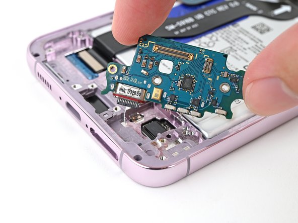

  25. Samsung Galaxy S23 Plus USB-C Port and Daughterboard Replacement, Remove the daughterboard screws: crwdns2935265:025crwdnd2935265:01crwdnd2935265:02crwdne2935265:0 Samsung Galaxy S23 Plus USB-C Port and Daughterboard Replacement, Remove the daughterboard screws: crwdns2935265:025crwdnd2935265:02crwdnd2935265:02crwdne2935265:0
    • Use a Phillips screwdriver to remove the three 3.5 mm‑long screws securing the daughterboard.

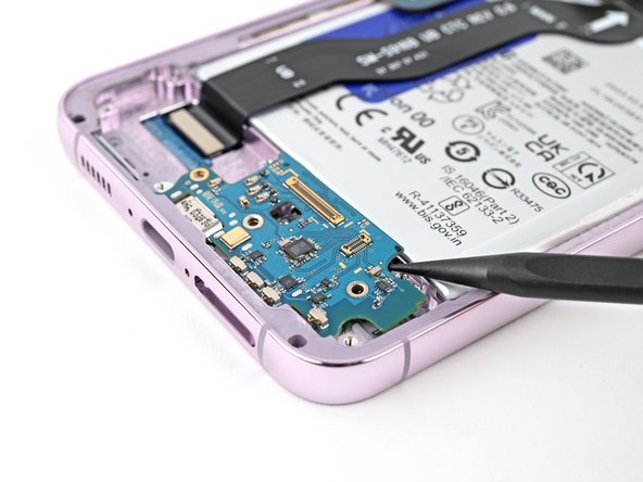

  26. Samsung Galaxy S23 Plus USB-C Port and Daughterboard Replacement, Remove the daughterboard: crwdns2935265:026crwdnd2935265:01crwdnd2935265:03crwdne2935265:0 Samsung Galaxy S23 Plus USB-C Port and Daughterboard Replacement, Remove the daughterboard: crwdns2935265:026crwdnd2935265:02crwdnd2935265:03crwdne2935265:0 Samsung Galaxy S23 Plus USB-C Port and Daughterboard Replacement, Remove the daughterboard: crwdns2935265:026crwdnd2935265:03crwdnd2935265:03crwdne2935265:0
    • Use the point of a spudger to pry up the top right corner of the daughterboard and unclip it from the frame.
    • Don't pry against the battery! Angle your spudger so you pry against the frame.
    • Remove the daughterboard.
    • During reassembly, reinsert the USB-C port into its recess at an angle before pressing the daughterboard flat onto the frame.
Compare your new replacement part to the original part—be sure to transfer remaining components and remove adhesive backings from the new part before installing.
