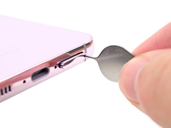

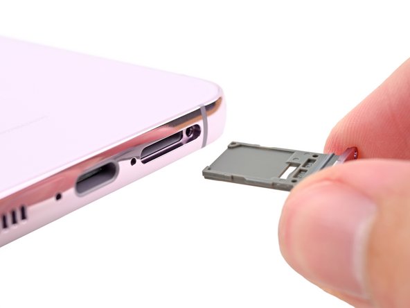

  2. Samsung Galaxy S23 Plus Screen and Battery Assembly Replacement, Remove the SIM card tray: crwdns2935265:02crwdnd2935265:01crwdnd2935265:03crwdne2935265:0 Samsung Galaxy S23 Plus Screen and Battery Assembly Replacement, Remove the SIM card tray: crwdns2935265:02crwdnd2935265:02crwdnd2935265:03crwdne2935265:0 Samsung Galaxy S23 Plus Screen and Battery Assembly Replacement, Remove the SIM card tray: crwdns2935265:02crwdnd2935265:03crwdnd2935265:03crwdne2935265:0
    • Insert a SIM eject tool, bit, or straightened paper clip into the SIM card tray hole on the bottom edge of the phone.
    • Press firmly to eject the tray.
    • Remove the SIM card tray.
    • If you accidentally inserted the SIM eject tool into a microphone hole, don't worry! You most likely didn't damage the microphone.

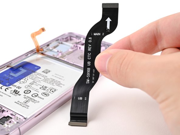

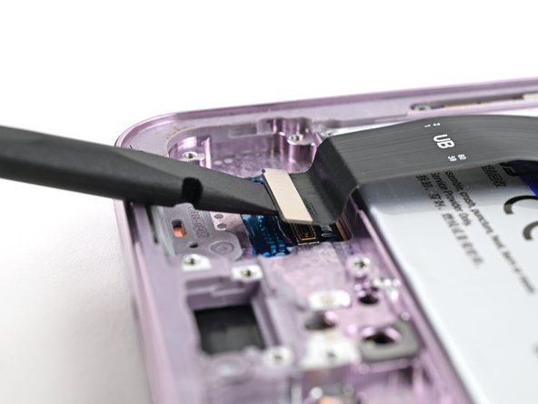

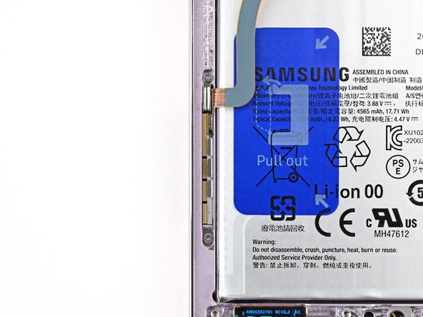

  26. Samsung Galaxy S23 Plus Screen and Battery Assembly Replacement, Disconnect the interconnect cables: crwdns2935265:026crwdnd2935265:01crwdnd2935265:03crwdne2935265:0 Samsung Galaxy S23 Plus Screen and Battery Assembly Replacement, Disconnect the interconnect cables: crwdns2935265:026crwdnd2935265:02crwdnd2935265:03crwdne2935265:0 Samsung Galaxy S23 Plus Screen and Battery Assembly Replacement, Disconnect the interconnect cables: crwdns2935265:026crwdnd2935265:03crwdnd2935265:03crwdne2935265:0
    • Use your spudger to pry up and disconnect the primary and secondary interconnect cable press connectors from the daughterboard.
  27. Samsung Galaxy S23 Plus Screen and Battery Assembly Replacement: crwdns2935265:027crwdnd2935265:01crwdnd2935265:03crwdne2935265:0 Samsung Galaxy S23 Plus Screen and Battery Assembly Replacement: crwdns2935265:027crwdnd2935265:02crwdnd2935265:03crwdne2935265:0 Samsung Galaxy S23 Plus Screen and Battery Assembly Replacement: crwdns2935265:027crwdnd2935265:03crwdnd2935265:03crwdne2935265:0
    • Repeat the previous step for the primary and secondary interconnect cable connectors on the motherboard.
  28. Samsung Galaxy S23 Plus Screen and Battery Assembly Replacement, Remove the interconnect cables: crwdns2935265:028crwdnd2935265:01crwdnd2935265:02crwdne2935265:0 Samsung Galaxy S23 Plus Screen and Battery Assembly Replacement, Remove the interconnect cables: crwdns2935265:028crwdnd2935265:02crwdnd2935265:02crwdne2935265:0
    • Remove the interconnect cables.

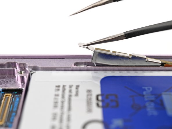

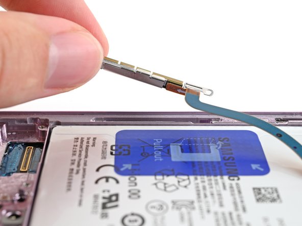

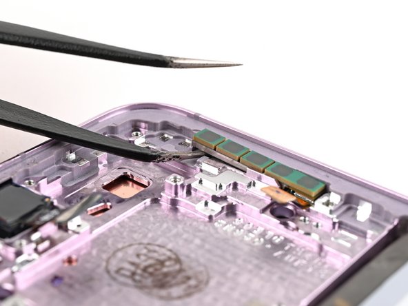

  36. Samsung Galaxy S23 Plus Screen and Battery Assembly Replacement, Remove the upper 5G mmWave antenna: crwdns2935265:036crwdnd2935265:01crwdnd2935265:02crwdne2935265:0 Samsung Galaxy S23 Plus Screen and Battery Assembly Replacement, Remove the upper 5G mmWave antenna: crwdns2935265:036crwdnd2935265:02crwdnd2935265:02crwdne2935265:0
    • Insert one arm of your angled tweezers in the notch between the top edge of the upper 5G mmWave antenna and the frame.

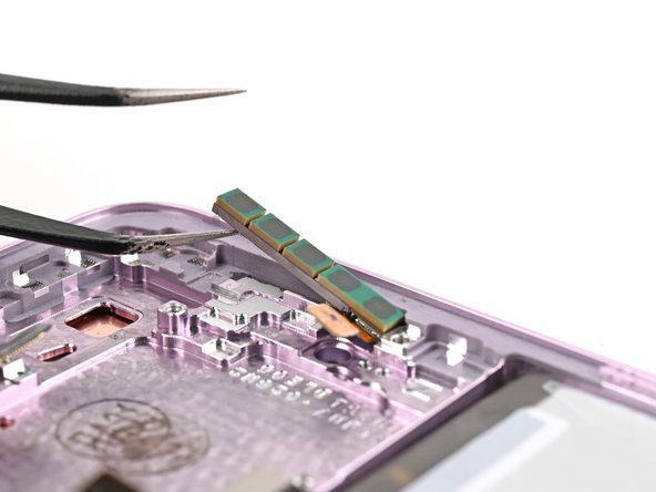

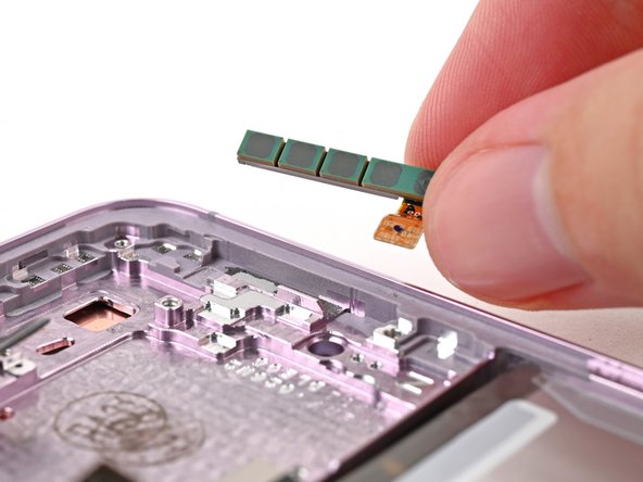

  37. Samsung Galaxy S23 Plus Screen and Battery Assembly Replacement: crwdns2935265:037crwdnd2935265:01crwdnd2935265:03crwdne2935265:0 Samsung Galaxy S23 Plus Screen and Battery Assembly Replacement: crwdns2935265:037crwdnd2935265:02crwdnd2935265:03crwdne2935265:0 Samsung Galaxy S23 Plus Screen and Battery Assembly Replacement: crwdns2935265:037crwdnd2935265:03crwdnd2935265:03crwdne2935265:0
    • Pry up and lift the antenna to separate the adhesive securing it.
    • Use your fingers to pull the antenna out of the frame, separating any remaining adhesive from it.
    • During reassembly, you may need to transfer the conductive tape under the antenna to your new part.

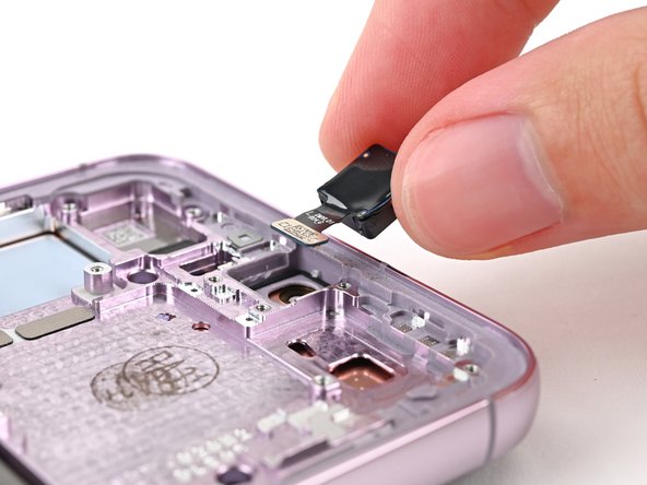

  38. Samsung Galaxy S23 Plus Screen and Battery Assembly Replacement, Soften the front camera adhesive: crwdns2935265:038crwdnd2935265:01crwdnd2935265:01crwdne2935265:0
    • The adhesive securing the camera is very strong. Work slowly and apply more heat if the front camera feels stuck. Avoid separating the circuit board from camera housing, such as this.
    • Use a hair dryer or a heat gun to heat the front camera for 90 seconds.
  39. Samsung Galaxy S23 Plus Screen and Battery Assembly Replacement, Remove the front camera: crwdns2935265:039crwdnd2935265:01crwdnd2935265:03crwdne2935265:0 Samsung Galaxy S23 Plus Screen and Battery Assembly Replacement, Remove the front camera: crwdns2935265:039crwdnd2935265:02crwdnd2935265:03crwdne2935265:0 Samsung Galaxy S23 Plus Screen and Battery Assembly Replacement, Remove the front camera: crwdns2935265:039crwdnd2935265:03crwdnd2935265:03crwdne2935265:0
    • Use the flat end of your spudger to pry the front camera from its recess in the frame.
    • If the camera doesn't loosen, use your SIM card eject tool to scrape away the epoxy surrounding the camera.
    • Remove the front camera.

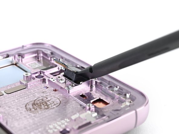

  40. Samsung Galaxy S23 Plus Screen and Battery Assembly Replacement, Remove the display cable: crwdns2935265:040crwdnd2935265:01crwdnd2935265:03crwdne2935265:0 Samsung Galaxy S23 Plus Screen and Battery Assembly Replacement, Remove the display cable: crwdns2935265:040crwdnd2935265:02crwdnd2935265:03crwdne2935265:0 Samsung Galaxy S23 Plus Screen and Battery Assembly Replacement, Remove the display cable: crwdns2935265:040crwdnd2935265:03crwdnd2935265:03crwdne2935265:0
    • Use the flat end of a spudger to pry up and disconnect the display cable press connector from the back of the screen.
    • Remove the display cable.

    • Use a Phillips screwdriver to remove the two 2.5 mm‑long screws securing the 5G mmWave antenna.
  42. Samsung Galaxy S23 Plus Screen and Battery Assembly Replacement, Remove the 5G mmWave antenna: crwdns2935265:042crwdnd2935265:01crwdnd2935265:02crwdne2935265:0 Samsung Galaxy S23 Plus Screen and Battery Assembly Replacement, Remove the 5G mmWave antenna: crwdns2935265:042crwdnd2935265:02crwdnd2935265:02crwdne2935265:0
    • Insert one arm of a pair of angled tweezers into the bottom screw hole on the 5G mmWave antenna bracket.
    • Pry up with the tweezers and lift the antenna bracket out of its recess enough until you can grip it with your fingers.
  43. Samsung Galaxy S23 Plus Screen and Battery Assembly Replacement: crwdns2935265:043crwdnd2935265:01crwdnd2935265:02crwdne2935265:0 Samsung Galaxy S23 Plus Screen and Battery Assembly Replacement: crwdns2935265:043crwdnd2935265:02crwdnd2935265:02crwdne2935265:0
    • Lift the 5G mmWave antenna out of its recess to separate the adhesive securing it.
    • Remove the 5G mmWave antenna.
