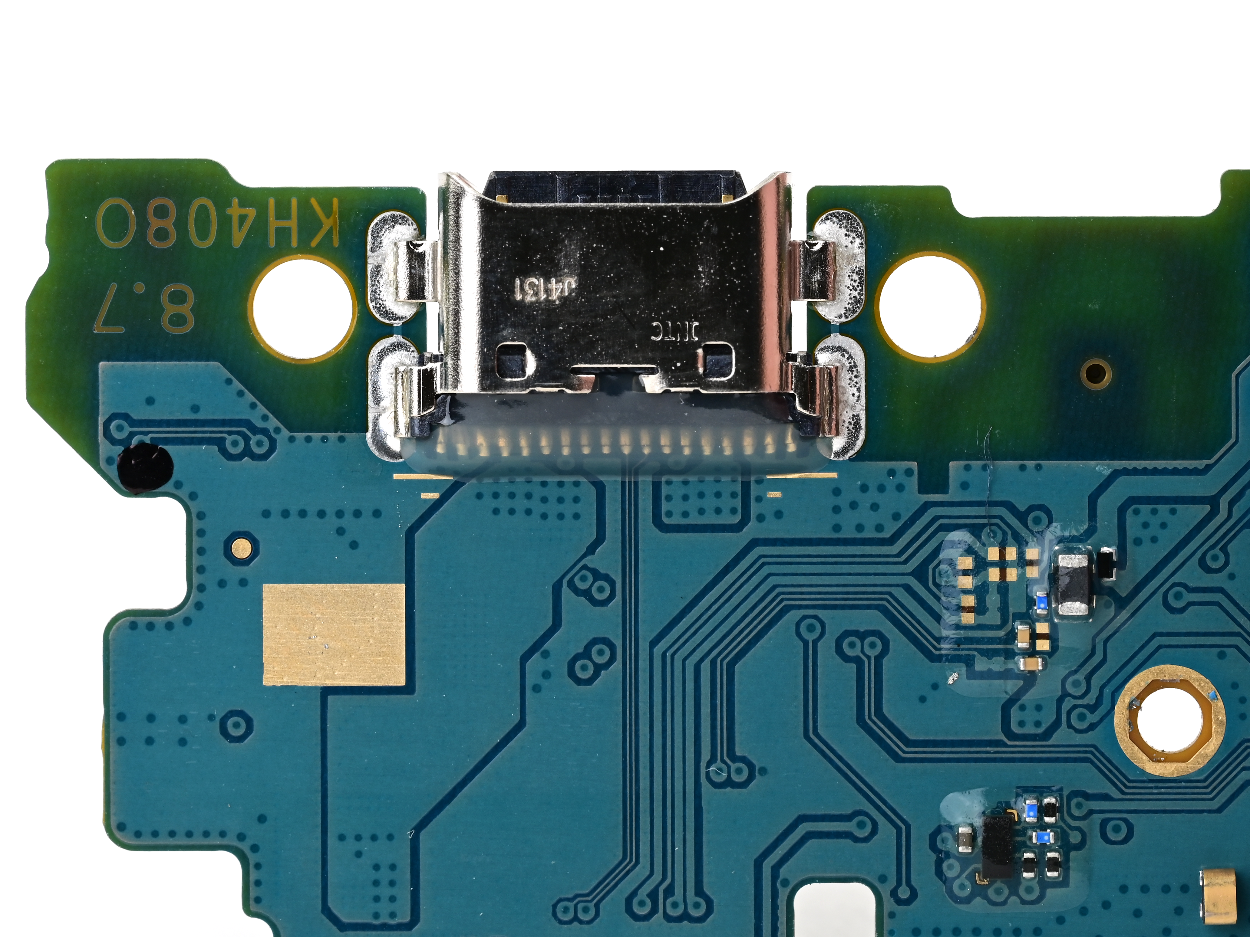

  28. Samsung Galaxy A15 USB-C Charging Port and Daughterboard Replacement, Remove the daughterboard screw: crwdns2935265:028crwdnd2935265:01crwdnd2935265:02crwdne2935265:0 Samsung Galaxy A15 USB-C Charging Port and Daughterboard Replacement, Remove the daughterboard screw: crwdns2935265:028crwdnd2935265:02crwdnd2935265:02crwdne2935265:0
    • Use a Phillips screwdriver to remove the 3 mm‑long screw securing the daughterboard to the phone.
  29. Samsung Galaxy A15 USB-C Charging Port and Daughterboard Replacement, Remove the daughterboard: crwdns2935265:029crwdnd2935265:01crwdnd2935265:02crwdne2935265:0 Samsung Galaxy A15 USB-C Charging Port and Daughterboard Replacement, Remove the daughterboard: crwdns2935265:029crwdnd2935265:02crwdnd2935265:02crwdne2935265:0
    • Grab the daughterboard by its edges and pull it up and out of the phone.
Compare your new replacement part to the original part—you may need to transfer remaining components or remove adhesive backings from the new part before you install it.

Could you post another picture from the daughterboard, showing the other side of it? I need to see if that usb-c port has just one or two rows of pads.
Rodolfo Ferreira - crwdns2934203:0crwdne2934203:0
Here you go! Let me know if you need additional photos.
