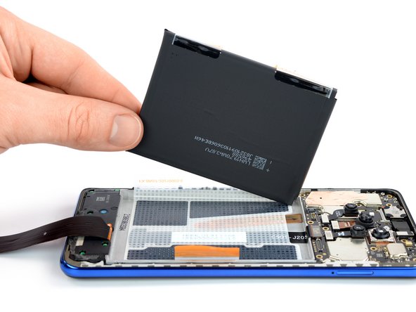

    3. Poco X3 Pro Screen Replacement, Peel off the battery pull-tabs: crwdns2935265:014crwdnd2935265:01crwdnd2935265:03crwdne2935265:0 Poco X3 Pro Screen Replacement, Peel off the battery pull-tabs: crwdns2935265:014crwdnd2935265:02crwdnd2935265:03crwdne2935265:0 Poco X3 Pro Screen Replacement, Peel off the battery pull-tabs: crwdns2935265:014crwdnd2935265:03crwdnd2935265:03crwdne2935265:0
      • Take care not to puncture or bend the battery with your tool—a punctured or bent battery may leak dangerous chemicals or cause a thermal event.
      • Use a pair of blunt nose tweezers or a clean fingernail to peel the orange adhesive strip labelled with an A off the battery.
      • Use a pair of blunt nose tweezers or a clean fingernail to peel the orange adhesive strip labelled with a B off the battery.
    4. Poco X3 Pro Screen Replacement, Remove the battery: crwdns2935265:015crwdnd2935265:01crwdnd2935265:03crwdne2935265:0 Poco X3 Pro Screen Replacement, Remove the battery: crwdns2935265:015crwdnd2935265:02crwdnd2935265:03crwdne2935265:0 Poco X3 Pro Screen Replacement, Remove the battery: crwdns2935265:015crwdnd2935265:03crwdnd2935265:03crwdne2935265:0
      • Grab both pull–tab ends labelled with an A and pull up on the orange adhesive strip to lift the battery out of its recess and swing it up to an upright position.
      • Although these adhesive tabs are supposed to make the battery removal easier, they may require some force. In case you're having trouble removing the battery, you can apply a heated iOpener to the center of the display to loosen the adhesive underneath.
      • Peel the battery off the remaining adhesive.
      • Remove the battery.
      • During reassembly, temporarily reconnect the battery to the motherboard to help align it correctly. Disconnect the battery after it is seated.
      • In case you're replacing the adhesive sticker with a new one, peel the battery's adhesive sticker off the midframe and clean the relevant areas with isopropyl alcohol (>90%). Let the alcohol dry before installing new adhesive.
